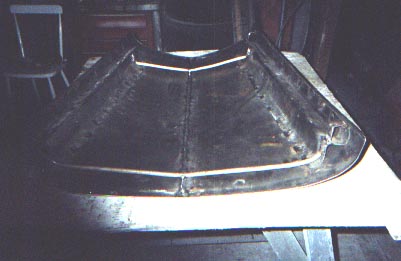

    So it's been a while since I have updated this project and a while since I have worked on it at all. The car was stashed away in a corner of our shed, put on blocks of wood, and covered with blankets, not knowing when the project would be resumed. I had the opertunity to do some work on an aquaintaces car and I needed the space. So after a summers worth of sheet metal repair I had aquired some much needed tools, knowledge, and experience necessary to complete my roadster project. Before I knew it the word got out and as soon as I was finished with the first car I was out picking up another one with plans to do a full restoration. For the past few months I've been dissasembling and bagging parts and pieces instead of getting anything done on my project.
    A few weeks ago I decided to take a break from my restoration project and push the roadster in the shop to see if I could make any progress. I haven't touched this car in over a year. I got frustrated with it after I got the engine running and the driveshaft shop kept dropping the ball. After a few run arounds with them I gave up on it. Like they say, sometimes you just have to walk away, if you really want it, you'll come back to it. Well, lately I've decided to get the body together so at least it looks like something and gives me some motivation. I started with the grill shell which is a late twenty's or early thirty's Chevy that I chopped all to hell to fit over the Mustang radiator. Needless to say about ten hours later I had a part that actually fit and looked finished. I then decided to build the lip of the cowl where the hood will rest, I have no idea what you would call this area. Once I finished these two parts I moved on to the hood and sides. After some trouble making the hood template, I cut it out of aluminum and proceeded to shape it to the body. his proved harder than I thought and though it fits, I'm going to have to make another one. From there I moved on to the hood sides, which turned out very nice. I'll let the pictures do the talking.
    This was the only way I could figure to make a template. Luckily the car is symetrical and I just taped up half of the opening and flipped it while tracing for the template.
    A paper hood, I wish it was this easy.
    Finished template, ready for tracing.
    One hood, minus the curves.
    I had a lot of problems trying to shape this aluminum basically because I got the wrong type. I bought 5052 instead of 3003 because I was afraid it was too thin. I ended up anealing this which would have worked, but I only have a cutting tip on the torch, which is too concentrated for a sheet this big and it warped it. Good practice I guess.
    So since my hood lined up well to the marks I set for it, I decided I could make the sides and make another hood later. I screwed up the first one with a crooked flange, but I got it on the second time. Even though the hood is sub par it still looks good.
    Then I moved to the driver's side and again the template fit almost perfectly just reversed. This side was a little more difficult because I had to figure out how to get around the pitman arm. You can see the first mess up in the back ground.
    Success on the first time with this side, you can see where the arm cantacts the panel.
    This is my solution marked out.
    With a little grinding I had clearance, now I had to do something about the hole.

    I hammered out this clam shell looking detent to fill the hole. It's not perfect, but that's not what this car is about anyway.
    Riveted in place and looking good.

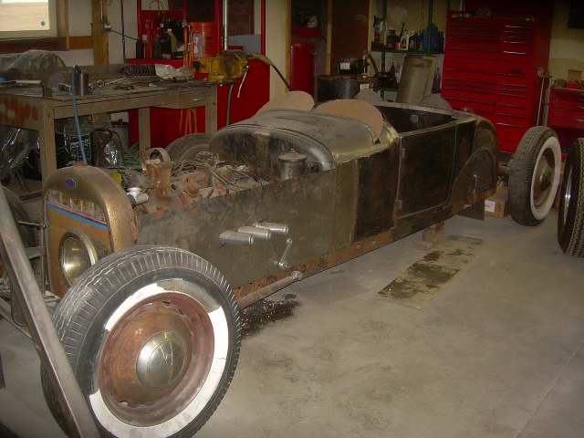

    Once I finished the hood sides I decided to move right down the car and finish the cowl. The top is basically finished, but I had never gotten around to the sides.
    Here you can see the side portion of the cowl with a nice finished looking body line. I stared at this for what seems like hours figuring out the angle of the bottom of the body. Does it look right to you?
    Here's another angle. The lower body line is bent 90 degrees also which gives it a ton of strength.
    After a lot of thought I realized that the body line looked good level with the ground, so I made a jig set to the height I wanted to keep it all level. You can see it in action in the picture.
