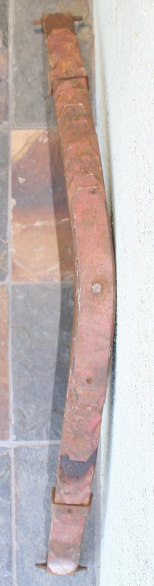

    You can grind the 35 and newer spring to fit. I have seen it done on old hotrods with 40 rears. Curved springs are 32 to 34. Where did you find the frame?

  15. If you do use a '32-'34 spring, you are limited to either using an early banjo or changing the spring hangers on a later rear. If you grind a '35 up spring to fit the '32 crossmember you can use a later banjo rear as is.

  20. Here is a top view of a '32 spring IMG_8317.jpg I just sold.
    Charlie Stephens
    bct likes this.

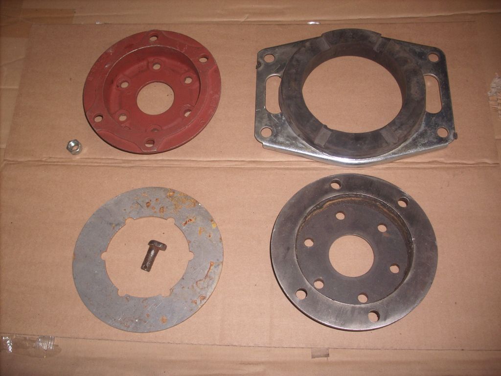

    I found a donor trans in my pile for the mount parts so that is sorted. car003.jpg

    Mount...the flat plate from '32 that actually bolts to the frame and the rubber ring are reproduced. The casting can be sourced from a late model car, '33-36 with the 2-ear types of mounts...that means look for the rubber ring in there, if you see that you have the kind you need to cannibalize.
    Pete Van Seggern on the barn did a nice pictorial of the work on a late spring. Nothing too dramatic.
    You want Hurs a-28 mounts that bolt to the inside of the frame channel...Tardel sells new ones essentially identical. All others I know of are short to weld to a boxing plate.

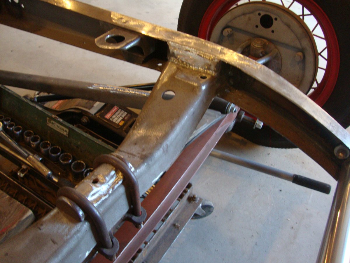

    Thanks bruce. Those are exactly what i have in mind. Found this pic you posted earlier via google .
    Was there only one sized passenger car /truck trans 33-36.? I have one but man it looks tiny.
  27. bct
    Joined: Apr 4, 2005
    Posts: 3,175
    bct
    my frame. Super excited about this!
