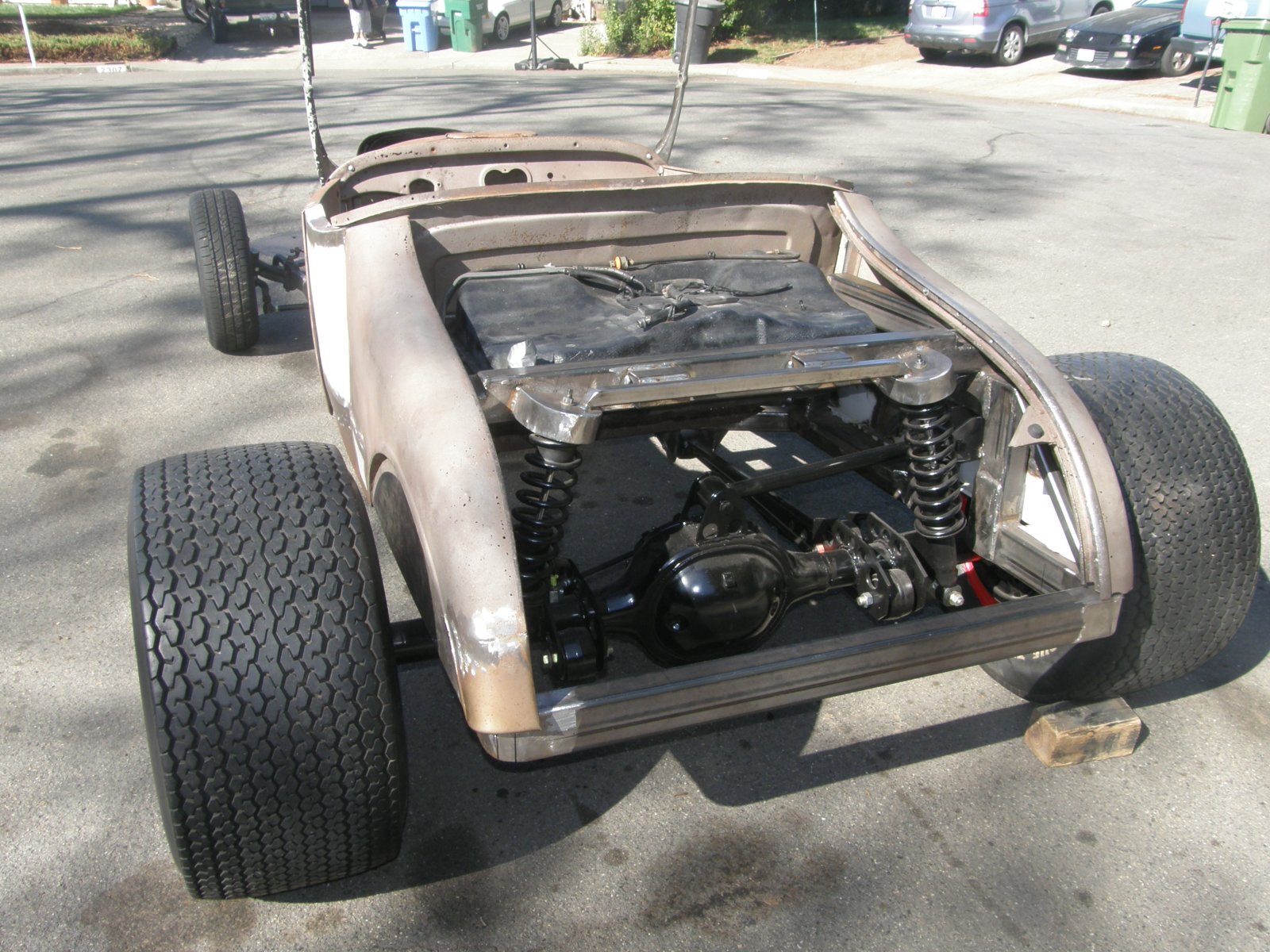

    I have a 29 Roadster pick-up in build, similar to the one in the picture shown. The rear end is an 8 inch Ford, with triangulated suspension, and coil over shocks. Currently Speedway has 200 pound, 225 pound, and 275 pound rated shocks in stock. The10 gallon fuel tank, and maybe IMG_8836.jpeg the battery will be in the bed. Does any one have a suggestion as to the weight/strength of the coil overs needed? Old guy, cancer patient. More than likely last hot rod....Thanks

    Here's a cheaper alternative. Coilovers off an '88 Subaru station wagon. $9 each at Pick-N-Pull. I can't remember but I think they're rated at about 150psi. This is in my T roadster. Mounted off an 8" Ford rear and carrying a 13 gallon Geo Metro fuel tank and battery. Not too springy, just about right!

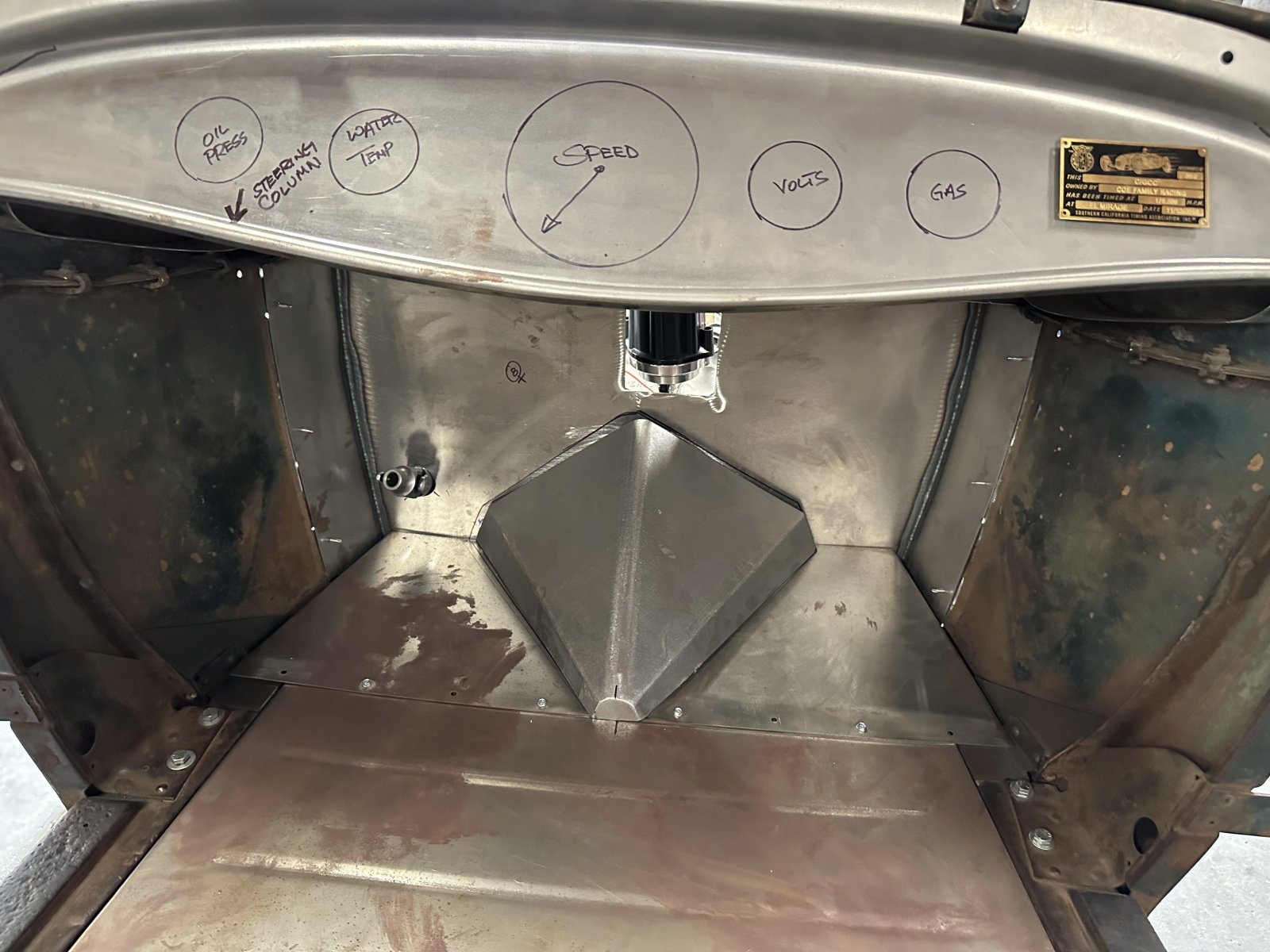

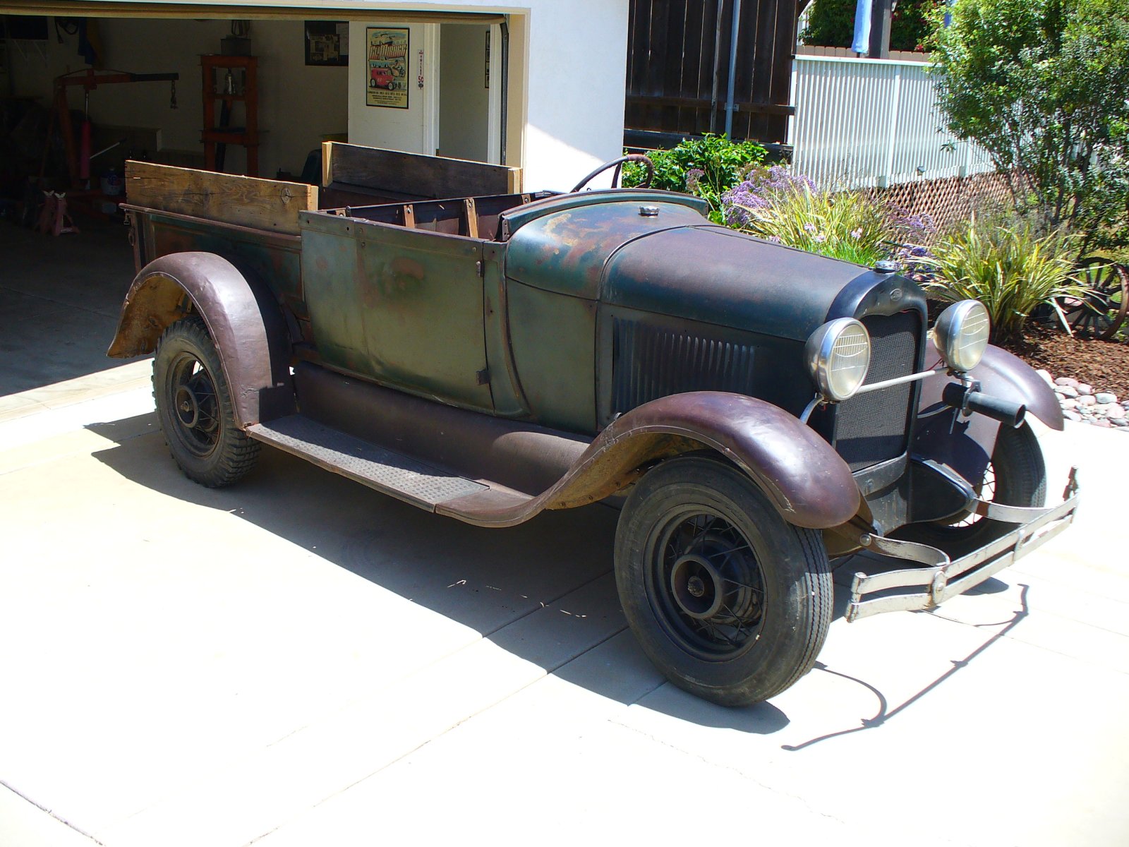

    Thanks for your responses. I was reluctant to share photos of my build, because it has an off topic motor. I'm old, and long legged. The logic of the motor choice was because of the size of it. (Size matters) As we know there is very limited leg room in Roadster Pick-Ups. So, I decided to reverse the firewall 4 inches, and install a 4.3 Chevy V6. They are about 260 cubic inches, are 4 1/2 inches shorter than a V8, and with a cam, and some head work should make 175 horse or so. Here's some pictures. Before, and after the ruination of the farm truck. View attachment 5831413 View attachment 5831413

    Nothing wrong with a 4.3. I did enough customer model A ch***is with a 4.3 that I invested in a plastic block which made it easier to set up the motor & trans. Your firewall extension is very innovative and make your driving time more comfortable.
    Tman likes this.
  12. LOVE the short engine/extended toe box!

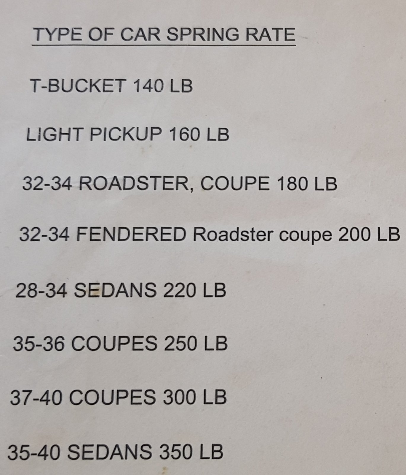

    Looks like you started with a great body. I like your idea on the firewall. I'm going the other way (extending the quarters) as I'm going to run a 283. I have a 4.3 as well but realized I would never be happy with the sound of it myself. I've sat in several of different configurations, a stretch of some sort is necessary for comfort for me as I'm 6'2".
