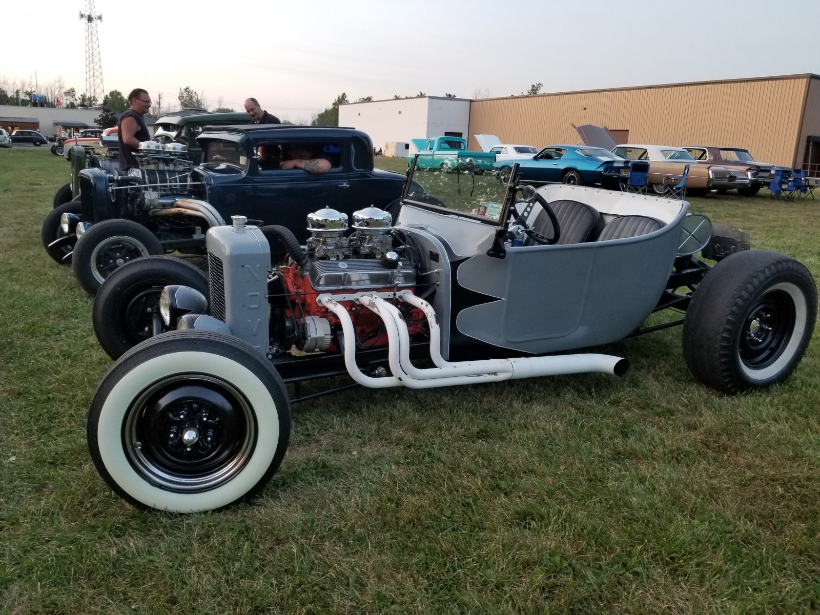

    Here's a 5.60-15 on a 15x5 Wheel Vintiques wheel. If you can find a 4.5" wheel that would perhaps look even better.

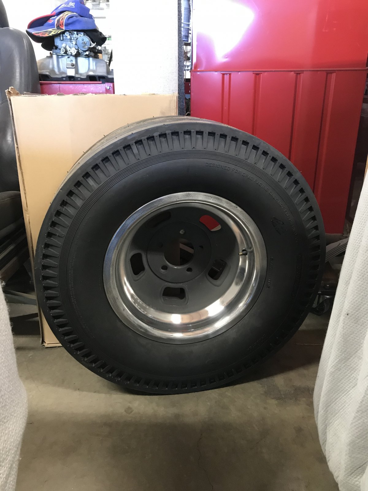

    My rears are 810-15 on 15x6 Steelies. That's what looks best on a 800-810. If you go 820-850 I'd say a 7"-7.5" rim. I can't say for certain what would look best on a 10.00-15. Is that a cheater slick? Or one of the Firestone Grooved Dirt Track tires? Check the specs on the tires you want, typically they'll recommend a rim width. You also need to consider what offset you'll need. Have a rear axle picked out yet?

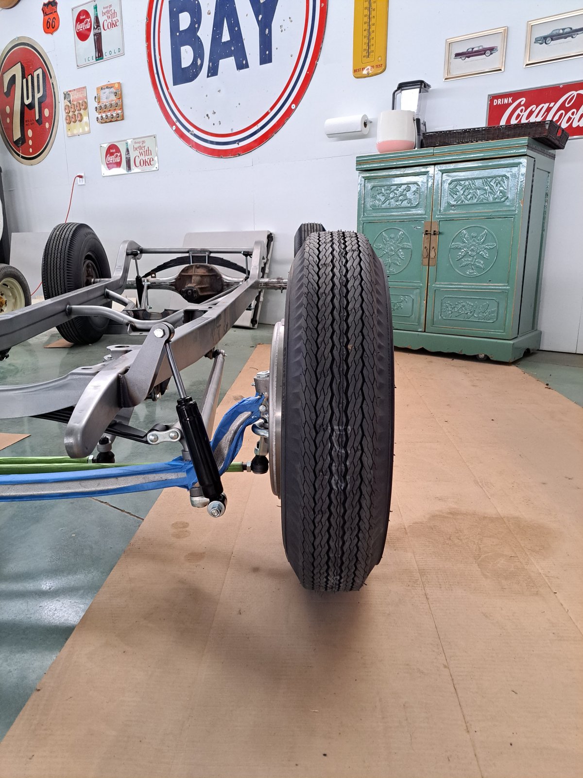

    Here's a 10 inch cheater on 10 inch rims, looks pretty good to me
