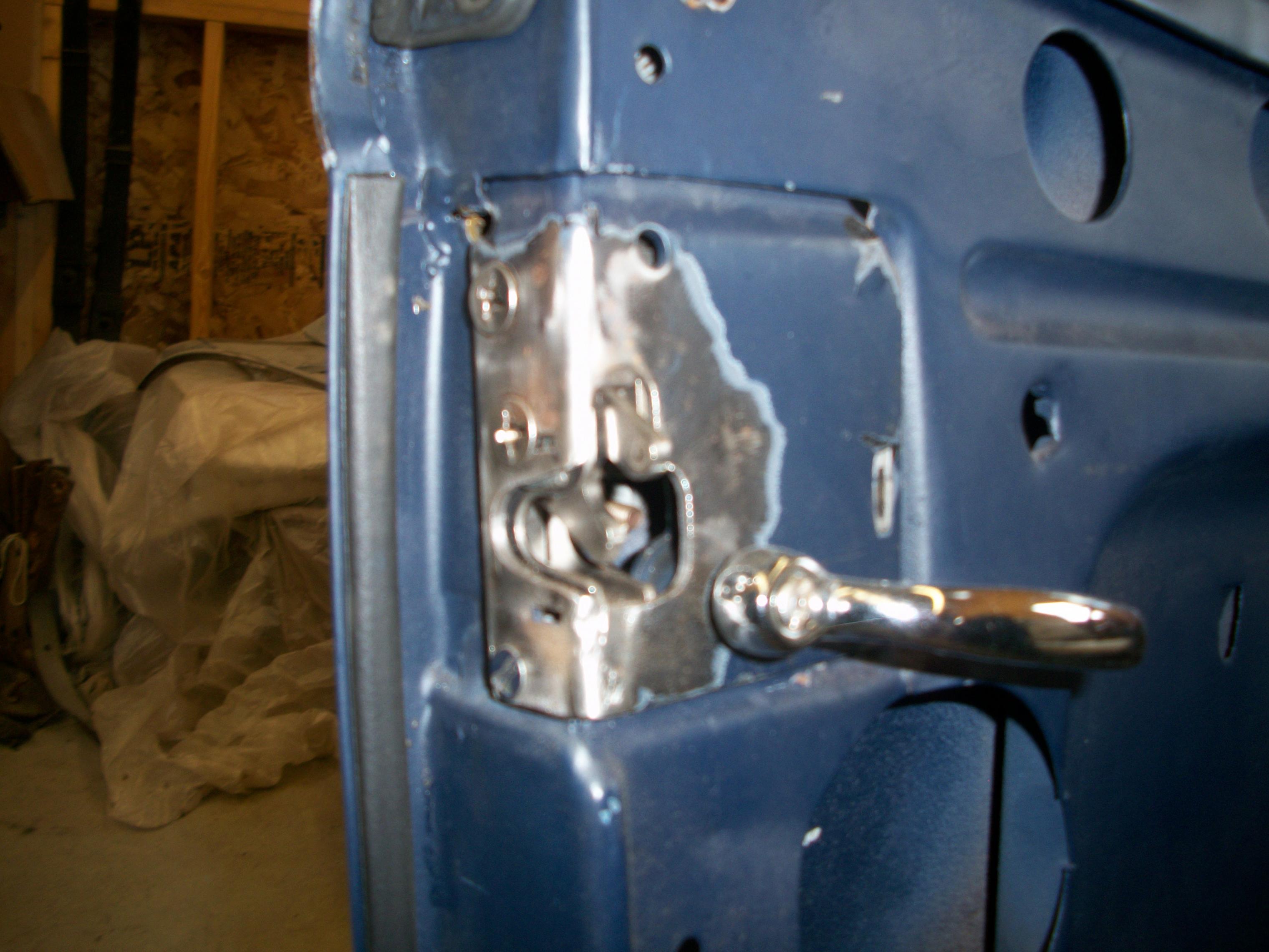

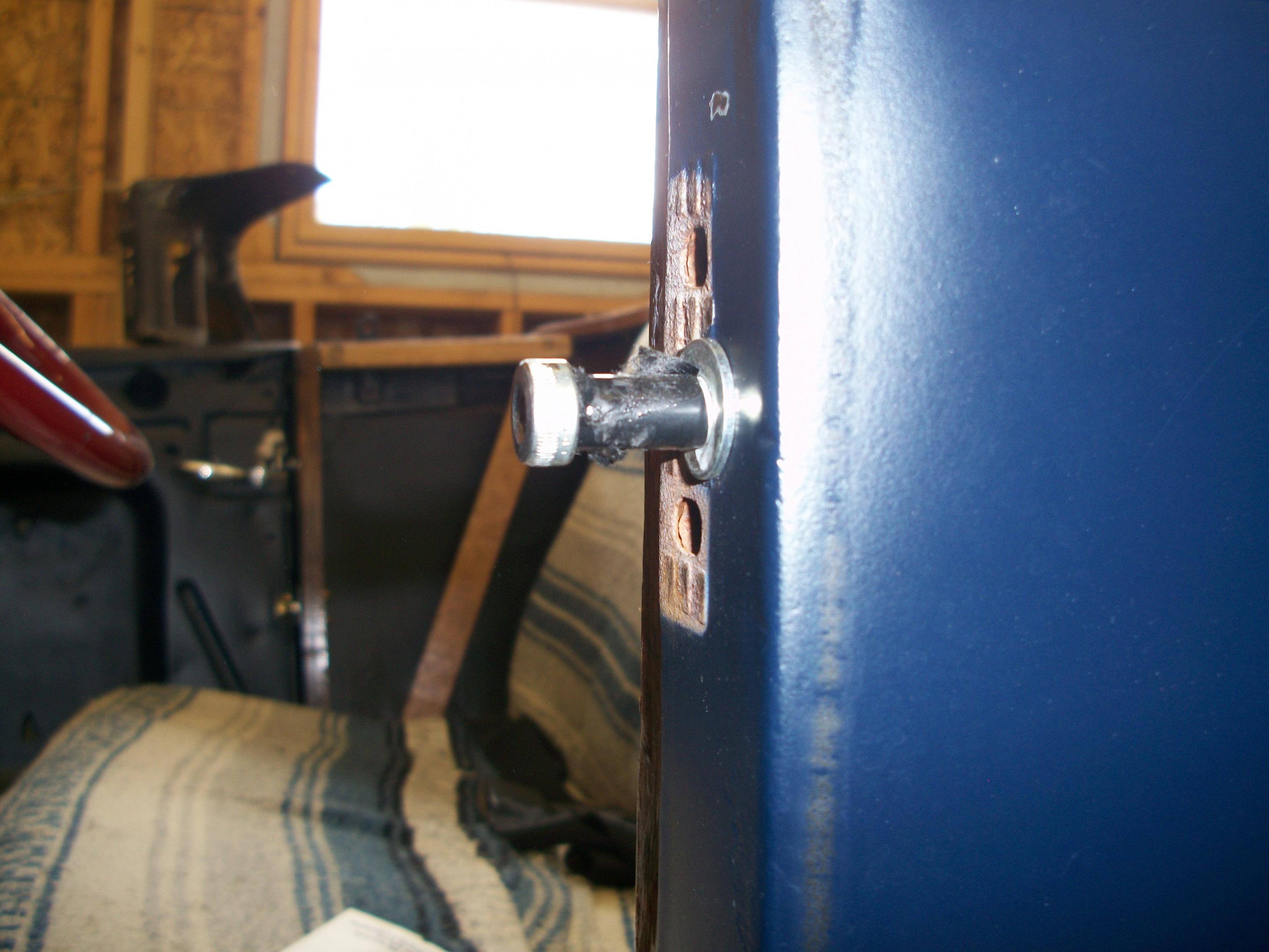

  10. John Lafayette
    Joined: Jan 15, 2011
    Posts: 95
    John Lafayette
    Installing the latches was a lot of work! I bought the smaller of the 2 latches that are available. I took out the stock latch and gutted it. I mounted the bearclaw behind the stock gutted latch and ground out the area for the latch mechanism. This was all trial and error. Cut and install, cut and install, etc. You also have to make a return spring for the latch to have the right feel to it. I also had to modify and line up the latch for the stock handles to work. The stud on the door jamb is tricky. I had to remove the wood from the jamb first. I then closed the door and stuck a pencil through the latch and made a mark to drill on the doorjamb. Measure twice, cut once!!! Then install the stud. Grind out the wood and done. I can take a picture tommorrow, The car is buried but I can get to it easily. Take care, John

  21. bobscogin
    Joined: Feb 8, 2007
    Posts: 1,792
    bobscogin
    Pictures if possible would be great!

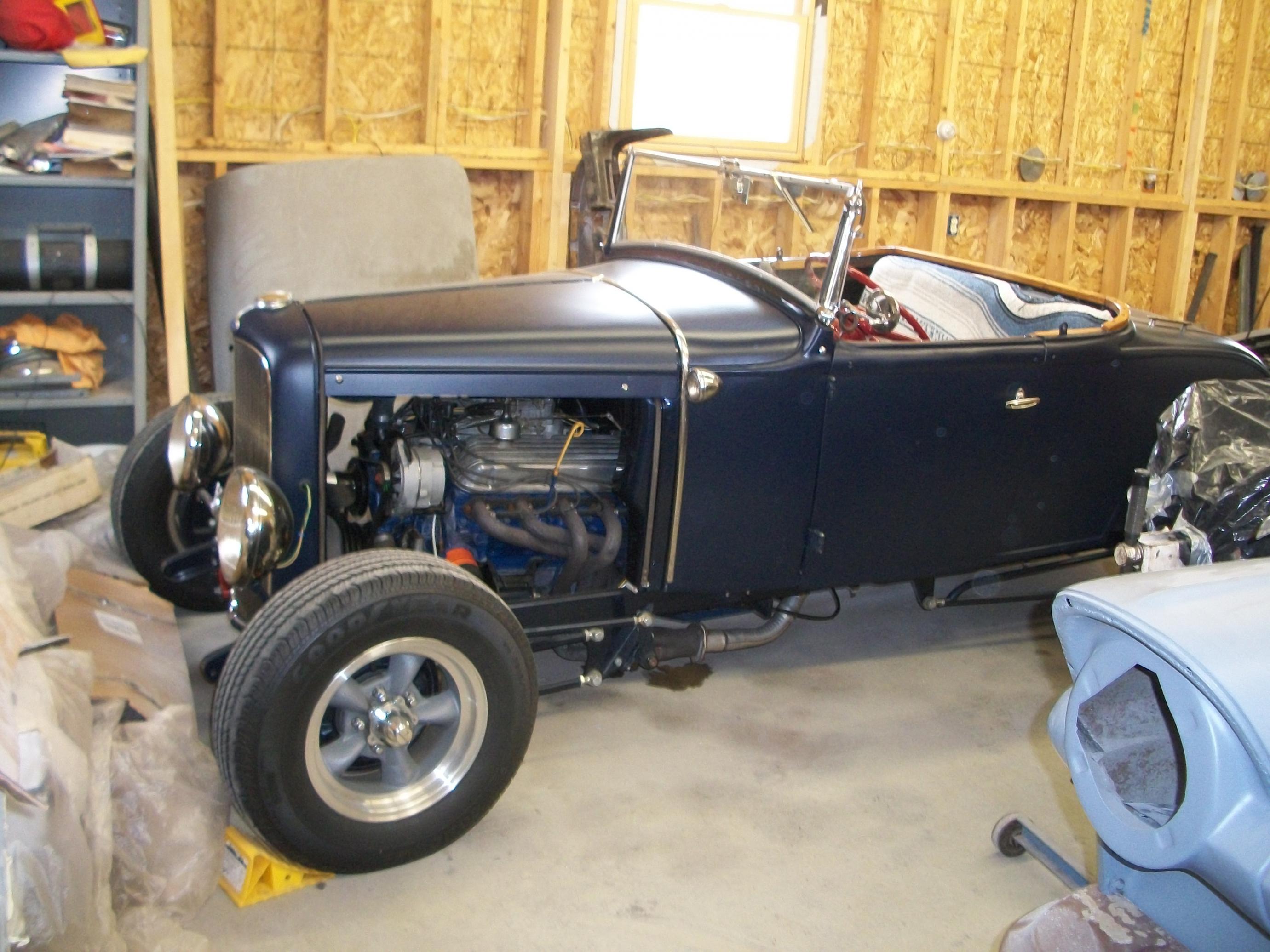

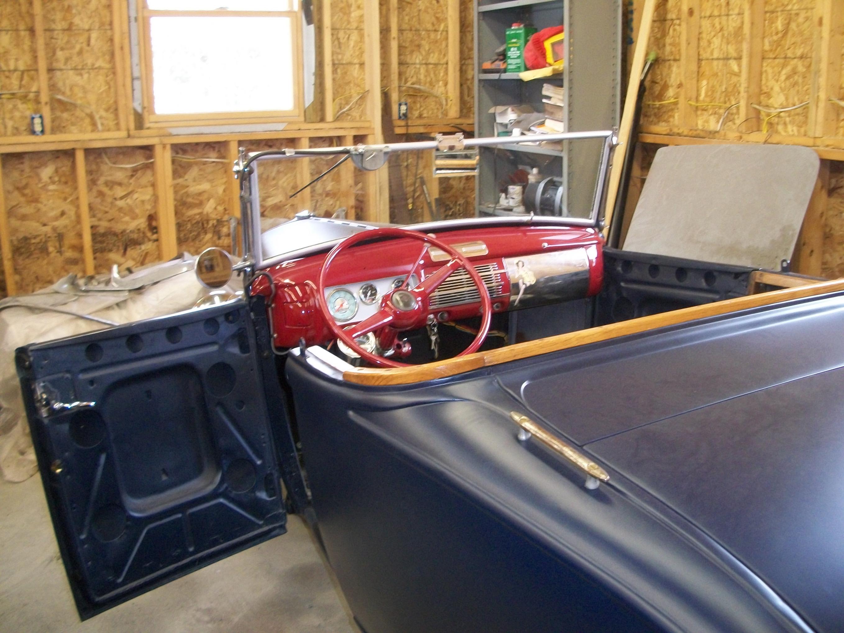

    Here are a couple pictures. had a hard time loading them . See if it works!

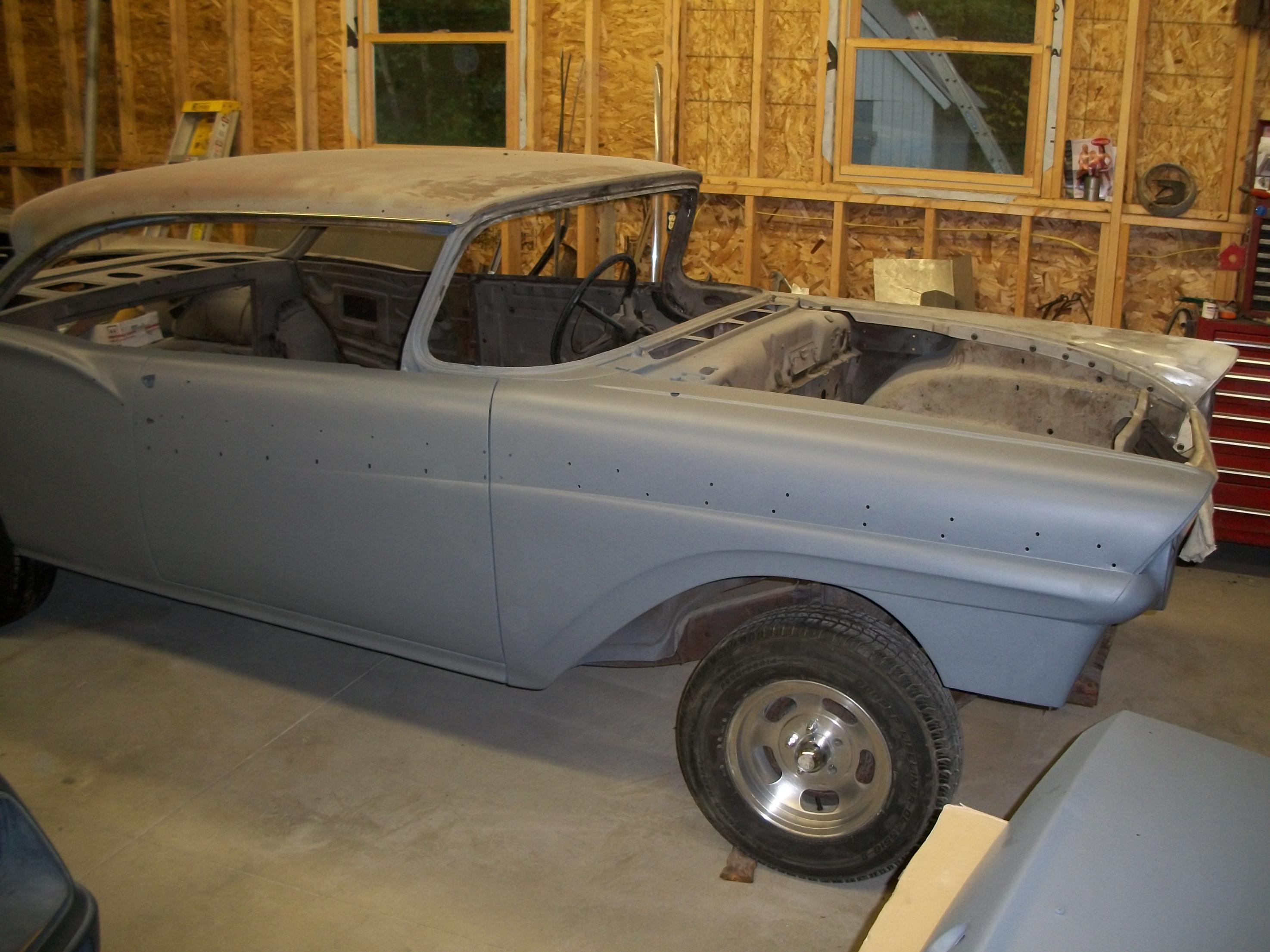

    Here is a couple more. You can see part of my 57 Ford. I bought in in high school in april of '81 as a stupid kid. It had been a 60's hot rod. Restoring it now back to a 60's hot rod. I also am painting my "86 Mustang GT conv. It's an 80's thing. I had much fun in the 80's !!!!!!!!!!!!!! Thanks John

    Seems like a good frame "X" memember my help too[could be a bolt in]. Plus I had a plywood devider between my seat and the trunk that was a very good fit with some box tube bracing in cowl.
    Are head lights as out of adjustment as much as it looks in photo?

    Yeah the headlights are pointed too high. When I modified the headlight bar I welded it on a angle. will fix it someday.
