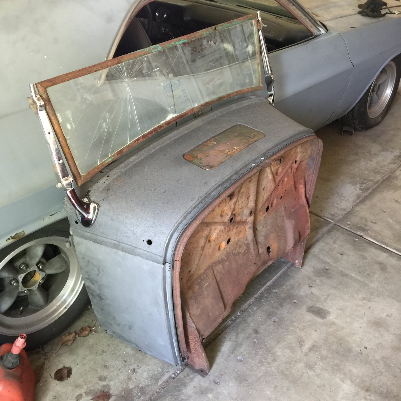

    In order to use the '32 windshield posts on the '30-'31 stanchions the lower stanchions must be relieved to allow the posts to tilt rearward. If you are considering a top, the '32 windshield posts will complicate things a bit. This is what I used on my roadster. I'll add a picture. Ron[​IMG][​IMG]
