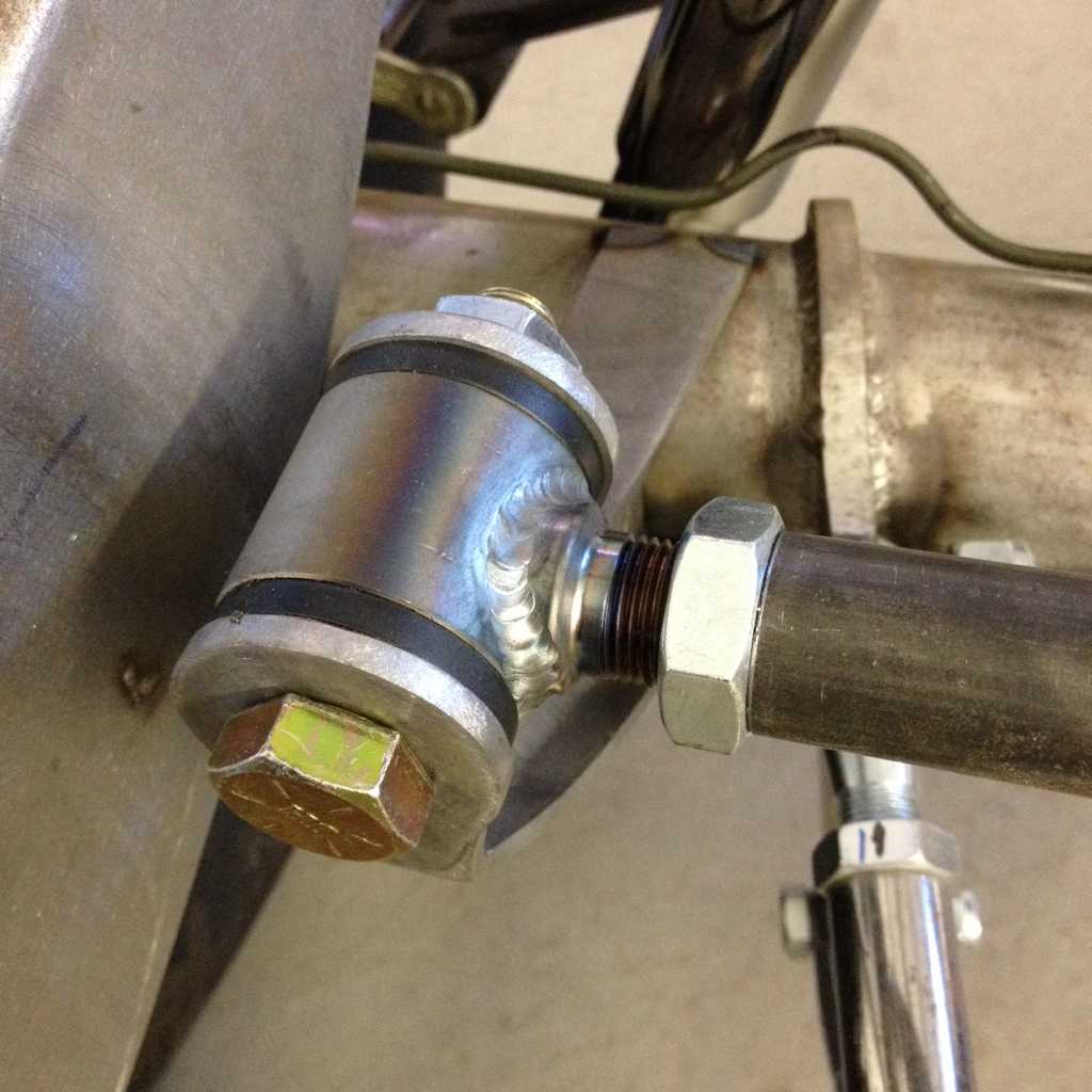

    So next I fabricated the upper and lower shock mounts I used Pete and Jakes chrome shocks to match the front. ImageUploadedByH.A.M.B.1418088784.447989.jpg

    Then I fabricated a t style bracket for the lower shock mount.

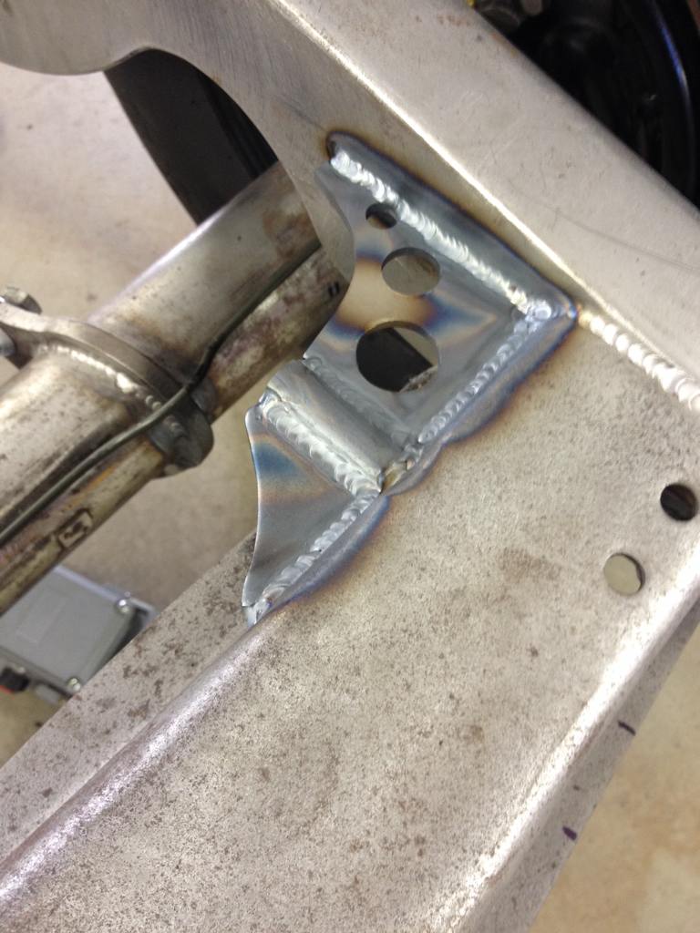

    Here's the finished bracket before I weld it to the rear housing.

    Here's a picture with everything tacked into place. ImageUploadedByH.A.M.B.1418089444.375579.jpg

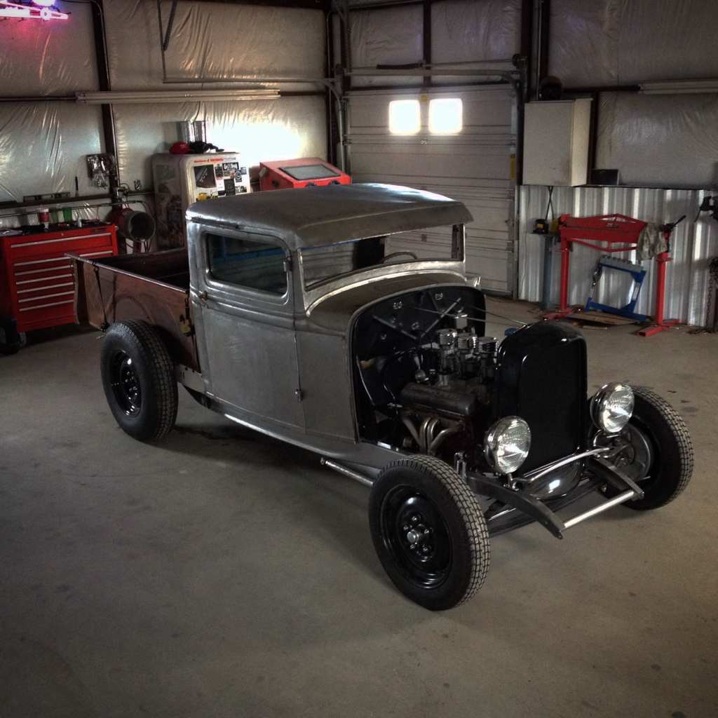

    While I was held up on parts I had a moment to put the body and bed back on the frame and for the first I was able to stand back and look at the truck as a whole, I'm pretty happy with everything but I will be changing a few small things first is the front spring so I can get the chassis a little lower to the ground, second is to swap out the front tires for something a little bigger. That's all for now more updates coming soon. ImageUploadedByH.A.M.B.1419464598.099603.jpg

    Starting my 4th deuce PU. So far I've had 2.5/4/and 3 inch chop. Just for curiosity how much is your chopped? Are you going to shorten the bed from stock? Your project is looking really good.
  18. rob bob
    Joined: Aug 18, 2011
    Posts: 446
    rob bob
    from Canyon TX
    The truck was chopped when I bought it but I think it was around a 4 inch chop, the bed will be shortened to around 60 inches, its a 35-36 bed so I'll have to move the wheel wells forward so everything will look right, I know its a little unconventional to use a 35-36 bed on a 32 truck but once I'm done it will look pretty good (at least it does in my head)

  22. I know Larry will want to know...so what size tires are you running at the moment ?? And what will you put up front instead ??
    3wLarry likes this.
  23. rob bob
    Posts: 446
    rob bob
    from Canyon TX
    The tires on it now are 5.00 I'll probably run some 6.00's.
