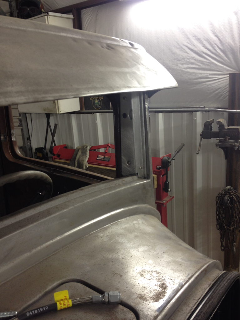

    I'm excited to get to this part of the build I can start showcasing some of the thoughts and ideas that have been in my head since I first started building this truck. But first I need to take care of some loose ends mainly chopping and mounting the garnish moldings. ImageUploadedByH.A.M.B.1424052216.179806.jpg

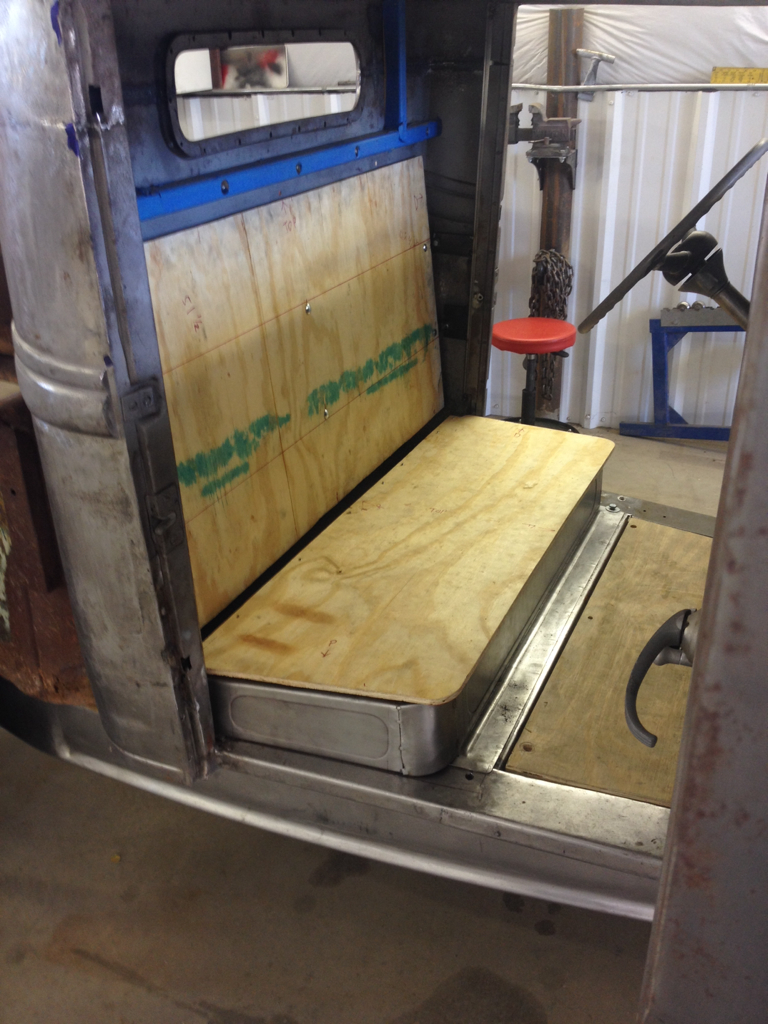

    Next I started building the seat pan/riser then finished the sides and front with some bead details. ImageUploadedByH.A.M.B.1424052504.522674.jpg . I'll mount the seat bottom on a hinge for some additional storage.

    After mock up I pulled the pan out welded and metal finished it, I'm proud to say the seat pan/ riser won't need any filler just prime and paint! ImageUploadedByH.A.M.B.1424052981.710548.jpg sorry for the two edges being a little off in the picture I corrected it later on.

    ImageUploadedByH.A.M.B.1424053193.660994.jpg and here it is metal finished and ready for primer.

    Then I built the square tube structure to mount the seat and seat belts. ImageUploadedByH.A.M.B.1424053459.382846.jpg

    Here's the ply wood cut to size and mounted . I hope to have the seat back from the upholstery shop in a few weeks! ImageUploadedByH.A.M.B.1424053741.105511.jpg

    Very ambitious! I really like that seat base, and will probably steal your idea if I don't use a hollowed out original (gas tank) on my '32 pickup.
