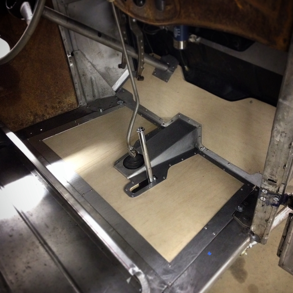

    Once the exhaust was finished I was able to set the body back on and start building the floors and trans hump I used oak ply wood and then added metal accents to tie everything together. ImageUploadedByH.A.M.B.1429132624.570441.jpg
