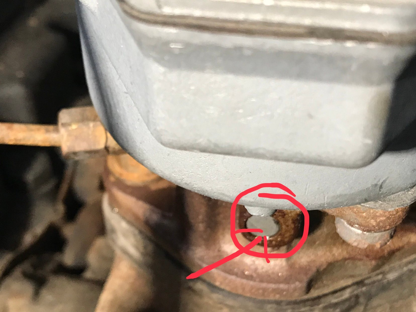

    Trying to get my 55 up and running again. After cleaning out the fuel tank, purging the fuel lines and clearing out the carb it was ready to start.
    Once we started to the engine over, fuel was coming out of the throttle throat. Specifically out of that silver cylindrical port? Or rivet? I can’t find a description of it or for some interim repair. Any help or words of wisdom will do? Thanks,

    I think your describing a leak from the end of the throttle shaft. A pic would help as your terms are not familiar to me. If that is where it is coming from it is due to the float not sealing and overflowing gas into the throat. Either dirt, bad needle/seat or float misadjusted or stuck.

  9. Maxwise
    Joined: Mar 30, 2019
    Posts: 16
    Maxwise

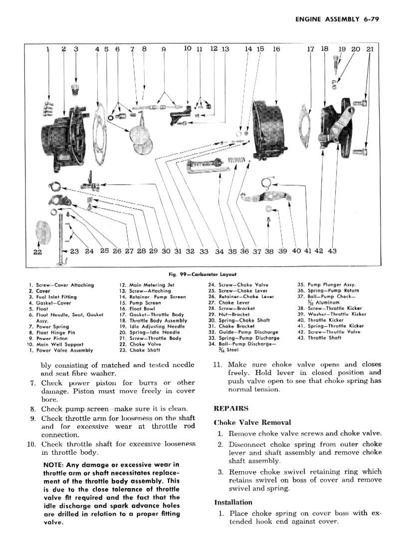

    Mine did the same thing, the bowl cover (#2 in above diagram) was warped and leaked fuel down the throttle bore when engine was running and when I shut it off it would continue to leak a little and travel along the throttle shaft and out the ends. I could never get the cover to stop leaking.

  16. These carbs are notoriously bad for warping the upper part of the casting and not sealing.
    There are threads here on the Hamb where guys have heated the casting 1/2’s up in the oven to some degree of success in getting them to seal again.
    If you look at any 216/235/261 that uses a Rochester b carb, most are weepy, not all. But it’s a common issue.
    I would not feel comfortable having a crab leak fuel over a hot engine and exhaust manifold.
    Rebuilt units are still available through nappa etc. Last time I looked it was around $200 buck with a core to exchange.
