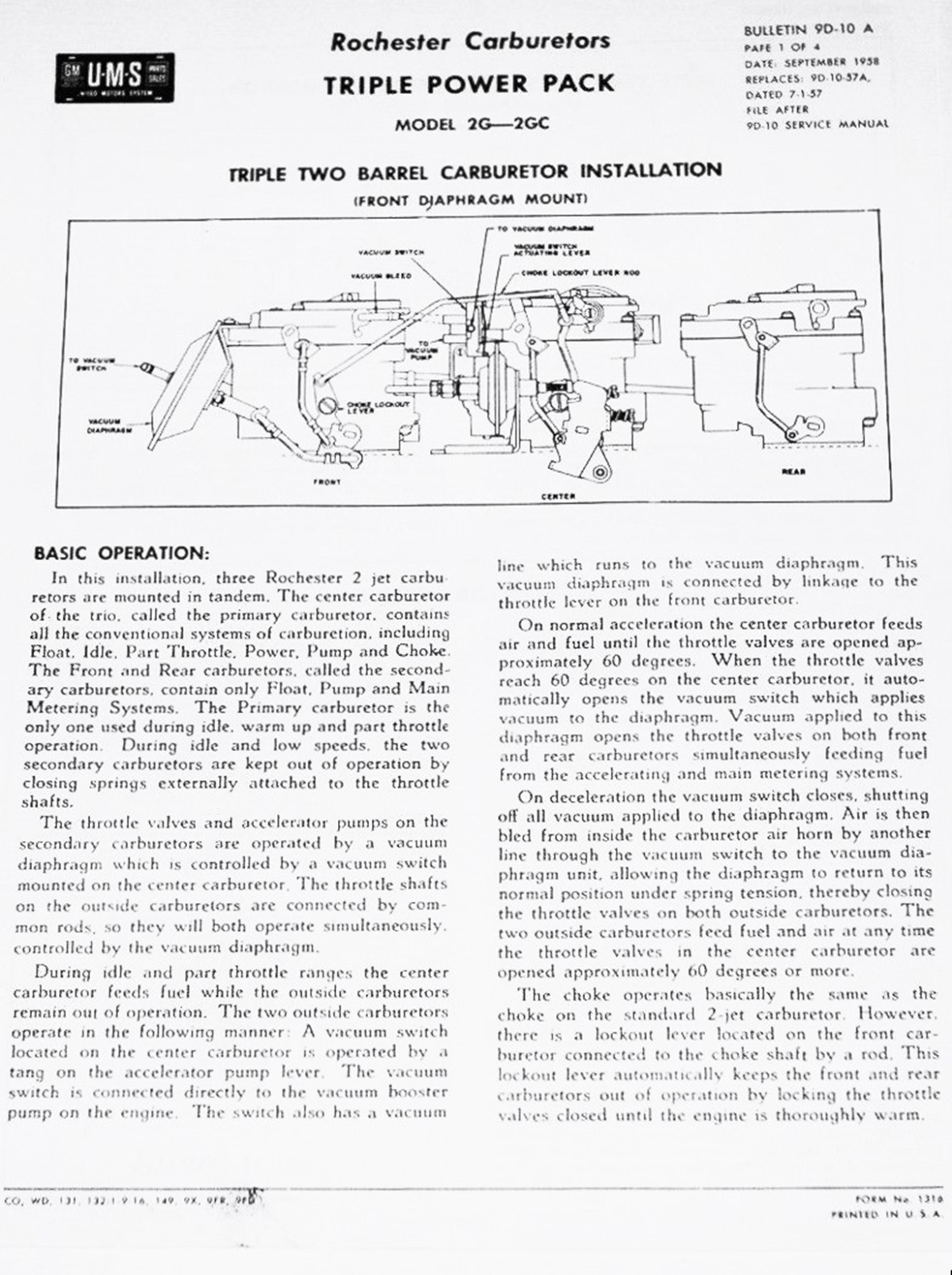

    Hello,
    I remember reading one of these types of flyers that was given to us by our dad's friend in Los Angeles. He was an expert mechanic, was well schooled and had surprising contacts in the industry from the very early days of Los Angeles hot rods and cruisers. When we still had the 58 Impala 348 280hp+ from 57 to 65 they gave us some good knowledge. They were very informative, as these flyers are supposed to be. After trial and error, we decided that the vacuum version was the best set up for our Impala.
    We tried the progressive linkage and liked the looks, but did not like the function, after many adjustments to all of the carbs. When the center carb was full open, the progressive linkage did not open the outside two carbs to full. When they were adjusted to full open, then the motor ran funny.
    The best was to run the center carb to full and hope that the outside two opened up. But, the back of our minds, it was not the best for daily street driving.
    At the drags, we set it for full center and full outside carbs with one push of the lever. But, remember, it was all out drags and no daily stop and go with normal traffic. All three two barrel carbs at once were not the best for comfortable daily street cruising to high school or at night to our Bixby Knolls hangouts.
    Now, with the vacuum, the center worked all of the time and when pushed to open to full throat, then the other two kicked in and opened to full throat. It was simple, felt great driving around to school, on dates, to the beach and even up into the mountains. Although in the mountains, those that knew, adjusted the carbs for better driving in high al***ude environment vs. the ocean level driving. (and vice versa when we came down from 8000 feet to sea level…)
    Jnaki
    So, the vacuum is/was the best for us. But, if you can’t set up a vacuum, then a progressive unit should work for you. You might be adjusting the Progressive link set up until you get it to where you like for comfortable driving. But, it did take many adjustments to get close to full power. Did I mention that progressive linkage stuck on one late night, foolish, full power acceleration away from my friends house?
    When we sold the Impala to another younger teenage friend, he knew about the vacuum verses the progressive linkage. So, he kept the stock vacuum unit, but had the progressive unit if he went back to the drags to race. Progressive was good for the drags, but, for us, not so good, on the street.

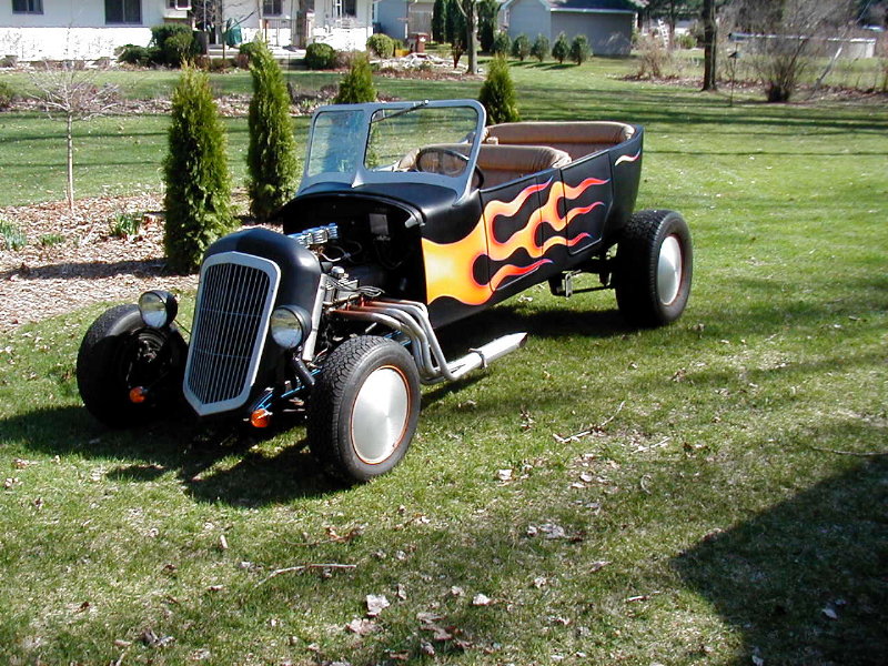

    I built a 3 x 2 setup for my tub's 302. The end carbs are dummies. (In a 1500 LB car I need three carbs like I need a hole in my head. I just want the look.) All the carbs are turned around backwards so they will clear the front-mounted distributor. It works fantastic, even with the carbs facing the wrong way - burns rubber at will.

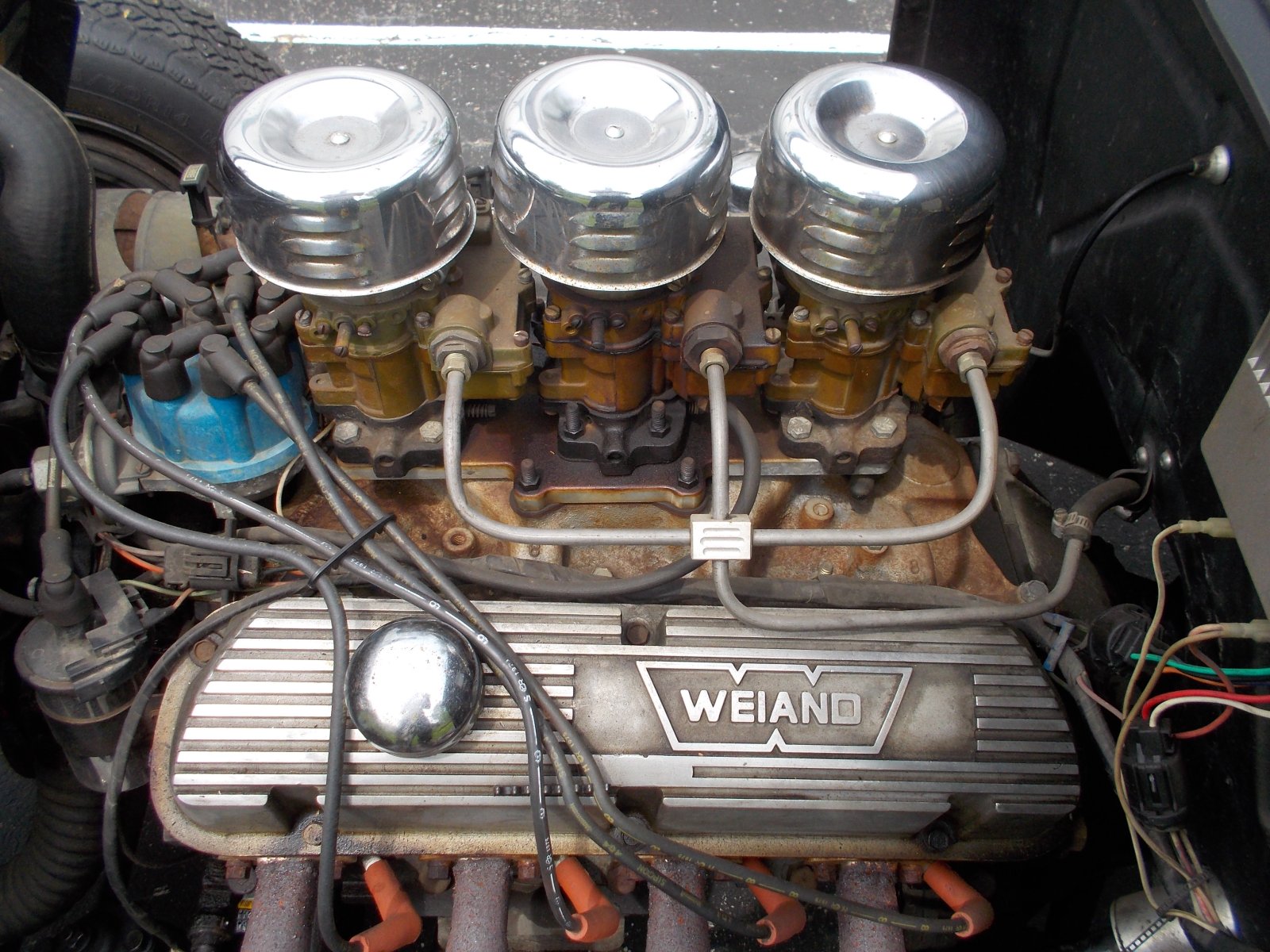

    Had this set up on a very warm 355 sbc years ago. Worked great on the street. WIN_20160212_115138.JPG WIN_20160212_114649.JPG

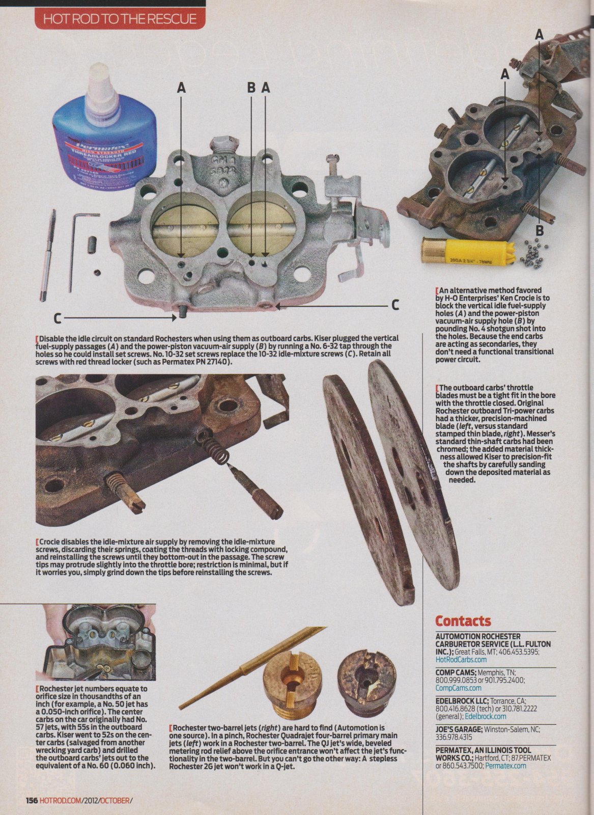

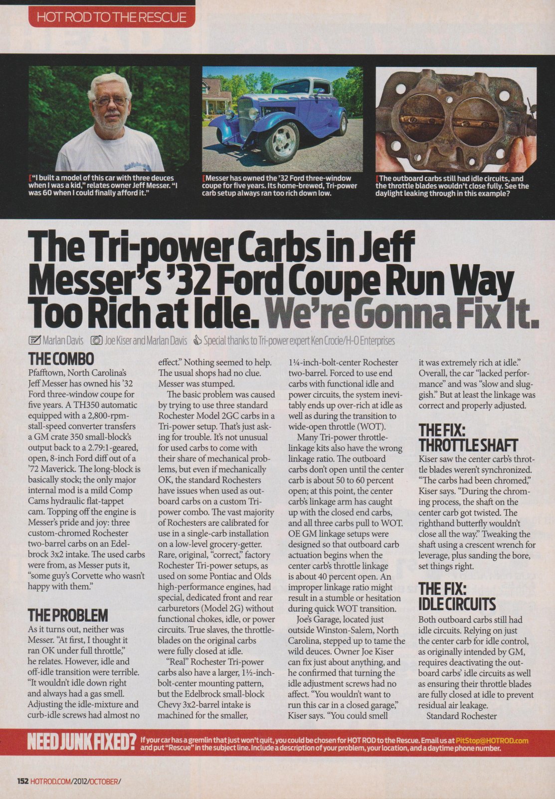

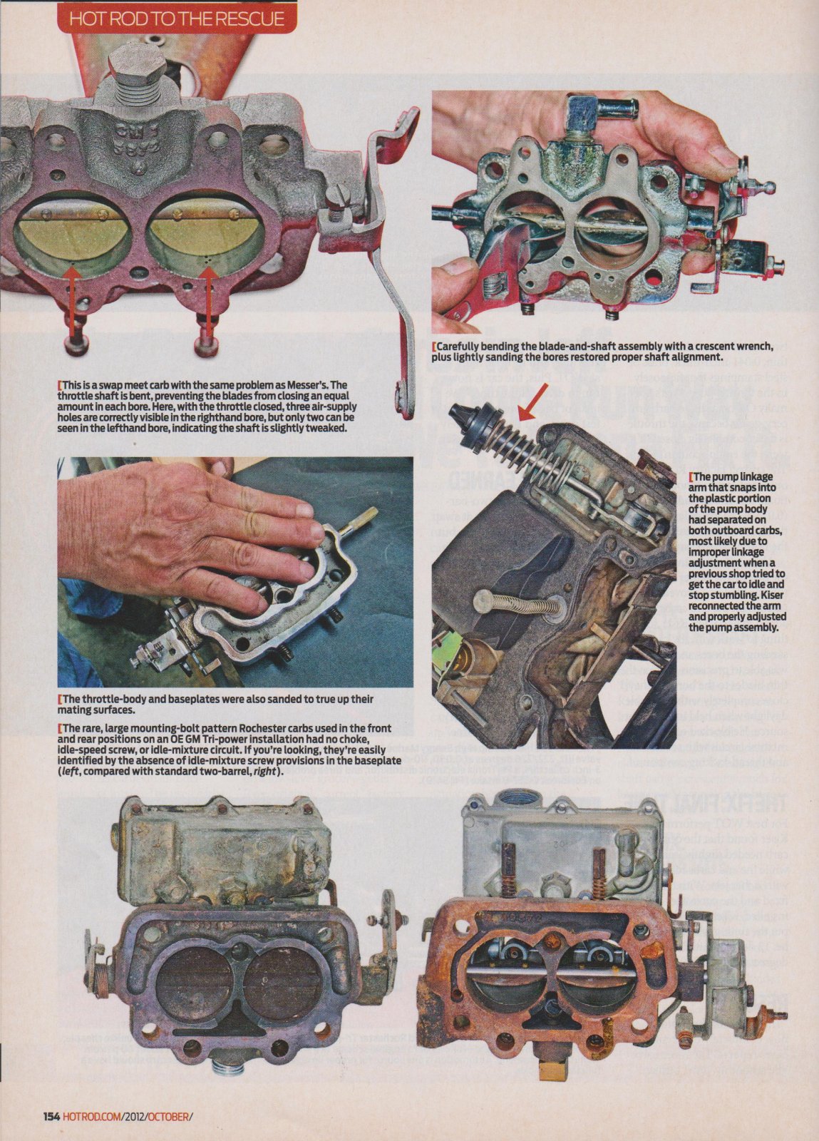

    Here is an article that might be of interest. Yet another reason to renew subscriptions..........
    Every tidbit helps.........:)
