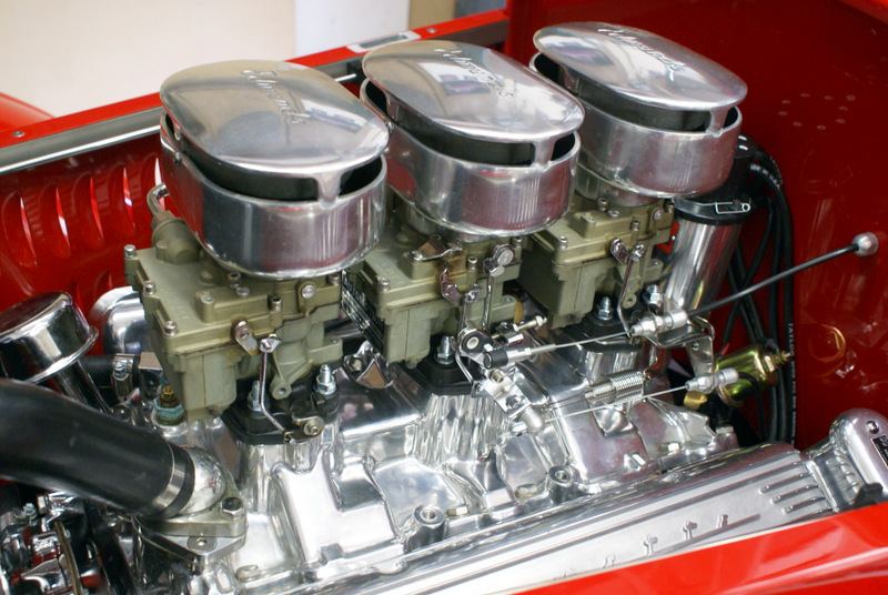

    My crate 350s Rochesters run 57s in center carb and 56s in the ends. I'm totally pleased with this setup.
    I highly recommend heat spacers under carb bases (eliminates gas percolation) DSC08707-001.JPG
