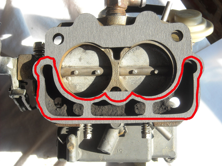

    Rebuilt my Rochester 2G and matched the gaskets for replacement but I'm not exactly sure if I should switch one out for a different one provided in the kit. It's the gasket between throttle body and intake manifold. The old gaskets were pretty beat up and brittle. And a ton of gunk was in this area. Should it be open like this or covered over?
    What is this area called? Should I stick with the same gasket as this?

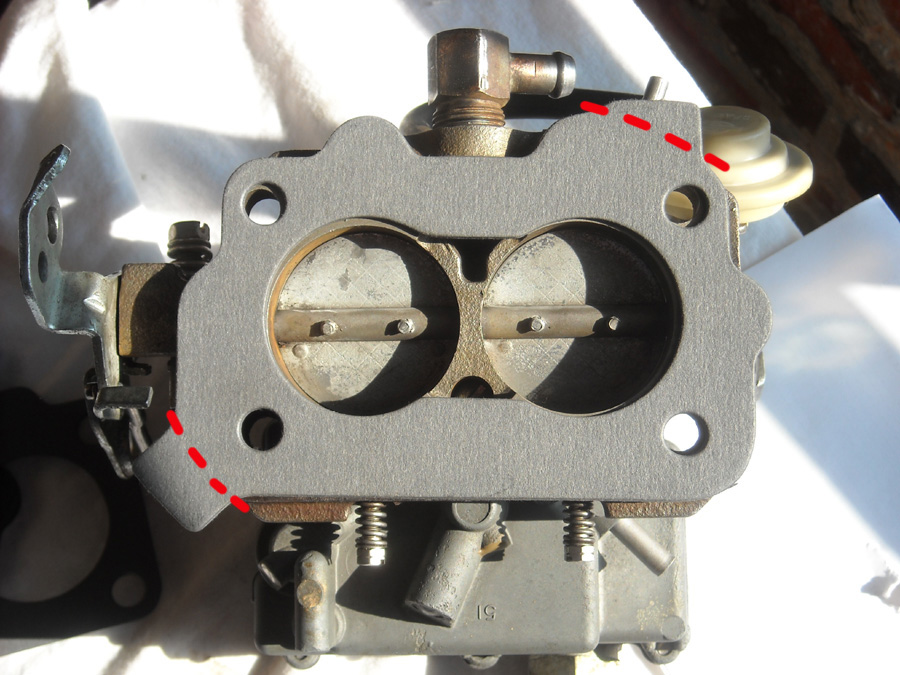

    Or should I go with one of these and just cut off the 'tabs' sticking out?
    The thicker gasket seems interesting and could act as a mini-spacer?:eek:
    (LEFT pic is standard thickness gasket-RIGHT pic is .25 in. thick gasket)
    I've looked at manual, diagrams, read posts but can't find any info about this. Thanks

    Have a look at the intake, that is the piece of the puzzle that is missing and confusing you. The gasket seals carb to intake and when you look at the intake the choices will narrow down. When an option i go for the thickest most isolating gasket as long as it seals the right areas.
  3. If you have the original intake for that carb, you'll notice a hole on each side that is probably plugged by carbon buildup. These used the first gasket you showed to allow heat from the crossover passage to warm the carb. If you are using it with any other than stock intake, don't worry a out it, use any gasket. If you are using the stock and open up these passages like they are designed, it will probably run like s!!t because of the low volitility of todays fuel. So I suggest using fhe solid gasket.
  4. Agree on the solid gasket, I'm a lazy bastard and wouldn't chop off the ears unless they were in the way of something.
    You can always pick up the OEM gasket with the reliefs at any parts store (in theory).
    Bob

    Solid Gasket it is. Thanks.

    The original manufacturer specified a gasket for a carburetor by tag number.
    The most expensive components in the aftermarket repair kits are the fuel valve (a.k.a. needle and seat) and the accelerator pump (although the neopreme pumps which don't hold up to ethanol fuel are not that expensive). The aftermarket repair kits (one size often fits none), in an effort to cut down inventory; will do a cross-index on most carburetors that use the same (well, the same replacement anyway) fuel valves and accelerator pumps, and then toss in all the gaskets used by the most common of these carburetors. The choice of gaskets is then left to the installer (sometimes none of the included gaskets are the correct one).
    When using an original carburetor with an original manifold; GENERALLY, one will have best results with the gasket specified by the original manufacturer for that application.
    When using a carburetor on a different (either aftermarket or a different original) manifold, the installer will have less difficulty if the installer determines what gasket is correct for the carburetor, and then compares this gasket to the manifold to determine that the gasket does not create any issues (either vacuum leaks or lack of vacuum to a passage that needs vacuum).
    If the carburetor in question uses a divorced (a.k.a. remote) choke; changing the thickness of the mounting gasket WILL REQUIRE recalibration of the choke (normally accomplished by bending the choke rod).
    Jon.

    Good info, thanks guys.
    I'll slap that 1/4 inch gasket on and see what, if anything, happens.
