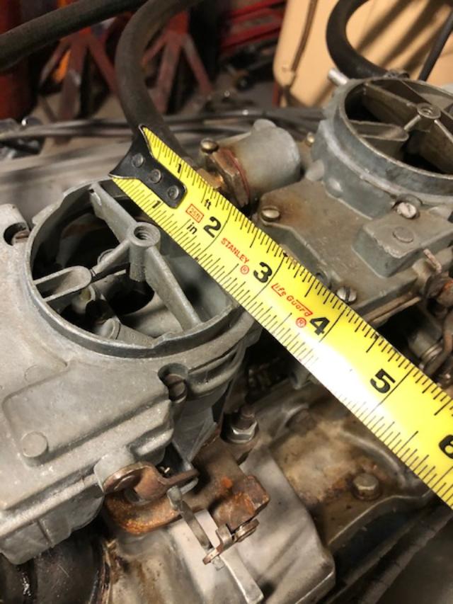

  1. I was wondering if anyone knows where I can get air cleaners for 2GC's that have a 3" outside diameter "inlet"?
    From what I was told, I have Pontiac Tri-Power carbs but all I am finding under that search is 2 5/8 ones.

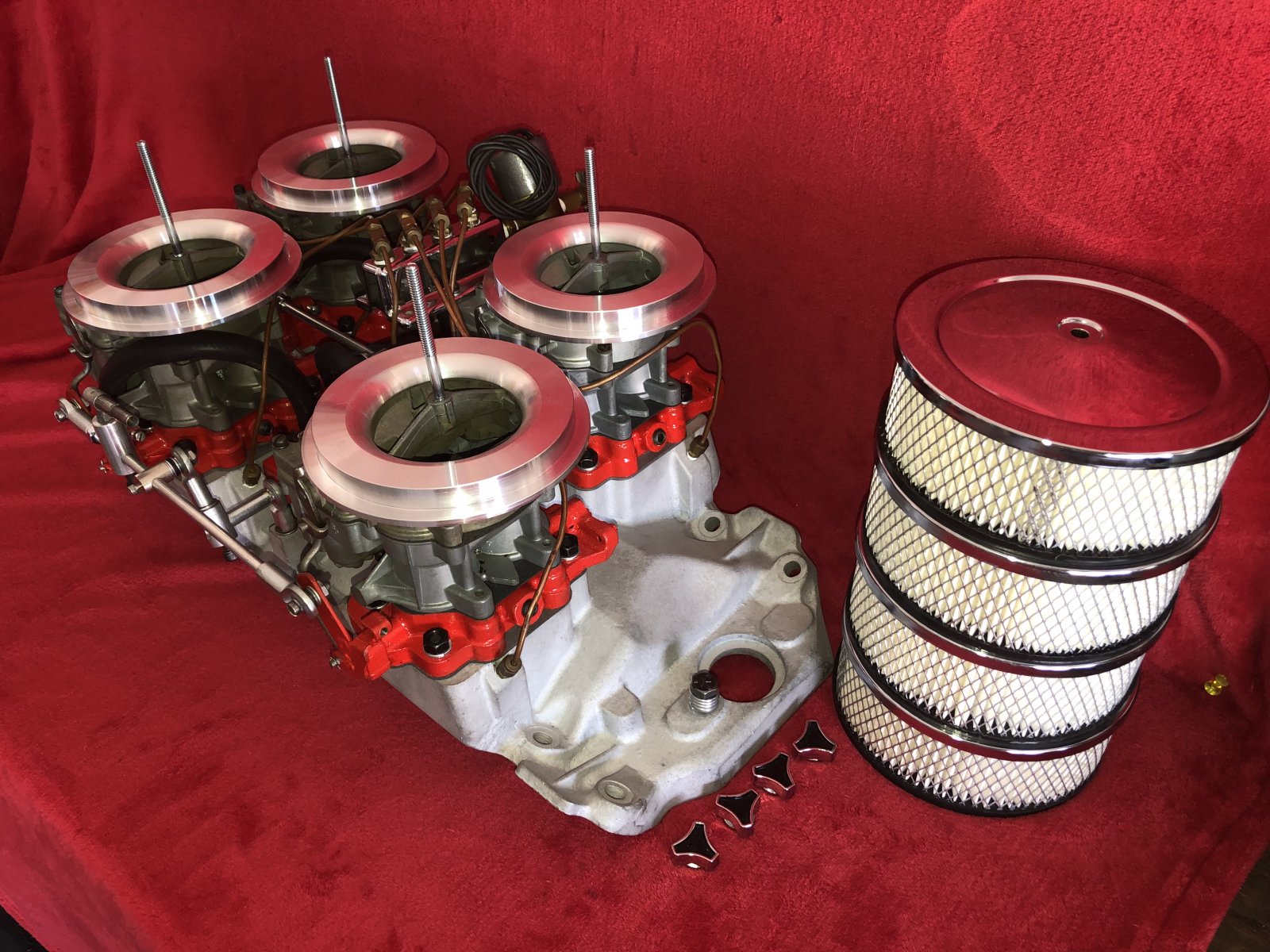

    You find what you need? If not get the aluminum adapter, 3” to 5” that Speedway makes. Then use their regular 5” air cleaner. Here’s a set on a four deuce that I just finished. BF81C359-8350-40CA-9479-BCA041515226.jpeg

  6. That wont work on a 3 deuce setup... I had to fab my own for a SBC.
    Same here all I could find was the 2-5/8 throat air cleaners.
