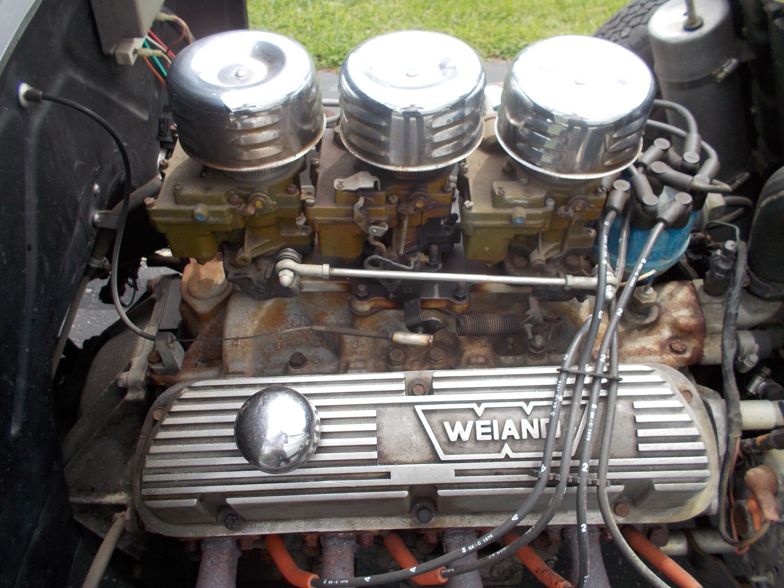

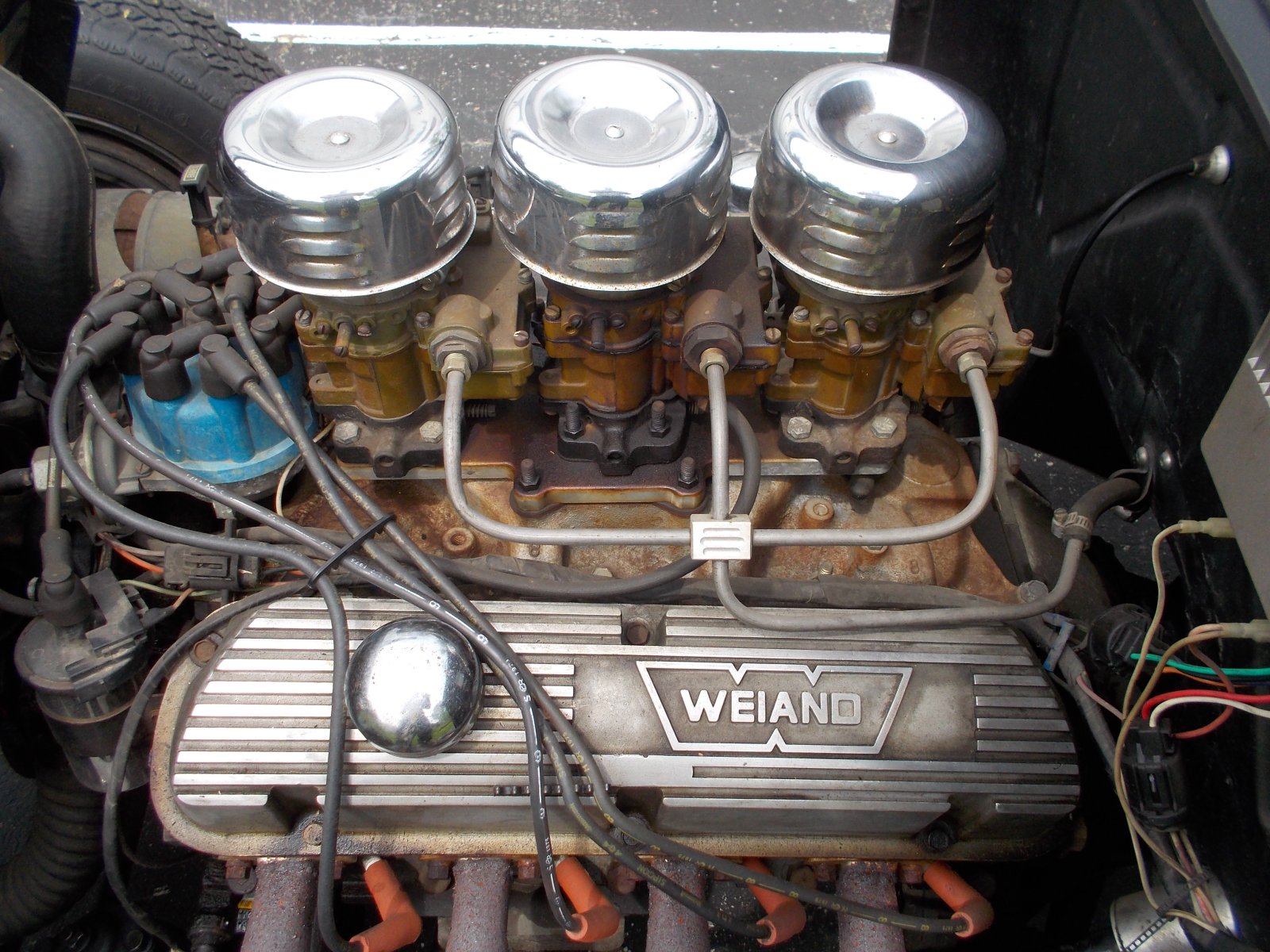

    I do not know if this is helpful or even relevant, but I put three 2GCs on a small block [302]. I had to turn them around backwards so they would clear the front mounted distributor. I used the lower kickdown link for throttle hookup.

    Frenchtown Flyer, I do not think there will be a distributor clearance problem, the dist. is in the rear, but turning the carbs backwards may be an option. Thanks
