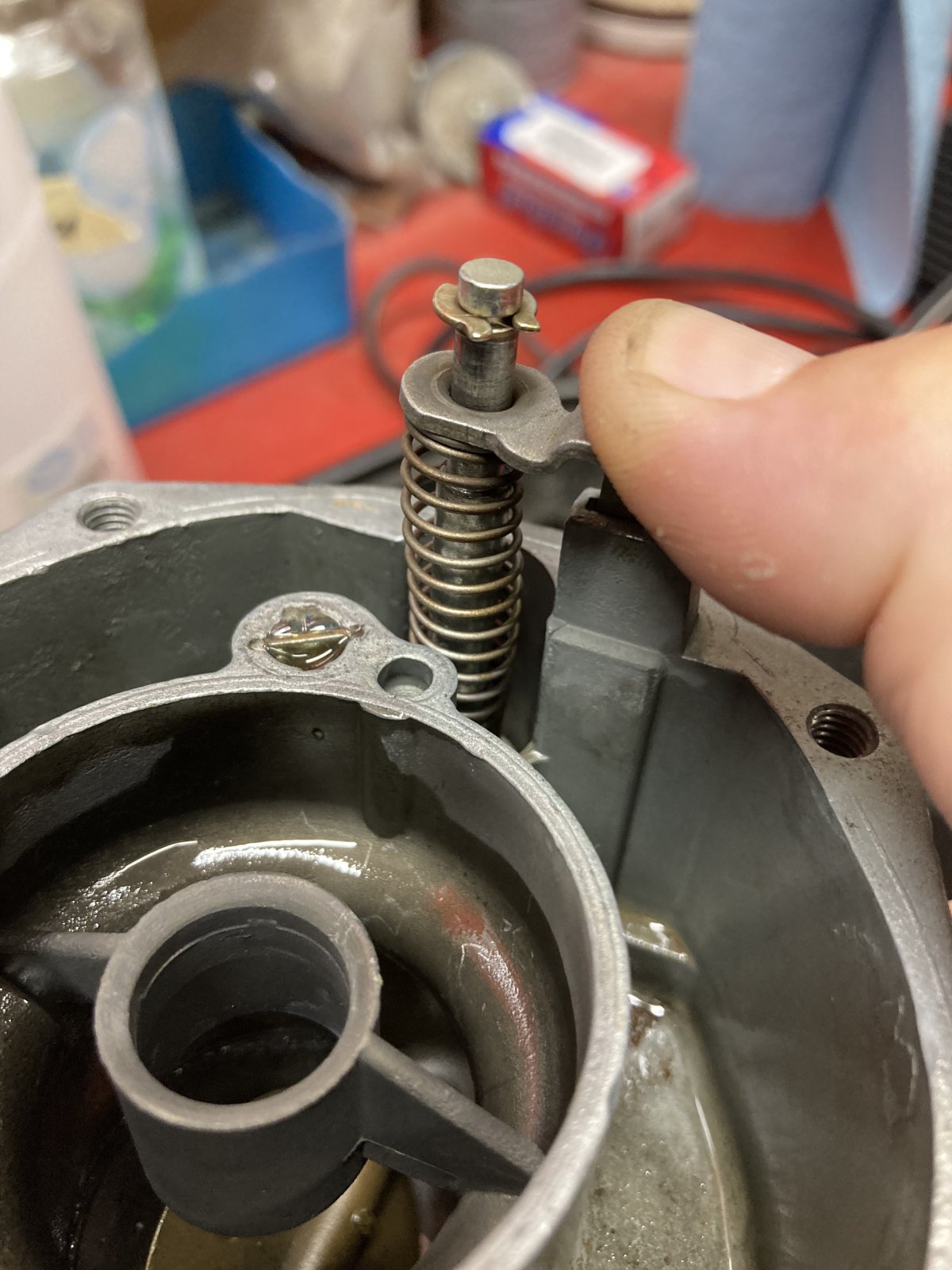

  5. ryanhewitt
    Joined: Jun 28, 2017
    Posts: 27
    ryanhewitt
    from Vegas NV
    This is just the spring pushing the plunger.
    This is after I “***ist” the plunger.
    The spring is obviously not pushing the plunger through its entire travel.
    Thanks for the input so far!
    Ryan

    Well, upon closer inspection the bore is fairly scored. With my initial visual and finger feel, I didn't notice it was scratched. I polished it, new cup (new ***emble as cup alone was not available), light grease, and re***embled. 1 thing I noticed was the new cup was visibly small in diameter. Careful measuring of the 2 showed .02 inches. New one went in the bore a lot easier. I've tested it, and I have a good squirt for now. If it starts acting up again, probably time for a new carb.
