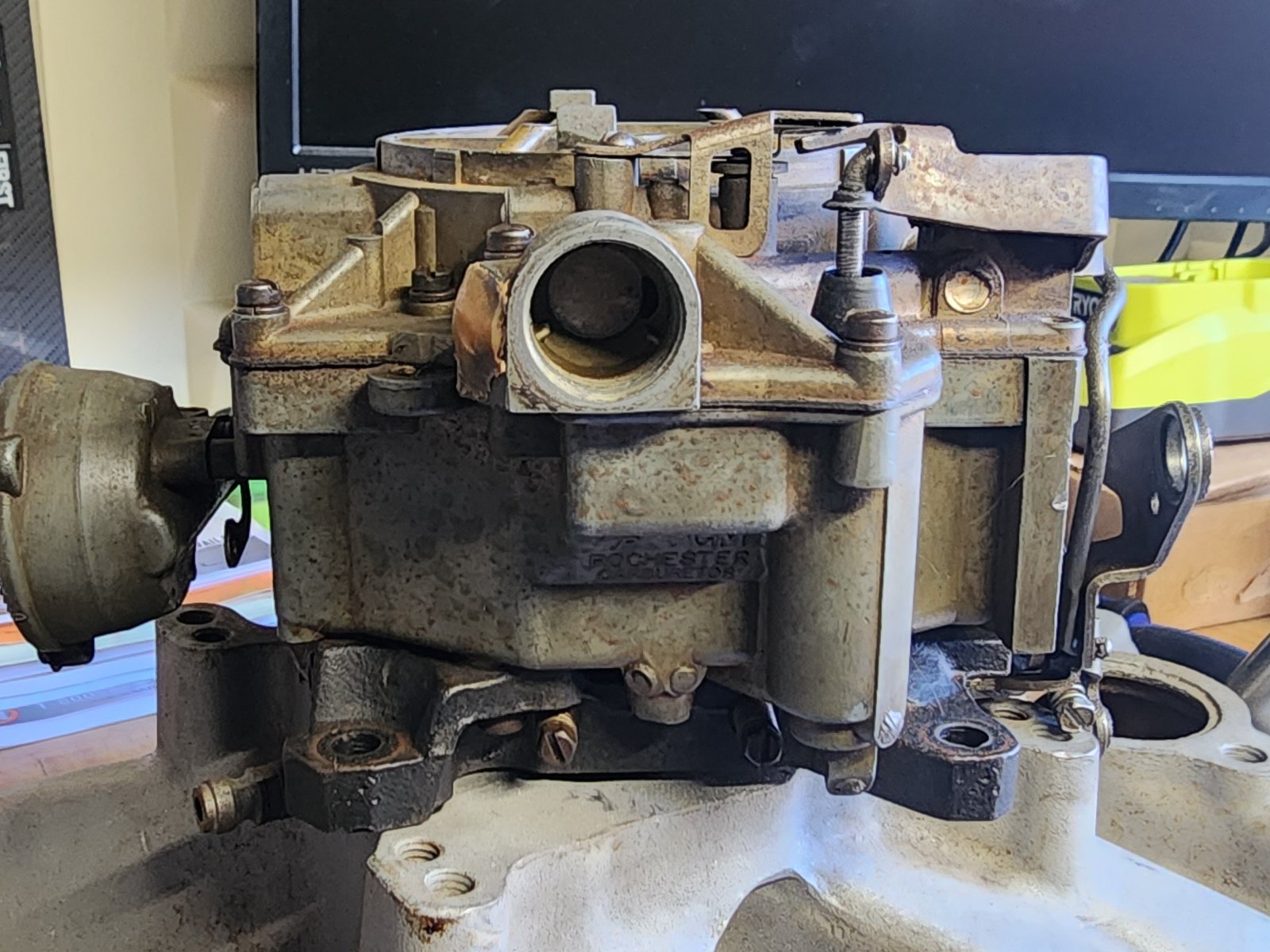

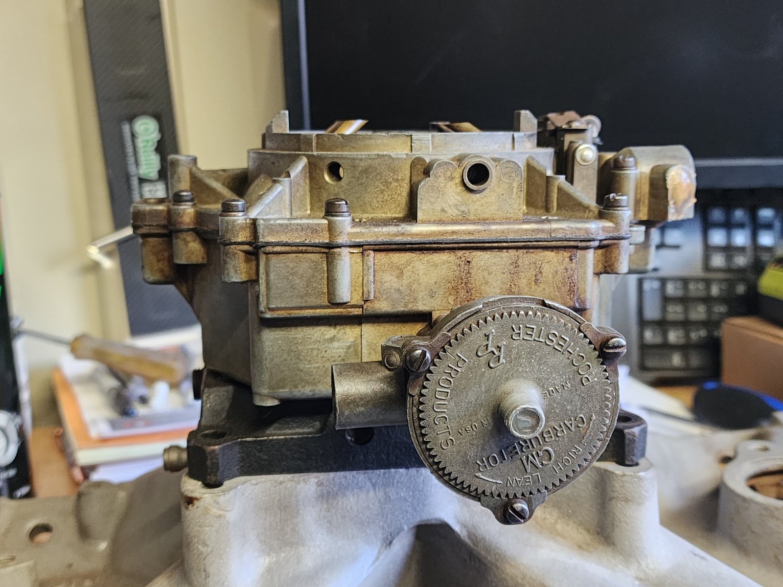

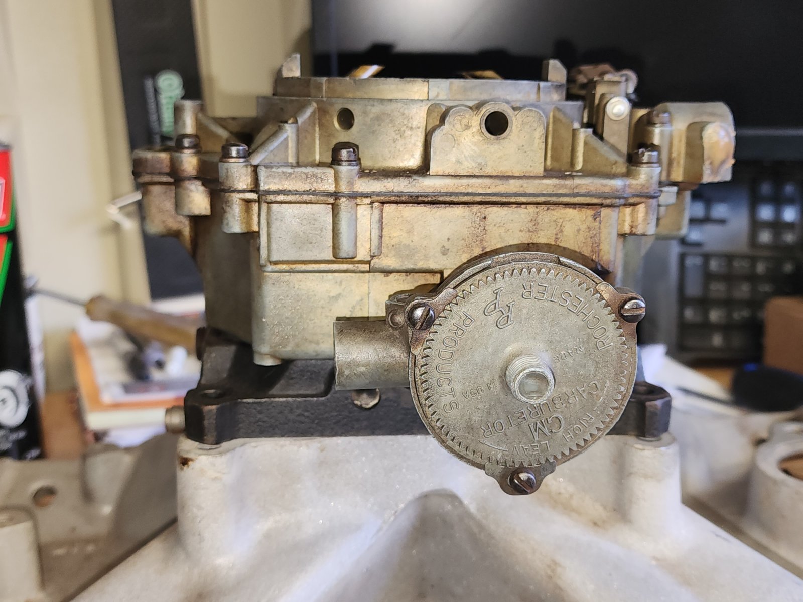

    So I picked up a old Edelbrock manifold and carb at the swapmeet for dirt cheap. I have been looking for a old manifold with oil filler tube.

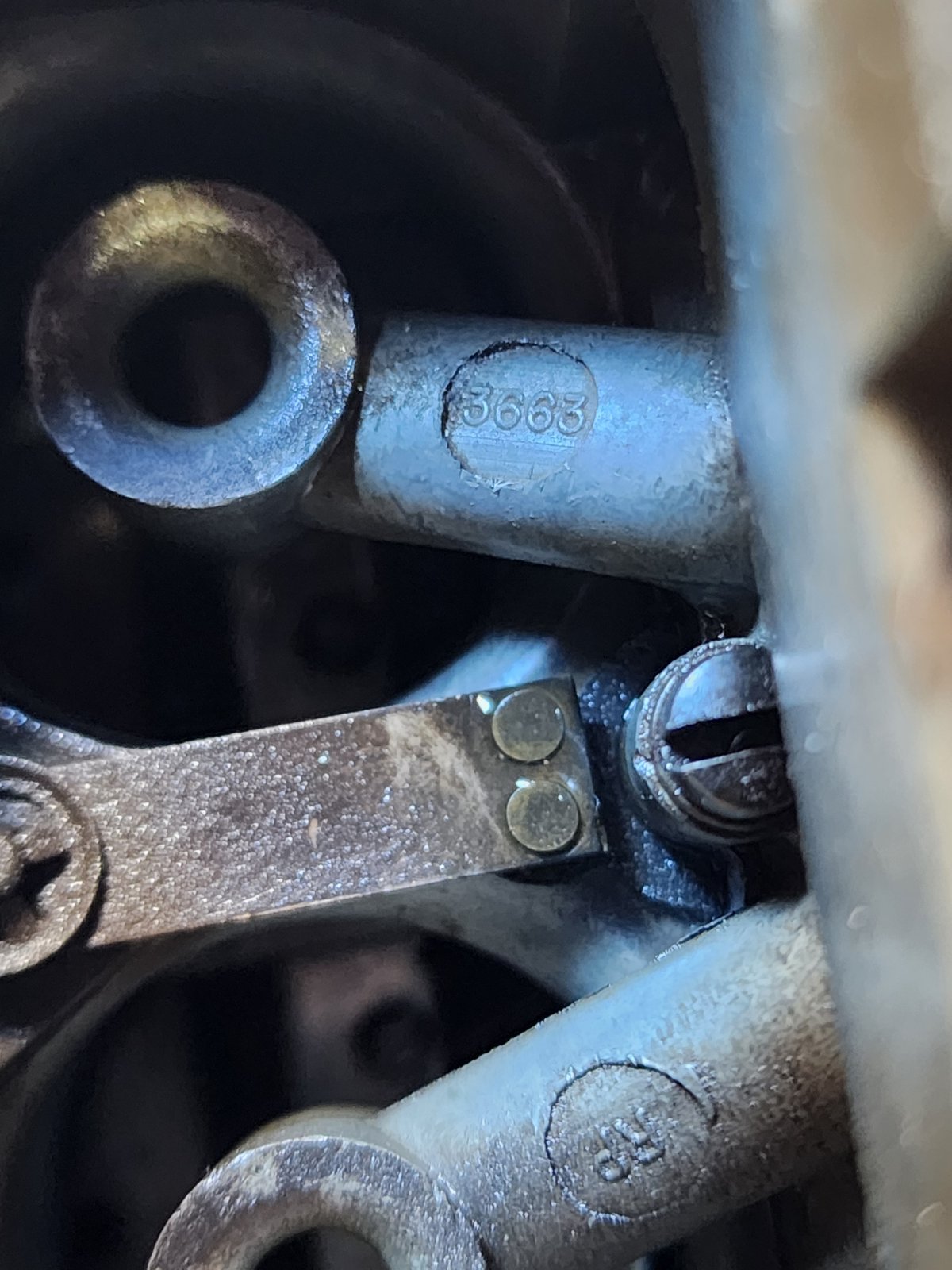

    I can not find any marking to identify this carb other then Rochester 4 jet and 3663 in the intake any ideas?
  2. squirrel
    Joined: Sep 23, 2004
    Posts: 60,002
    squirrel
    It looks like an early-mid 60s Chevy 4GC. It's also missing the choke shaft and ****erfly and ***ociated linkage.
    The tag that was under one of the screws holding the air horn on, was how you identified the carb. But the tag, like most, is long gone. That makes it challenging.

    well, gets me closer to finding out, at least its just choke stuff missing, i live in Arizona dont need no stinking choke ;)

    The chevy parts book shows the 4GC was first used by them in 1956. It's been around for a while.

    Well that's a little disappointing, I got the low 2nd one... I don't think that sill run well on my sbc400.

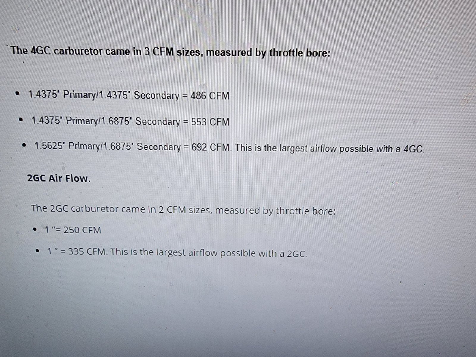

    Do the throttle bores measure 1 7/16, or 1 9/16; hard to tell from a picture, but looks like the larger measurement.

    The Rochester 4-GC is a great carb, if you don't need more than 700 CFM. In the hands of someone who understands them, they can be modified to run as well as anything else up to their CFM limit.

    It's definitely Chevrolet. They moved the choke housing from the air horn down to the main body in '59, and I think that they went from two bowl vents to four later than that. It could be from either a 283 or a 250 hp 327.

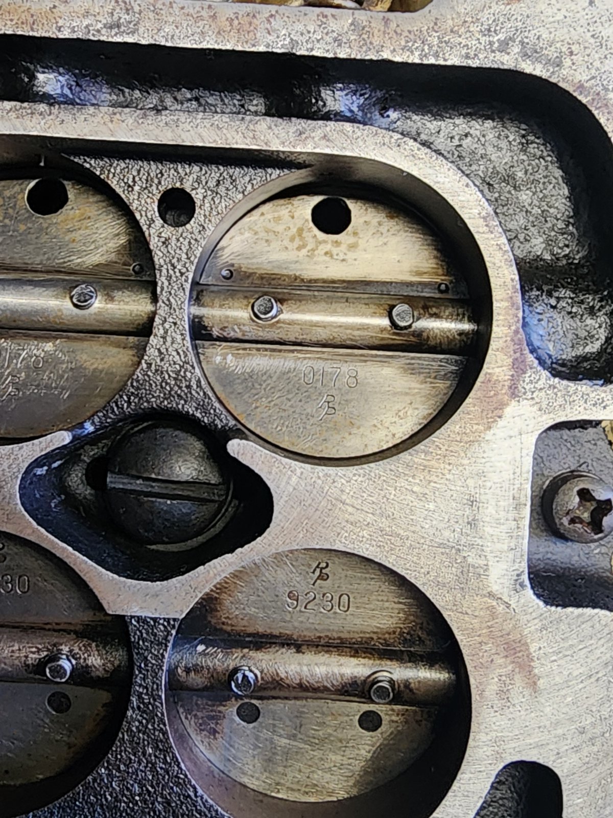

    With the missing choke parts and drilled throttle blades I would not put any effort into it for a street application.

    OOoooo! Good eye, there! I missed that detail. Even looks like the secondaries were drilled too. Though I'm not quite sure why . . . :confused:

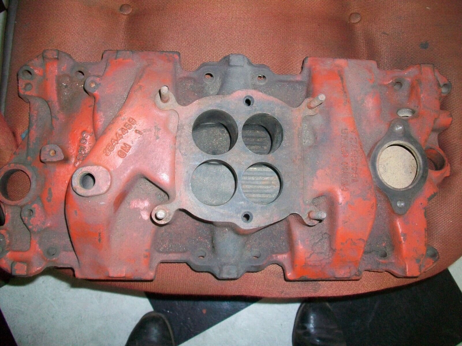

    That carb fit the 300 hp 327 intake I used to have that ended up on several engines I had over the years.
    This isn't the intake I had but a 64 327 300 hp intake listed on Ebay that that carb was originally designed to go on.
    That is as close as I can come to and ID on the carb.
    Up date here, I should have remembered but in the 62 327 thread some info came up and I came up with some.
    On a 250 Hp 327 with that style of carb (300 hp had an AFB) the primaries were 1.4375 and the secondaries were 1.4375. the AFB on the 300 hp had 1.5625 Primaries and 1.6875 secondaries.

    i didnt notice that until now, well... lucky i know a carb guy who has over 500 carb cores laying around he might have one

    The 300hp 327 manifold was originally designed for a Carter AFB but yes the 4GC will work on it.

    Don't know for sure but this GM carb looks later 60's or 1970's. Usually there was a metal small ID tag that was attached to a top screw on the top half of the carb. (If it was 60's) That tag was the carb piece number.
    There weren't actual ID numbers stamped om carb body, as you can see.
    Later the carb number was stamped on side of carb.

    Some of the 4-GC carbs DID have PART of the identification number stamped:
    https://www.thecarburetorshop.com/Carburetor_ID_Rochester_4G.htm
    The one pictured in this thread does not.

    Yes, I've seen 4GCs from the 1954-58 vintage with the last four digits of the I.D. number stamped in the top, towards the rear.

    Throttle bore diameter and the actual throttle arm are probably the only way to ID it.
    As for getting a kit, most parts houses for that series are a bit generic with two or three gaskets for certain positons such as air horn to body and body to throttle plate in the kit while Carb King would send you a kit that was for the carb on the tag if it had a tag. That mainly means that when you take the carb apart you carefully remove the gaskets and set them to the side so you can match them with the new gaskets to get the correct ones. No sample gasket to go by and it becomes a guessing game of matching puzzle pieces.

  27. Looks like 66 283 PP carb to me, judging by the primary tin horn boosters.
    65 327 /250 had the same size though. The small one on your list.
    I suppose you could tig weld up the holes in the primary side.
