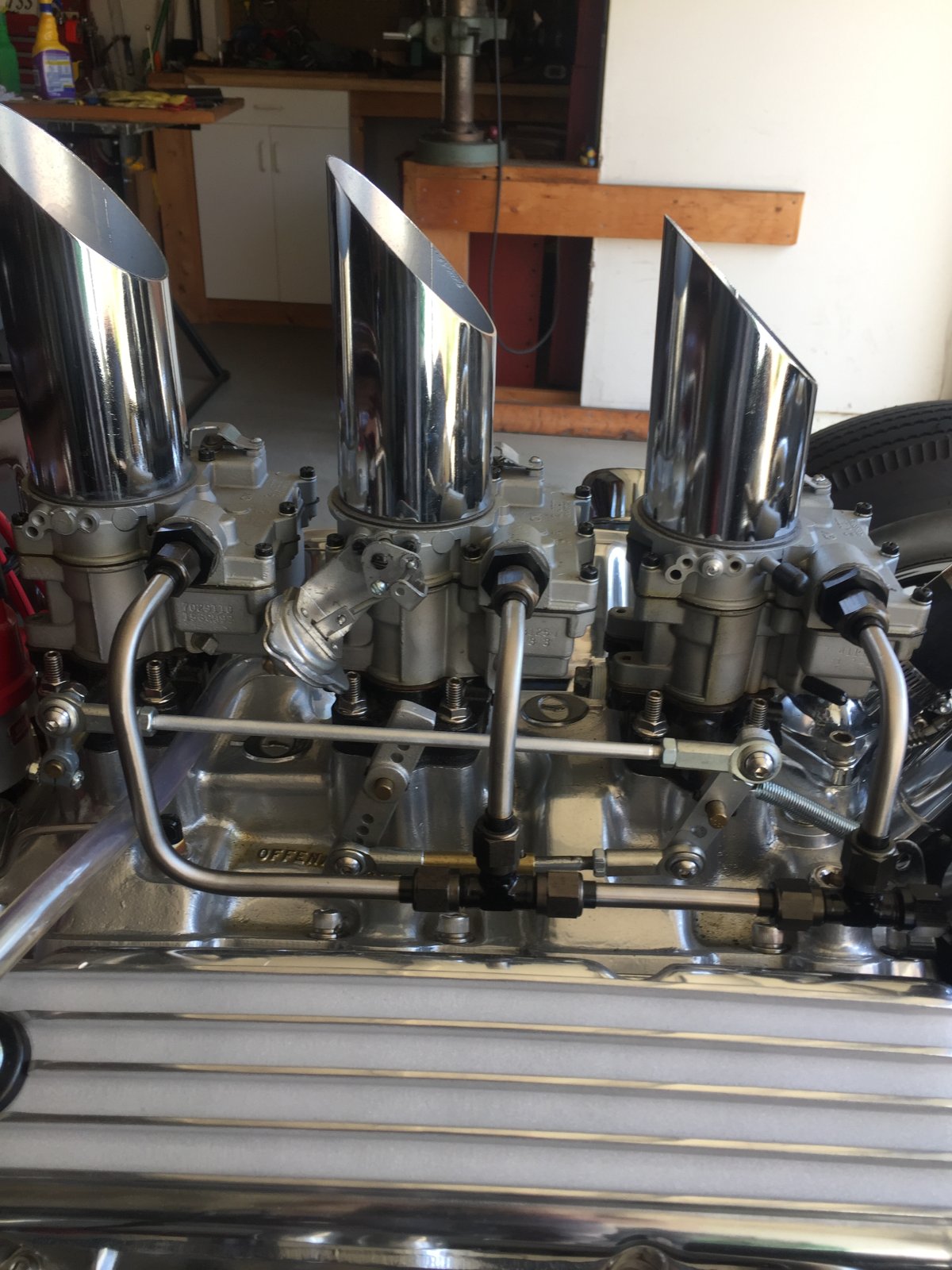

    So because of those cheesy aftermarket linkages I made mine. Works great but it does require another return spring for the secondary carbs. It’s hard to see in the picture but the lower linkage is a br*** tube with a slot milled in it. A rod slide in the br*** tube and you install a roll pin. The slot length is critical as that determines when the secondary’s open as well as closing. The spring and roll pin pull them closed.

    Your setup has both primary/secondary, and secondary rods running parallel to each other which eliminates the rotation of parts. I like this. Based on what I have seen online so far I may have to just think this out and build my own linkage. Thanks Kevin for sharing your setup with me it gives me an idea I can work with.[/quote]

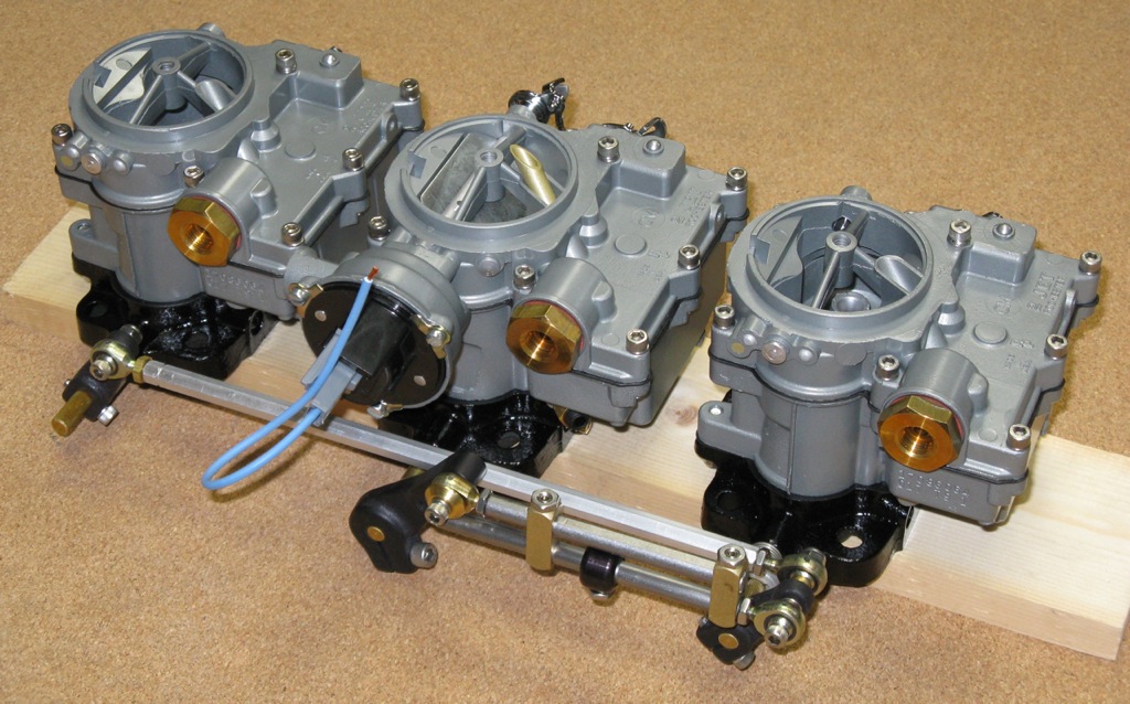

    I have the 2 outer carbs joined on the RHS, 14 years with no issues

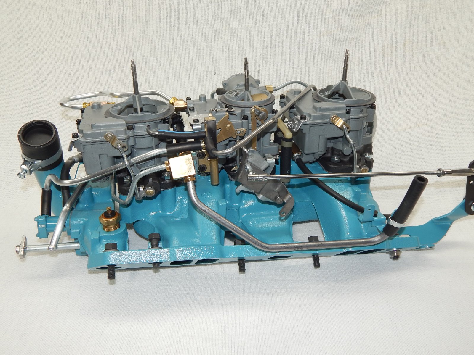

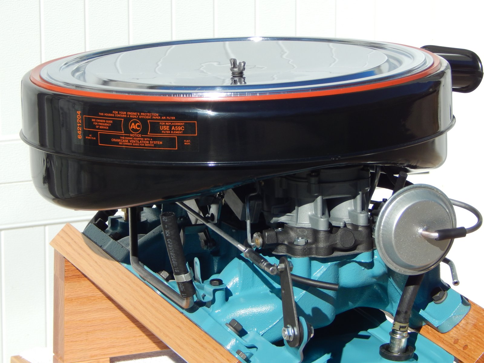

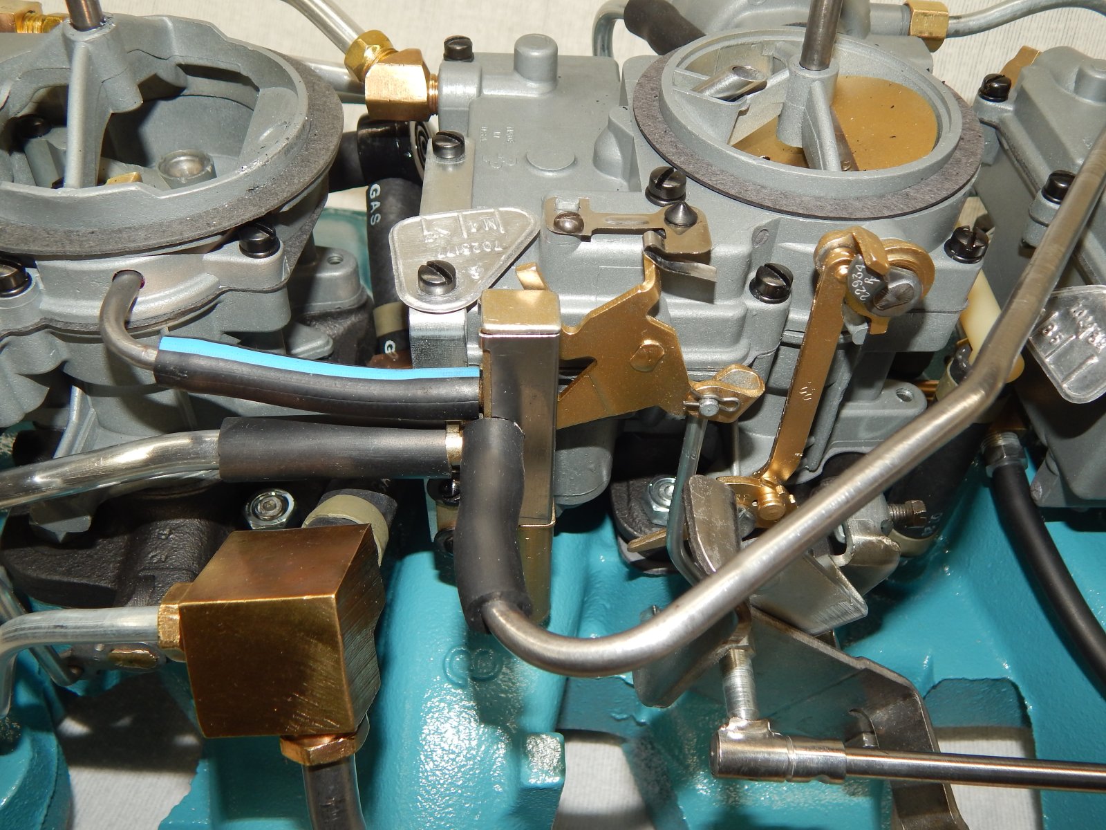

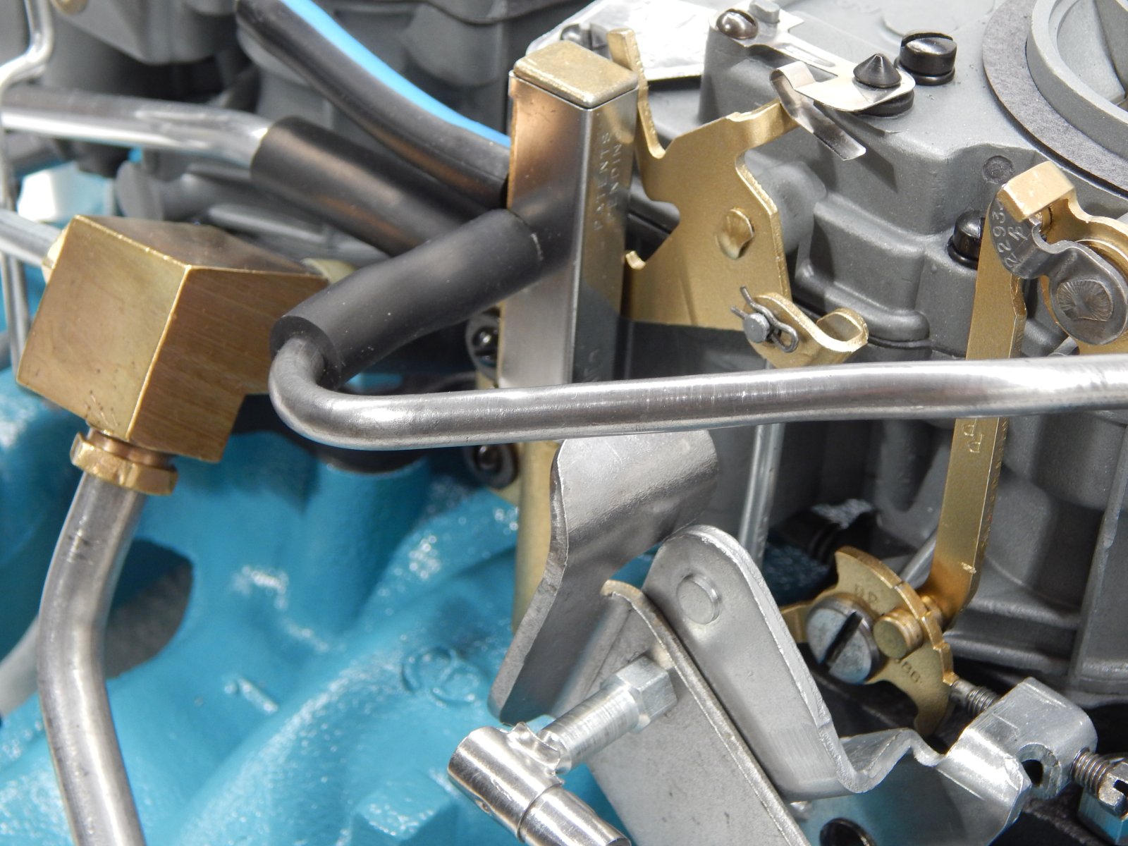

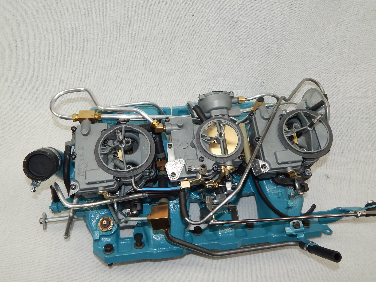

    1965 Pontiac Catalina 389 ci. 338 HP Tri-Power option, automatic transmission. Vacuumfrom the base of the front carburetor goes through a one-way check valve to a T fitting, one leg to the vacuum reservoir, the other to the thermostatic switch. Once the engine is to temp, the switch opens letting vacuum to the Trico vacuum switch on the center carb. The accelerator pump linkage opens and closes the switch, allowing vacuum to the canister on the back carburetor which pulled the ends open. When closing, air is pulled from the top of the front carburetor through the open portion of the switch allowing the canister to relax. It's a slow process and nerve racking waiting for the power to shut down!
    DSCN1079.jpg DSCN1081.jpg DSCN1085.jpg DSCN1095.jpg DSCN1063.jpg DSCN1089.jpg

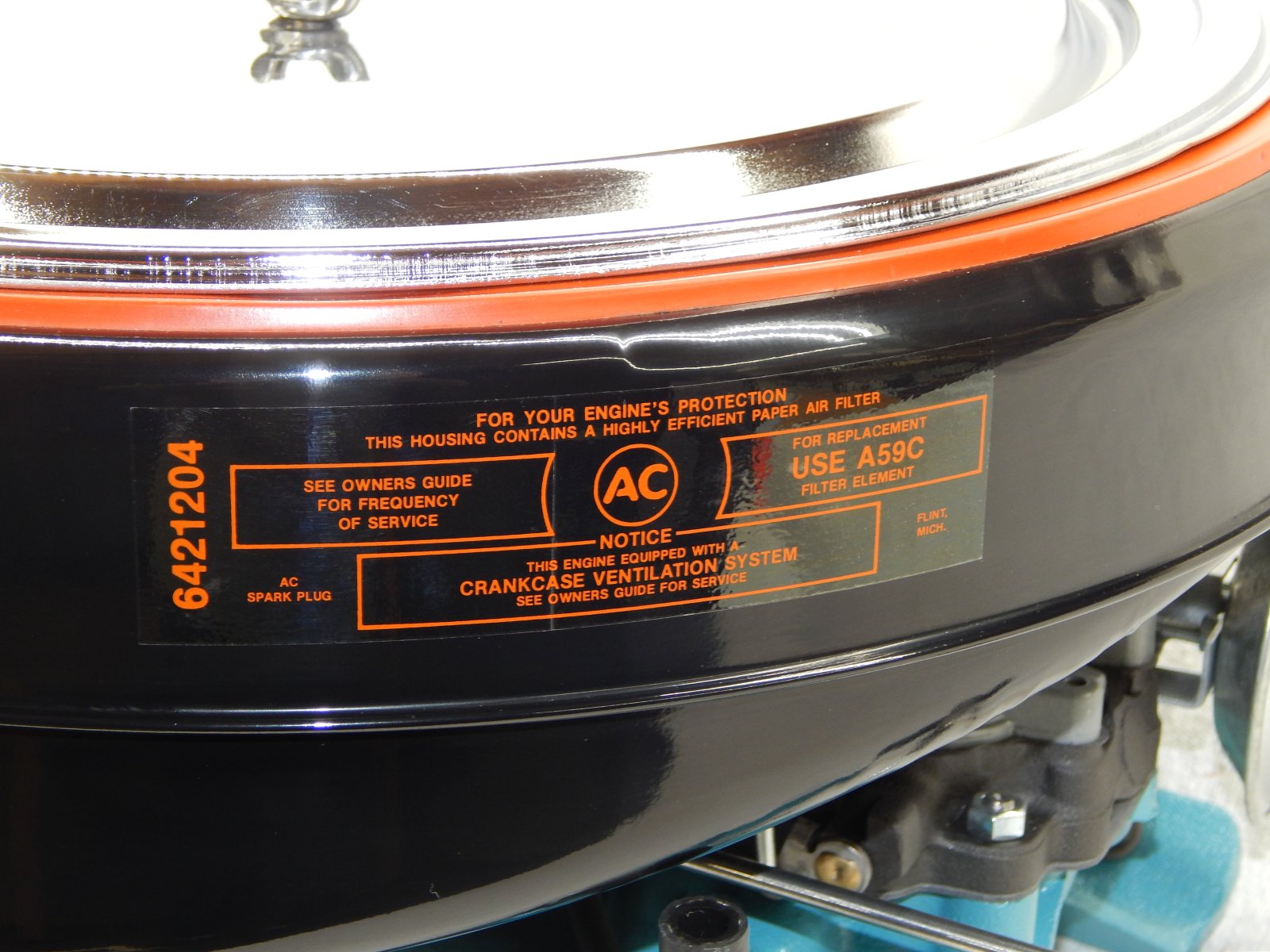

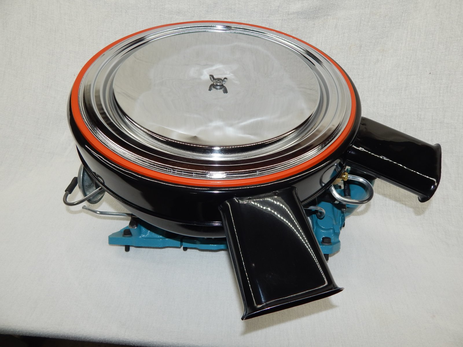

    Too bad the folks that reproduced the tags didn't care about color. If you want to play with it, on that particular configuration only, the front tag is br*** colored, the center black, and the rear burnt orange. Of course the originals were anodized aluminum, but paint will also look nice (top of tag only).
    I was always too frugal to buy the reproduction tags, and made my own. Usually, one can search the supermarket and find either a soft drink or a not so soft drink packaged in an anodized aluminum can of the correct color.
    How about posting a picture of the driver's side of the air cleaner showing the decal?
    Jon

    It's as close as I could get it, dad purchased a new 1965 Catalina 9 p***enger wagon with the 338HP tri-power engine, automatic and 3.23 rear axle, he won stock eliminator in '65 with it. This is the set off of it, I made new fuel lines and most of the vacuum lines, the originals were a little mangled from being on a lot of different cars we had. We think the 338HP engine is the only one to get a factory chrome air cleaner lid, it had painted valve covers. The 421's had chrome valve covers and three air cleaners. I have seen where less then 1300 engines were sold with this option.
    This also shows how much was involved in the vacuum systems, the mechanical ones were much cleaner looking. They were all vacuum from '57 to '64, even the manual transmissions, in '65 and '66 the mechanical linkage was offered on the manual transmission cars only.
