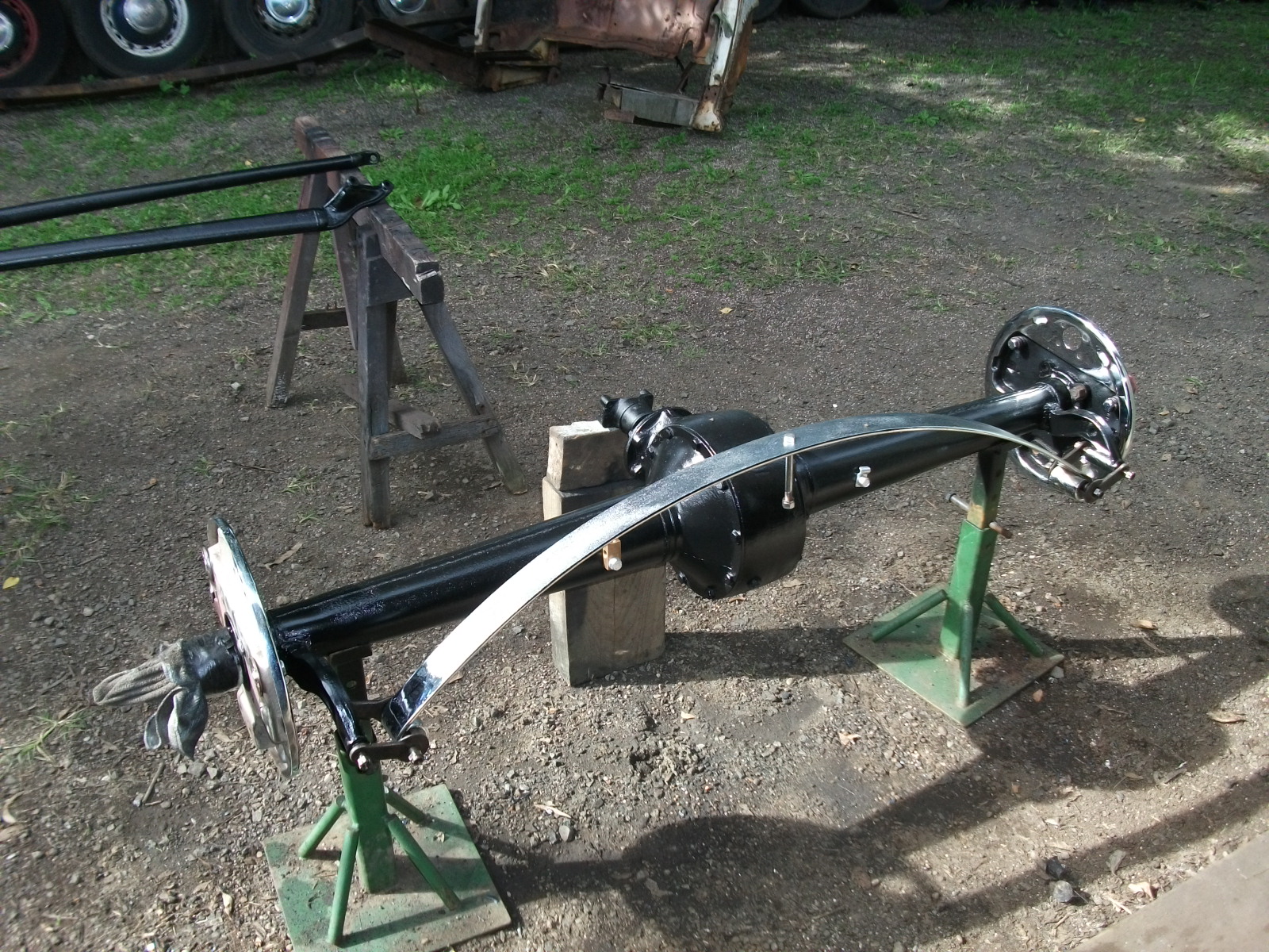

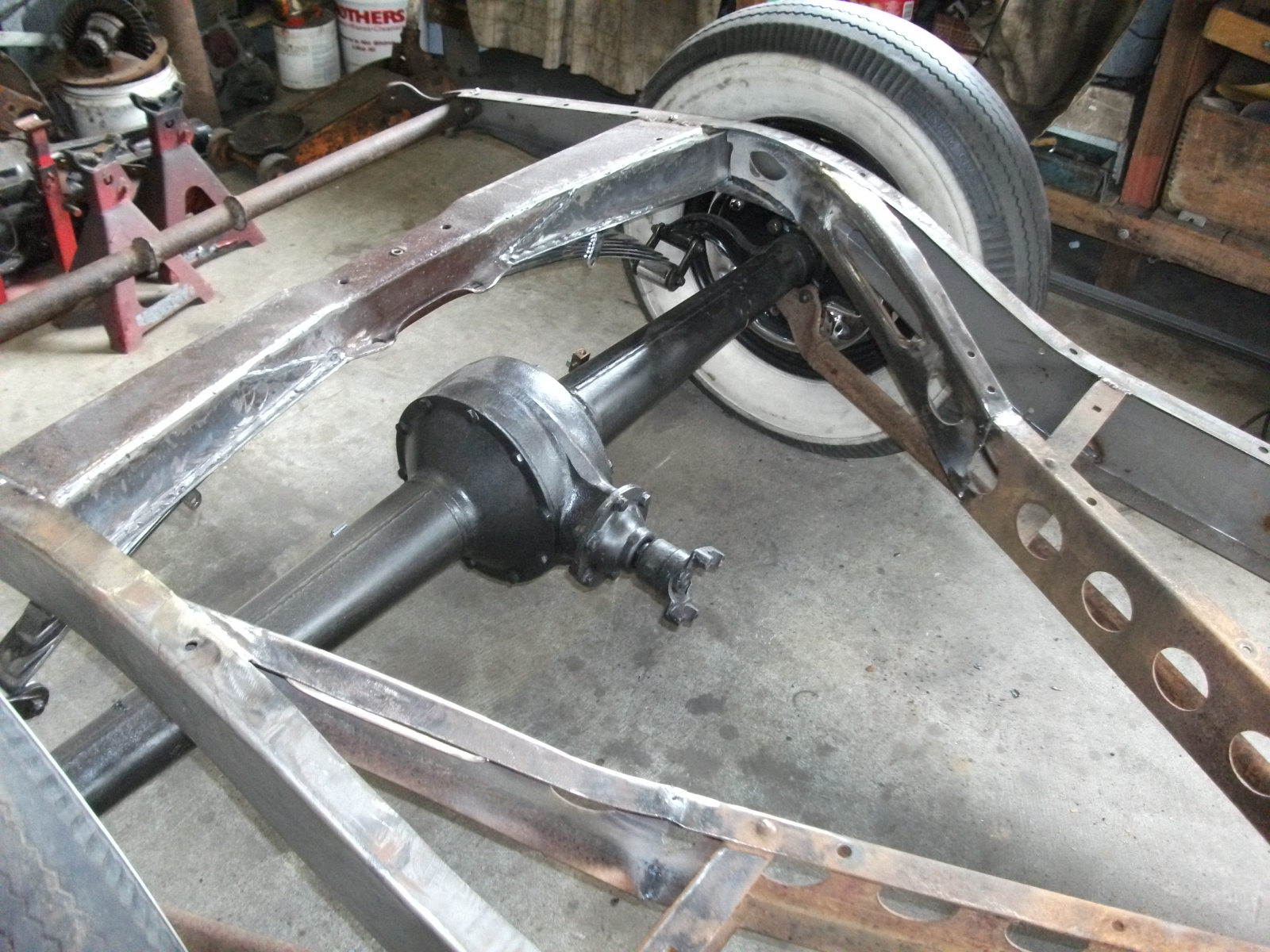

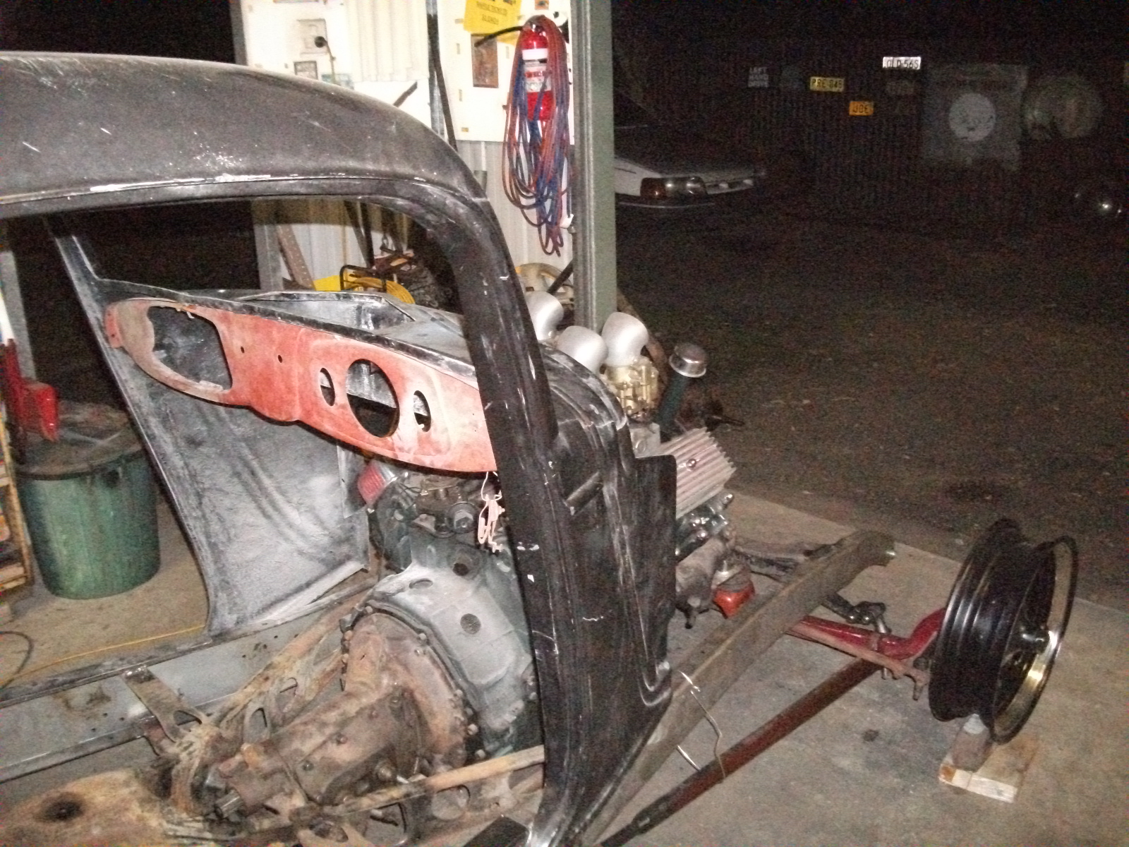

    Here is my latest project : Gl*** '34 3 window, repro rails, '48 "X" member model 150.JPG 149.JPG 158.JPG l "A" front cross member, '36 rear cross member, 303 Olds with '46 Ford open drive trans & column shift, to a '46 open drive rear.

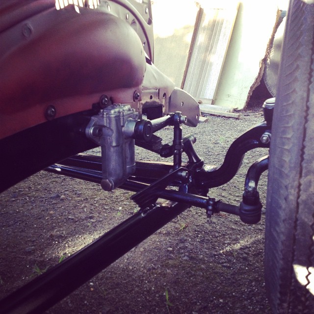

    Forgot to mention '37 Ford steering box tipped on it's side to create push pull steering. Trying to recycle as many gennie early ford parts as possible into this build. . 111.JPG DSCF4962.JPG

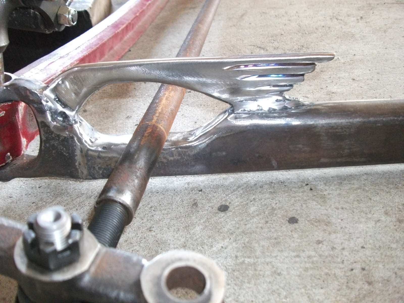

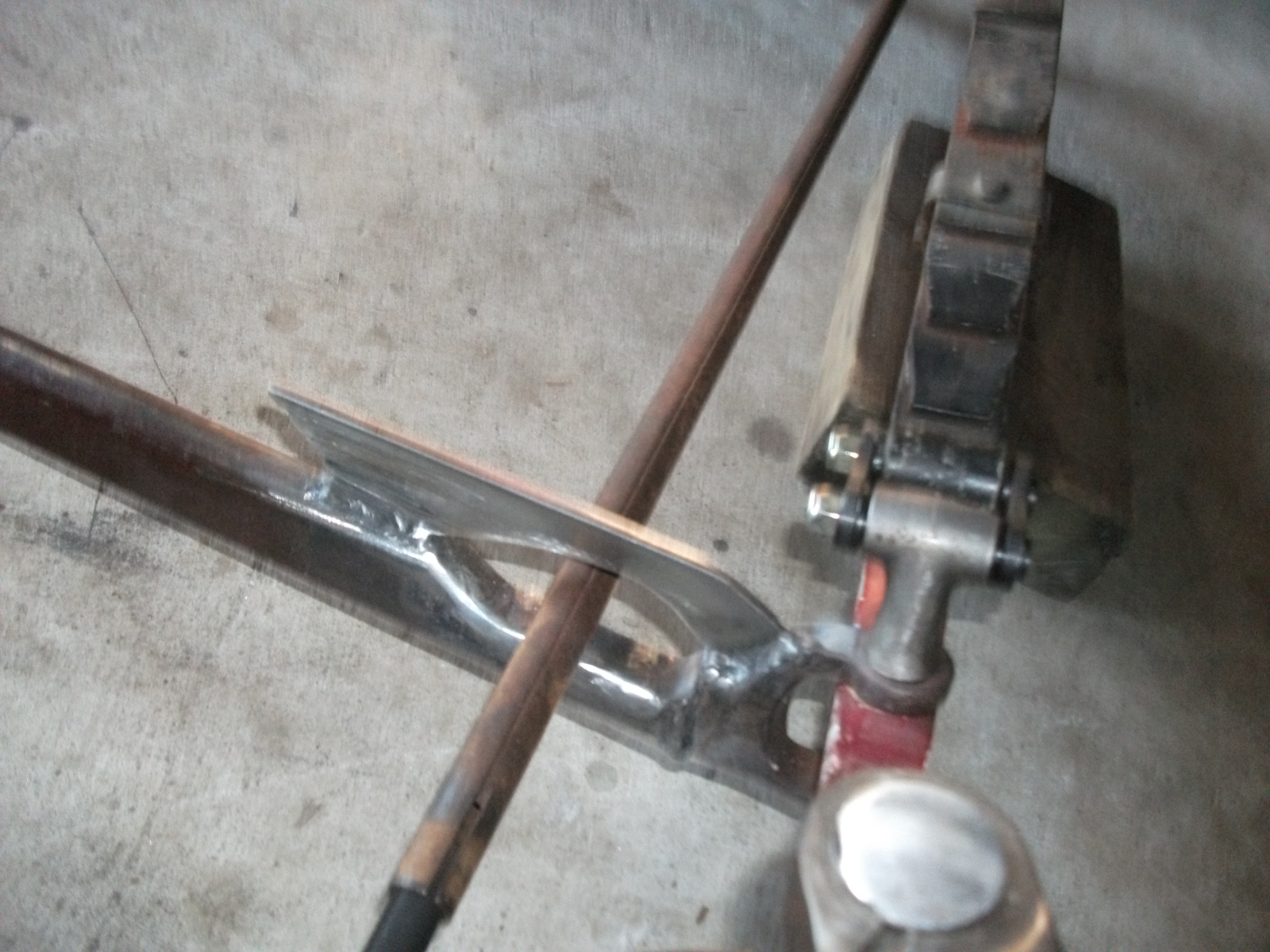

    A little update: My modified wish bones for tie rod clearance. 017.JPG

    '38 Ford steering box tipped on it's side for push pull steering. 004.JPG 004.JPG 005.JPG

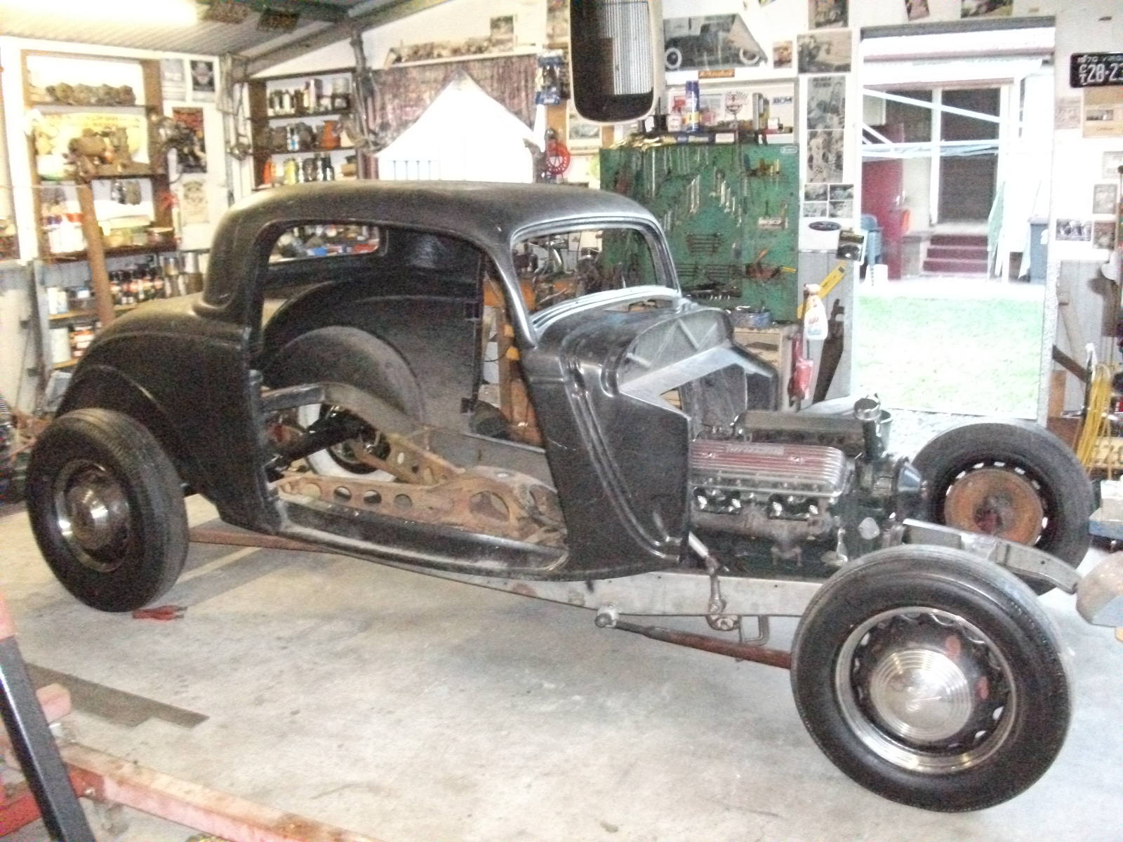

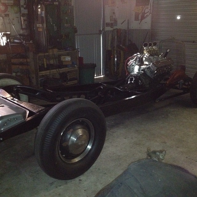

    Been a while since I updated so here goes. Ch***is is now mostly done, time to 10891748_10203844472406170_7024343154657516002_n.jpg start on the body.

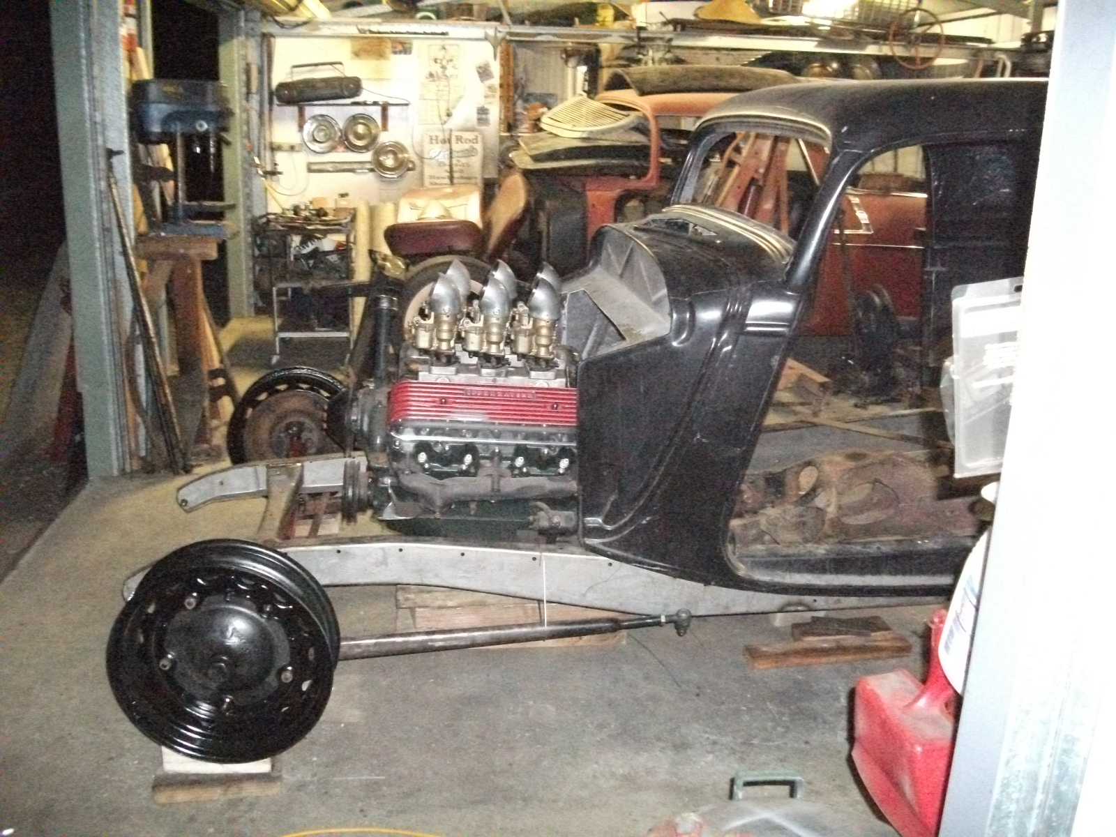

    Why did you change your mind on the 6x2? And what's the make on the 3x2 you're running now?

    Swifty, not sure on the make of the body it come cheap so I got it .Was hoping to have found an affordable steel body by now, LOL. The shocks don't have a brand name on them, but they came of a 50's Morris J van worked out well.
    Martin-F I still haven't decided on what intake I will be using, I have a few options. The 3 two's is an Edelbrock.
    Whodaky, Thanks for the kind words & the kool B&W shots.

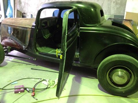

    11079631_891208867568432_7697006437290223894_n.jpg Another update, Doors are swinging body mounted front sheet metal aligned,. Thanks Terry at Camden County Customs. She comes home tomorrow.
