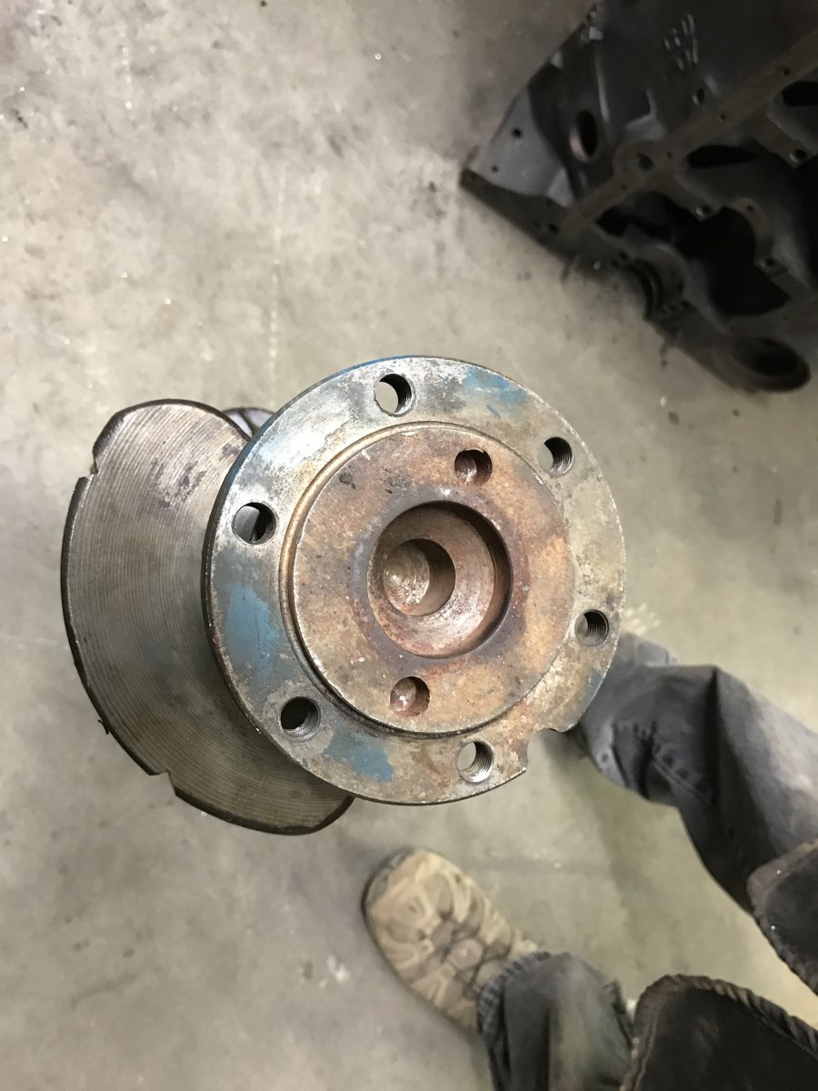

    Now I'm wondering about the old crankshaft/pilot bearing thing. All my stuff is currently at the machine shop so I should let him know pretty soon. Anyone have pictures of the two types of crank flanges. I thought they would be a good addition to this thread. Anyway, I'm pretty sure mine is drilled for the old cast iron Hydramatic (it has a counterbore that looks about 1 1/4"D and about a 5/8" or 3/4"D center hole) but since I've never seen an un-drilled crank I'm not positive. I wonder because I was helping when the Jetaway was removed from this engine a few years ago, not a cast iron hydro.
    I have a B&M Hydro I hope to use, if it doesn't work, I have a rebuilt stock hydro, if that doesn't work I'm also setting up to use a T5. Anything additional needed (crank-wise) to hook up the T5 - like trim the input shaft and make a pilot bearing?

    Here's a picture of my '56 Olds crank flange. Anyone have pictures of the other variations they can post?
    I still need to know what I need to do to run the T5 behind the old Olds.....

    Your crank is drilled for a pilot bushing, the Hydro also requires a pilot bushing. If you decide to run the T-5 you may have to make a correct pilot bushing or perhaps Tony @ Ross racing will have one. If you end up making one make sure you use oilite bronze because it self lubricating.
    bchctybob and loudbang like this.

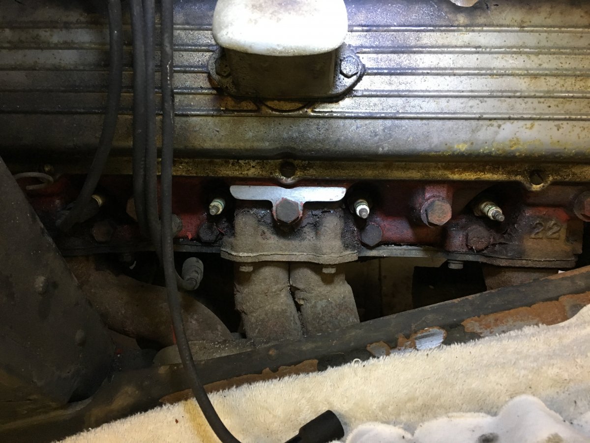

    I have a few questions for the Oldsmobile experts on this board. The 34 Chevy I Purchased has a Oldsmobile engine in it, block #577476-4 1/8 with #22 heads. On the list of head numbers in this thread they jump right by the #22 head. Does anybody have any information on that head? Also is there anyway to tell what year the engine is?
    Thanks
    Pat

    What is the stamped number on the small pad above the center exhaust ports?
    Looks like a '62 394
    For what it's worth the Starfire engines were red

    IMG_9976.JPG Nothing is stamped on the pad above the center exhaust ports

    Check the other side

    IMG_9979.JPG No numbers on either side At the center pad

    interesting,
    what is the date code at the rear of the block near where you found the casting number?

    Engine number # located under the distributor
    245
    CFD
    577476-4 1/8
    1
    Bowtie Coupe and loudbang like this.

    That engine was probably a G.M. factory replacement , they did not stamp those as they were purchased over the counter. I ran into the same thing when I restored the Olds engine for the Orange Crate. Bob Tindle had purchased the engine new fron the Olds dealership in 1960. It also had no I.D. stampings.

    Block cast 1962, 45th week

    So, to recap, Keepat's engine, based on the date code, wud have been built in Nov '62 for the '63 model year. If the red paint was factory, it wud be a Starfire, high compression, 4 barrel, 394ci, 345hp engine. Correct?

    I believe it's a '62 394.
    All the '63 and '64 394s I've seen had aluminum water pump housings and #23 heads.

    Correct 63/64 had aluminum timing cover. 62 and earlier had the cast iron cover
