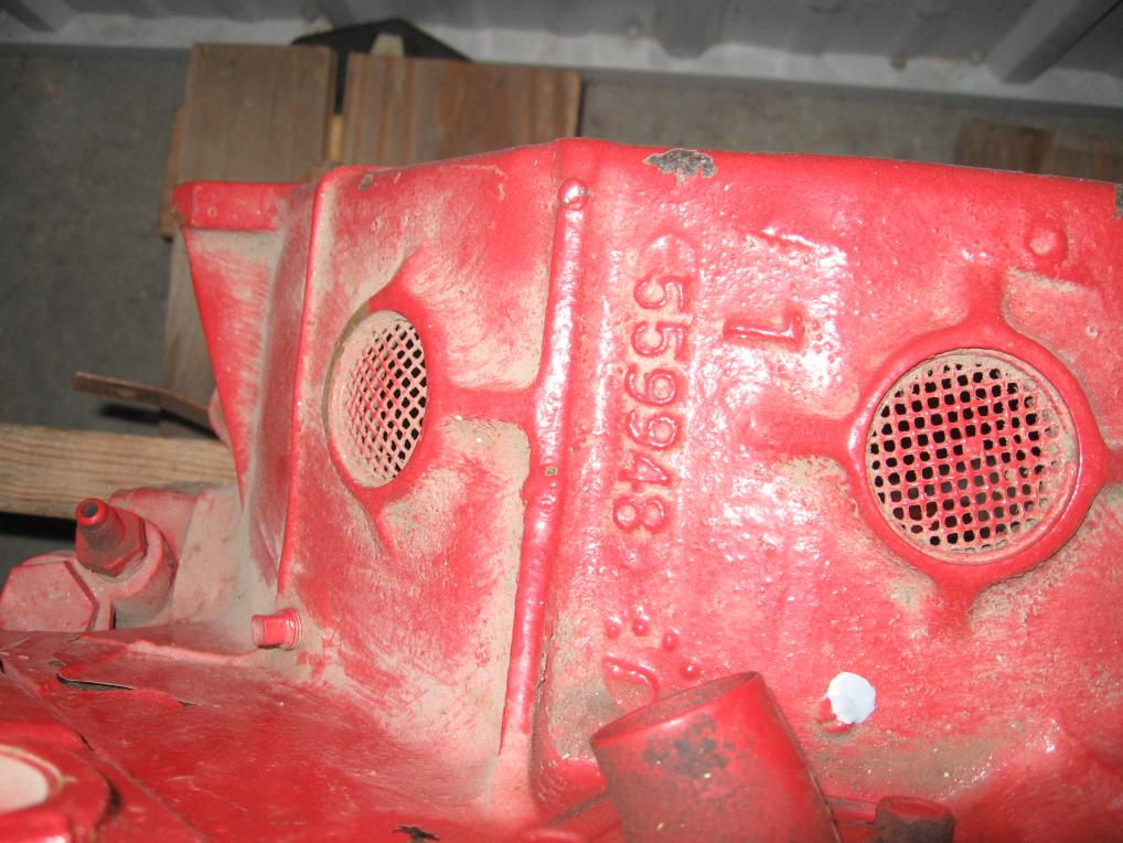

    I was at the shop today. I have to swap the engine of my girlfriends car but took the time to shot a few pics of the 394 and the 303. The 394 has #18 heads. So 1959 or 1960. Does someone know how much HP it is making? Behind the distributor there is only a 2. The 303 has a 321.
    The 303 has a 321. Could that mean 21th week in 1953?

    What you are calling a 394 is a '59 or '60 371-240 hp out of a Dynamic 88, I see the stamped prefix "C"
    If you clean off the back of the block where the numbers are you should see a large number 4, for a 4" bore.
    394s have a 4 1/8 casting number.
    the three digit date numbers will pinpoint the week and year of casting.
    Your 303 was cast 32nd week of '51

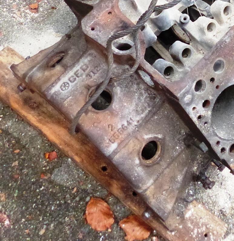

    I took some more pics of the naked blocks and the 371 today. Not sure about the 3 digit number behind the dist. hole. When I showed the pics of the hopped up 303 to Tony, he said that the dist. clamp with two holes is 1949 and one year only. Look what 3 digit number the block shows:
    Here are the cleaned section of the 303 with the #3 heads. Would really wondering me if they changed the heads on this one. If Paul is right it is a 1951 block with 1953 heads. Am I right?!

    So the whole three digit date code thing just got thrown out the window.
    that ****s.
    as for the two bolt distributor hold down, yes for the 1949
    but I have had at least one 1950 stamped block that had the two bolt holes.
    must have been a carry over.
    and yes the large number 4 is for a four inch bore on the 371

    I found the numbers on my 303 blocks last saturday.
    So the R539878 is a 1953 block and it came with #3 heads.
    Interesting is that the 8A526608H is a 1950 block and that is the one with the two bolt holes for the distributor clamp. As Paul mentioned earlier there are some blocks from 1950 with two holes.
