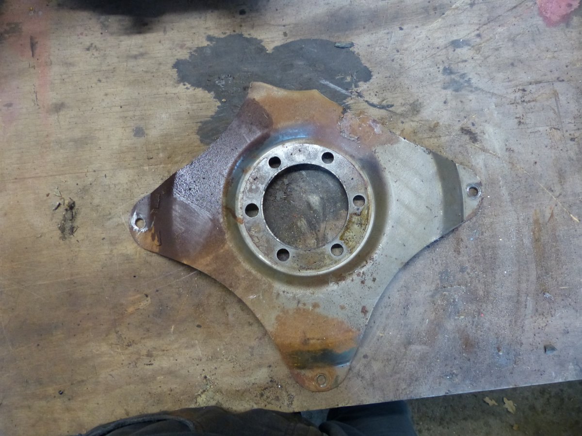

    Does someone know what kind of screws I'll need to mount my jetaway to the block? How many and what size? I think I will have to organize them over here.
  5. Godsmobile
    Joined: Mar 4, 2016
    Posts: 83
    Godsmobile
    I really need a flexplate now to mount everything to my car. Does someone have a 1956 Jetaway flexplate for sale? Please contact me!

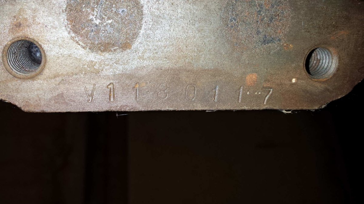

  8. senginc
    Joined: Jul 18, 2009
    Posts: 364
    senginc
    from B'ham, AL

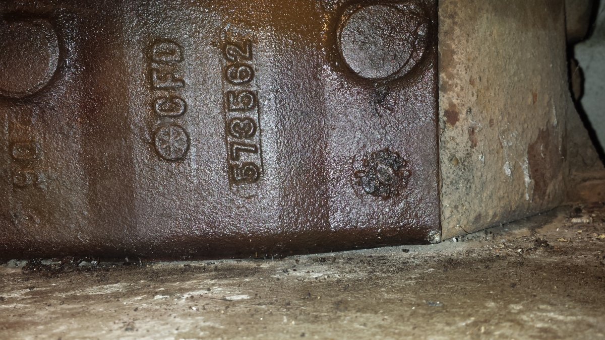

    Some pics of engines I am unsure of. Have a about 10 blocks, heads, cranks 303 to 394.
    Anyone who can help ?
  9. vtwhead
    Joined: Oct 20, 2008
    Posts: 5,304
    vtwhead
    here are the engine tab numbers that will help
    1949--8A1001 TO 8A193864 H PREFIX=HYDRA MATIC
    1950--8A194001 TO 8A568689 H PREFIX= HYDRA MATIC
    1951--8C1001 TO 8C287312 B PREFIX= SYNCHROMESH
    1952--8R1001 TO 8R214478
    1953--R215001 TO R549482
    1954--V1001 TO V355083
    1955--V400001 TO V983275
    1956--A001001 TO A385513
    your A207 block is most likely a '56 and should have #10 heads
    senginc and loudbang like this.

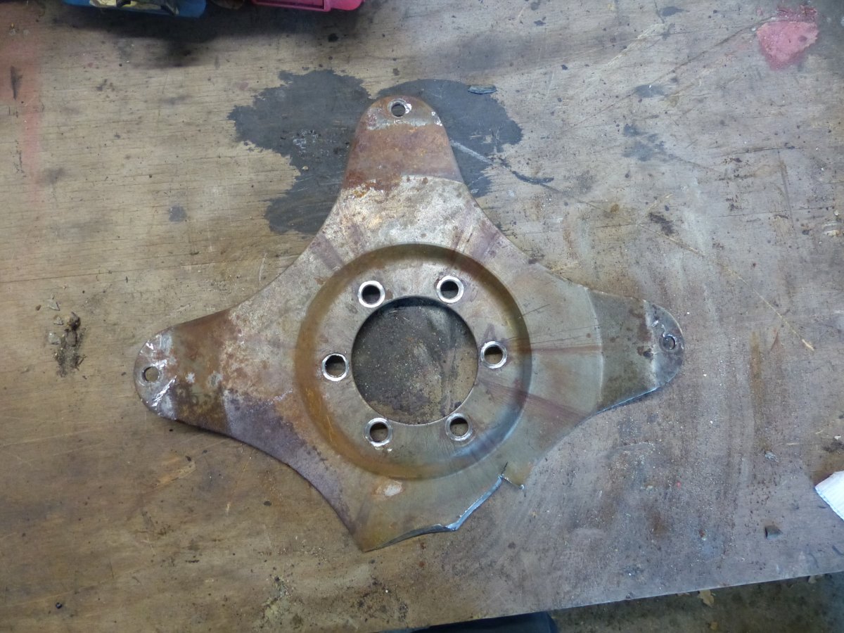

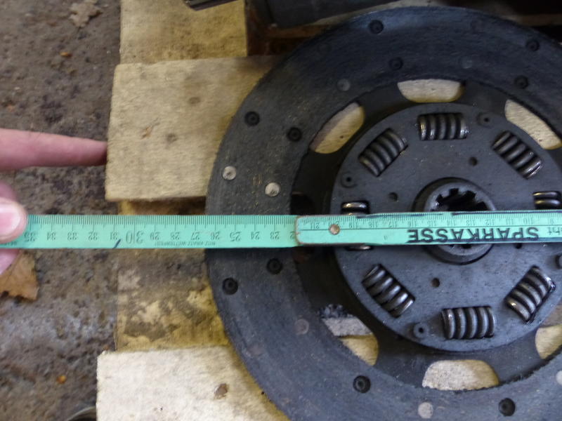

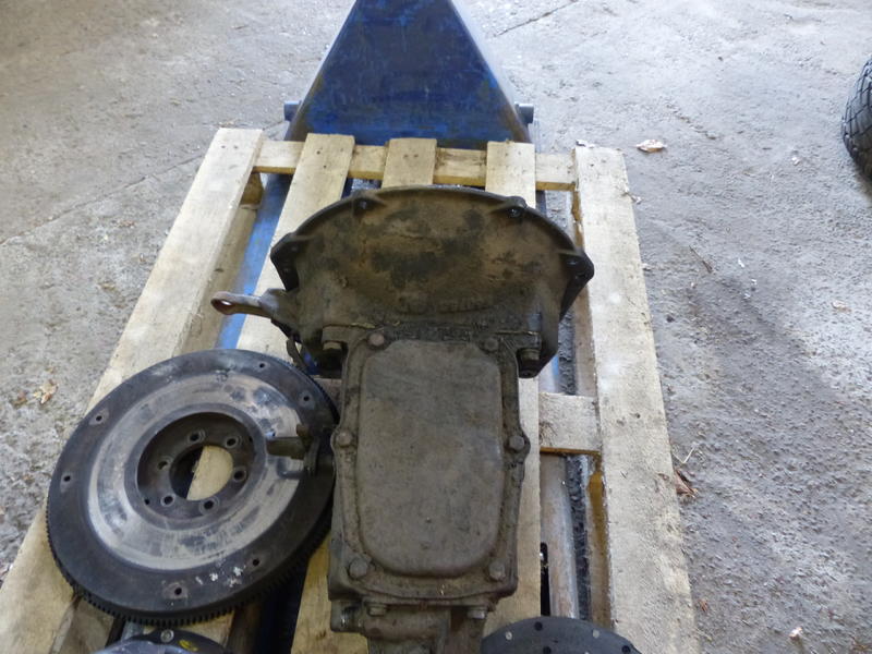

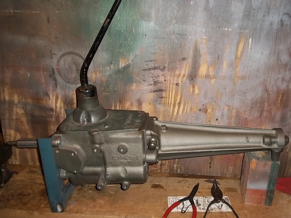

    Hey guys, I need your help as usual. I scored the 3speed that was mounted behind my 371 a few weeks ago. The clutch and flywheel looks really bad. What kind of clutch did they use in 1959 in those setup and could I buy a Chevy 1959 clutch at rockauto since nothing is advertised for 1959 Olds manual trans?
    Plan is to resurface the flywheel on a lathe and if it is possible, use a 11 Inch Clutch from a chevy.
    Like one of those (maybe the 11" sachs):
    https://www.rockauto.com/de/catalog...ransmission-manual,clutch+friction+disc,10605
    Here are pics of what I have here:
    10,5 inch clutch
    Probably 1,125 Inch inner diameter with 10 tooth
    I don't know how you call that part of the clutch ***y. Wondering if those closed holes are part of the externally balancing?!
    And the bad cracked surface of my flywheel.
    Is it a kind of GM standard transmission?
    [​IMG] [​IMG]
    How about the possibilties to use a floor shifter on this thing?
  12. ROADSTER1927
    Joined: Feb 14, 2009
    Posts: 3,285
    ROADSTER1927
    Send your flywheel to an automotive machine shop to be resurfaced. They grind them flat.

    use Centerforce 381040 Clutch Disc (Fits 88-94 F Super Duty)
    or equivalent, ***uming you are using the stock stick transmission.
    check spline diameter and count as well as total diameter.

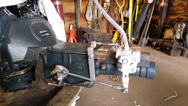

    get the disk and pressure plate rebuilt. might be less $$$$, ???????? The ****** is a selector unit and adapting a floor shift is tricky at best. Even the after market ones from back in the day left a lot to be desired. They are extremely rare.
    I had a selector come in the shop on a trade that had a home built unit attached. I believe Frank @F&J was originally involved in the design. It was never used in a vehicle. It came in on a trade for one of my 37 Buick boxes that had been converted to the Olds gearing.
    This what an Ansen unit looked like back in the day:
    And what the home fab job looks like:
    And for the record what a 37 Buick conversion looks like:
    This ****** has the long tail stock from an Olds 98.
    As far as the flywheel is concerned I would machine it as they are also very hard to find. It should be an externally balanced unit. usually you can tell from looking at the rear of the unit like this one:

    Paul, since I can't found the Centerfold clutch disk I searched for equivalent parts on rockauto and summit. I found a clutch kit from summit with:
    Input Spline Quan***y: 10
    Input Shaft Diameter: 1.250 in.
    Disc Diameter (in): 11.063 in.
    Disc Diameter (mm): 281mm
    The disc diameter is round about 1 mm above the total dia of my pressure plate. if I'm going to reuse the old pressure plate, will this be a problem?
    The most of the other clutch disks I found are 12 inch (rockauto).
    The other specs above sounds like it should work in my case.
    If I'm buying the clutch kit for a F250, will the pressure plate bolt right onto my original flywheel or do I have to reuse the original pressure plate or drill new bolt holes in the flywheel?
