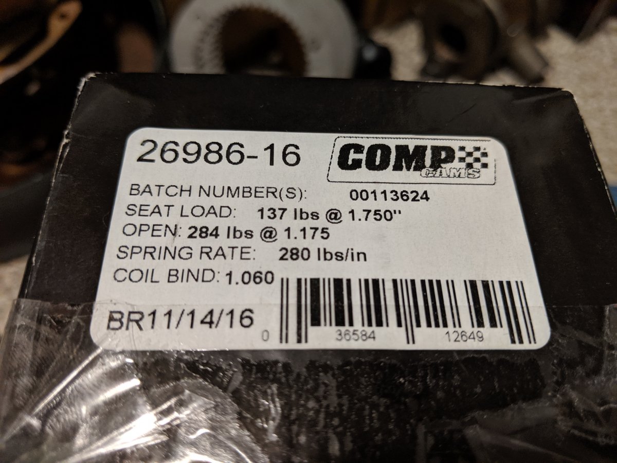

    I picked up a set of barely used Comp 26986 beehive valve springs today. Think they will work on the 56 Olds heads with a couple modifications. They're the same free height as a factory 371 beehive spring. About .2 smaller ID at the bottom/big end and about .07 smaller ID at the top. If I use the right Comp retainers I should just maybe have to modify the seat where they sit in the head.
    371 stock left. Comp 26986 right.
    Specs on the 26986

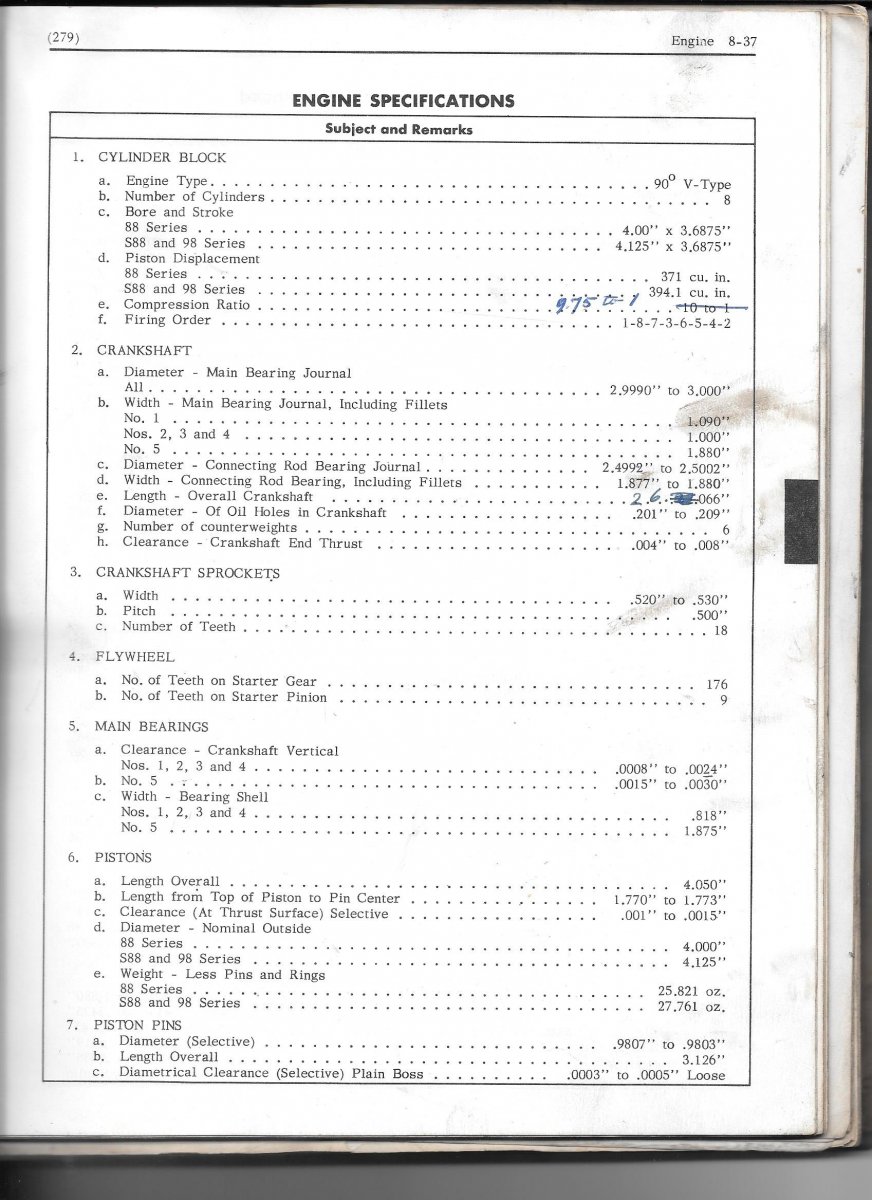

    I recently dis***embled my 1959 371 to check everything and have the crank balanced for mating the engine to an earlier Jetaway later. Can someone give me the standard dia on main and rod journals on the crank and how much of clearence I should aim for please. Will see what kind of work will be needed additionally to the crank.
    Deuces and loudbang like this.
  9. Paul
    Joined: Aug 29, 2002
    Posts: 17,208
    Paul
    Editor
    from 1959 Oldsmobile Service Manual

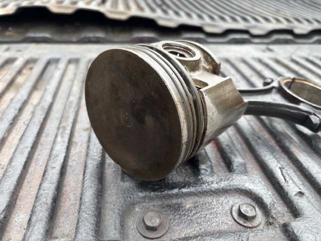

    I’m tearing into a 303 that I bought and it turns out that it has been bored out to 3.90. Pistons are stamped gm 564490 which the internet says are gen3 5.7 Chevy with 10.1 compression.
    Is this a thing?
    bchctybob, gonzo and jebbesen like this.
  26. 59sedandelivery
    Joined: Sep 5, 2005
    Posts: 184
    59sedandelivery
    That certainly does not look like a GEN 3 SBC looking at the side skirts and the use of the circlip/lockwire/lockring for wrist pin retention... A few more pics please...
    skooch likes this.

    Only other pic I took before install. At the time I wanted some info to help with piston ring search.
