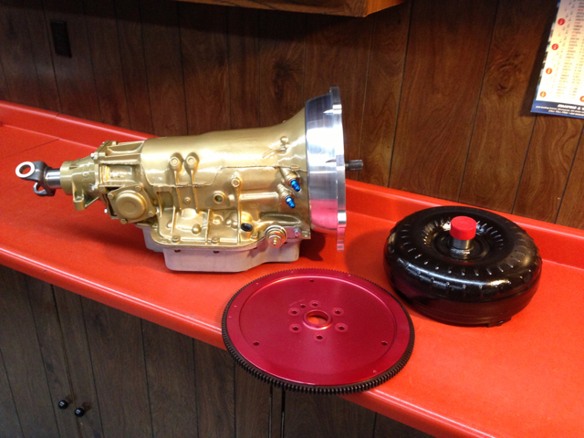

    Our Olds ***emblies bolt in without having to hack the Trans tunnel out of your car as well as Wasting interior space...... A New bell ,flywheel and torque convertor allows it to bolt up direct as simple as a sbc
  11. Are there provisions to mount a starter?
  12. GOATROPER02
    Joined: Mar 22, 2006
    Posts: 2,059
    GOATROPER02
    from OHIO
    Uses a stock lower bell with stock 12v starter or one of my high torque mini starters..... Either way ImageUploadedByH.A.M.B.1435580151.254034.jpg

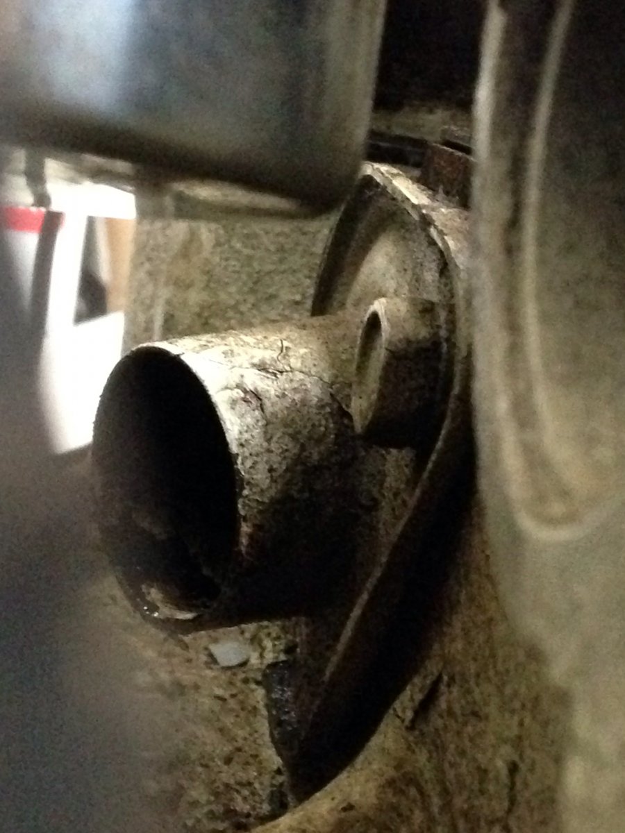

    image.jpg image.jpg This seems to be a good place to ask this question.. what the hell is this for? I'm trying to find my oil pressure location but just wondering what this is? It's a tube coming out of the top and back of the block near the distributor. The tube seems to go into the block a bit.. I have seen this have a fitting and not a tube on other motors but just can't find any info on this... any info would be awesome! Thanks!
  16. Anderson
    Joined: Jan 27, 2003
    Posts: 7,558
    Anderson
    Connects to a road draft tube, pre PCV stuff the let the crank case breathe. You'll find a spot for an oil pressure line on your oil filter adapter.
  17. Smack021488
    Joined: Jan 25, 2011
    Posts: 158
    Smack021488
    from Chicago
    dude thanks so much! I saw that on my oil filter adapter but wasn't sure that was the spot! and I really like your T!
