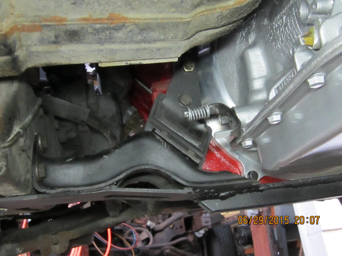

    Tony modified my TH400 to go behind my '64 394 Olds 98
    Not for the faint of heart or inexperienced builder. Whole lot of fabrication involved, but well worth the effort.
    requires different flywheel and in some applications different lower shell and starter motor.
    Check out my build thread for all the details.
    JT

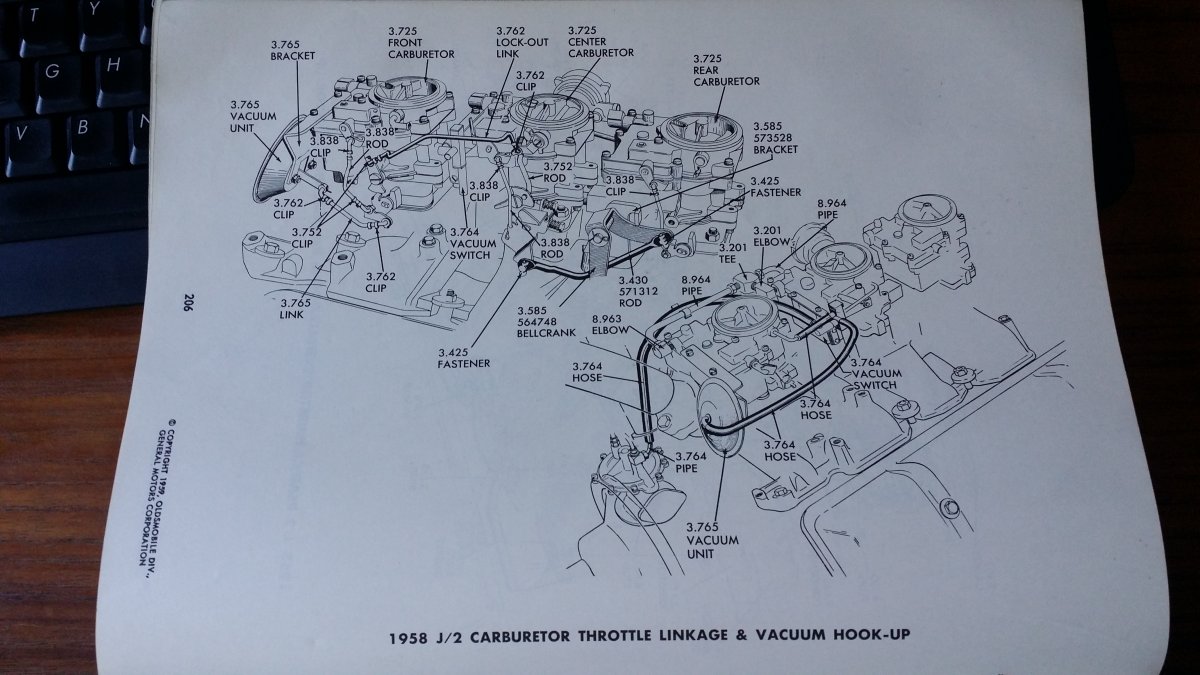

    Always a good idea to get yourself some books, in my library I have shop manuals, supliments and parts books covering most early Olds engines, they get used a lot.

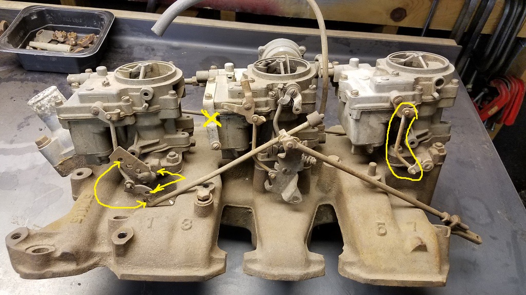

    OK I tried to take a better picture of the linkage but I couldn't get the view I wanted.
    So here we are with some more questions.
    In the circle marked "X" is this some piece of the old vacuum switch ***embly that was also 'left over"?
    Next, the lone red arrow, these bolt holes look like they were enlarged. I was going to see about making up some sleeves to make these more original size. especially since there is one that has a small piece broken off. Good idea?
    In the circle with the "O" on the front carb the welded on piece, when pulled back, does still make the accel pump/squirter move up. Does it do this correctly? That I can't be sure of. That's what I was really trying to get the new picture of.
    Where the lone yellow arrow is on carb #2, the perch that the forward rod moves through is a nut that was welded on the inside of the linkage and the threads removed.
    Here is the real newbie question of the day. Is there some reason I could, or should, not just clean these things up and tie all three carbs into each other? Instead of some progressive setup just have all three open and close together at the same time? I'm putting a 4 speed on the back of the 303 and it's going to be a fun car not a cruiser so gas mileage really isn't a concern. It's not going to be a g***er or just a drag car but there probably won't be too many long highway trips in it either.
    I know you can't please all the people and it is my car but is the J2 really something that should be restored? I'm not sloppy Joe who is going to weld a hunk of metal on the linkage, I try very hard to make my work nice but not kill the original style. But I'm no fan of people who take a nice original car or part and rip it up, some pieces were meant to be restored. Does this thing look good enough, or is it worth enough, that I should put it on a shelf and collect the parts to bring it back to it's original condition?

    I've got a '64 Starfire convertible and have several manuals on that, they do come in very handy. Sounds like it's time to get on the stick and pick up some '49 and '58 manuals and literature.

    I'll take a stab at a couple of your questions.
    First, the "sissors" arm in the "X" circle on the center carb was used on all Rochester tripower center carbs (Cadillac, Chevrolet, Oldsmobile, and Pontiac), although there are several different "sissors" shapes. The off/on vacuum switch control which was attached to the bracket still on the front of the center carburetor fit between the "sissors" and the "sissors" turned the switch off and on.
    No comment on the enlarged holes, your choice.
    The whole mechanical linkage setup looks pretty hokey to me. Whether it will function or not I would not hazard a guess unless I could actually try it. Like I said, looks pretty hokey.
    Now, can you run all three with solid linkage? My GUESS is no, for the following reasons.
    (1) The carbs were originally designed for a 371, and Oldsmobile thought that progressive linkage (vacuum actuated) was necessary on the 371. If you put them on a 303, with progressive, you still may have tuning issues with the center carb, as the venturii air velocity will be lower than original design (due to the smaller displacement).
    (2) The end carbs were designed as "dumper" carbs. They have no idle circuit, and no power circuit. They have only the main and pump circuits. GUESSING that anything other than wide open throttle would deliver a serious A/F ratio imbalance to the cylinders (the four center cylinders will be MUCH RICHER than the four end cylinders.
    Again, the above is a GUESS, based on working on hundreds of tripowers in the last 50 years. Not saying you cannot make it work, but don't think it will be easy.
    Suggestions:
    (1) You know it can be returned to the factory vacuum progressive linkage that will work, but the pieces are not inexpensive.
    (2) If you want mechanical progressive linkage, remove what you have and start over. Some might prefer the hotrod aftermarket linkage of the day, I don't. What I would suggest would be to add the front to rear rod on the p***enger side, and acquire some of the over-the-counter mechanical linkage used by Pontiac on the 1965 and 1966 Pontiac tripowers. It won't work on the J-2 without some adjustments, because Pontiac used large end carbs on the 1965 with a small center; and all large carbs on the 1966. But the pieces you need are in the kit (see the various Pontiac vendors), and can be modified to work with the three small carburetors.
    This link MAY (or may not) be of ***istance:
    http://www.thecarburetorshop.com/Tripowertuning.htm
    The slotted center to rear rod on the Pontiac linkage allows good adjustment for when the secondary carburetors are engaged.
    Jon.
