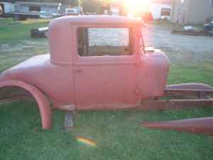

    REALY REALY TRY TO KEEP BOTH !! Heres my 49 rocket and my project 29 chrysler flat head project. Gary:D:D
