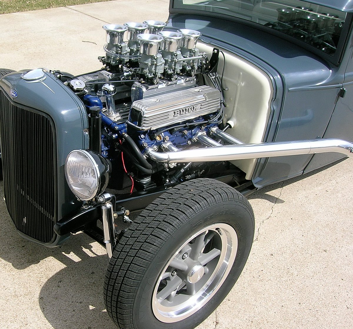

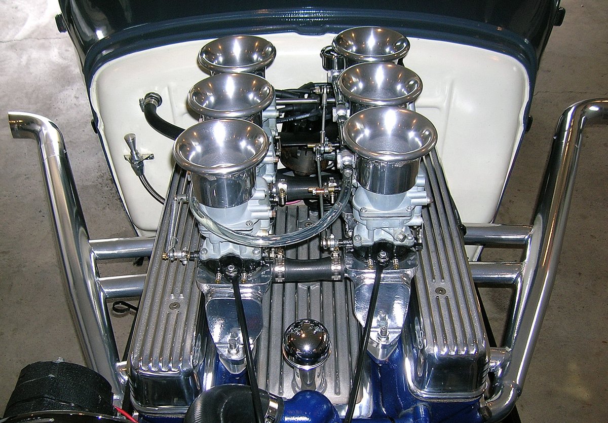

    I'd have to vote for the nailhead, but then I may be a little bit prejudice:
    Canuck
    clunker, nailed31, mgtstumpy and 5 others like this.

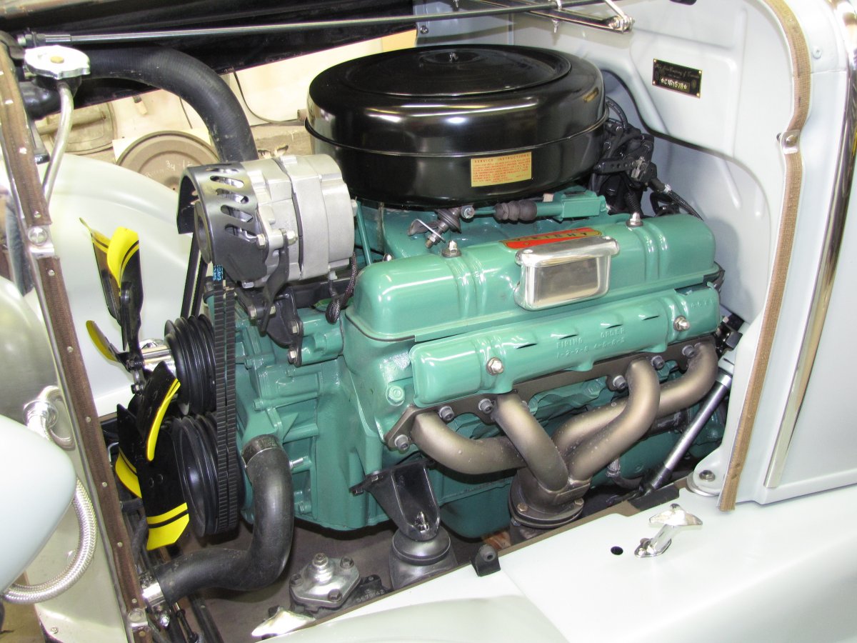

  25. Love my 54-322 Buick, now has a total of 11,000 miles in 2 years, just a great engine!!
    i.rant, pigfluxer, clunker and 7 others like this.
