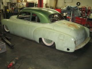

    has anyone measured their inside rear wheel opening to the floor and what is the consensus? I pretty much finished my chop on my '53 pontiac and began work on the frame this week, after measuring it looks like I'll have 25" from the top of the wheel housing to the ground, I'm probably going to have about 26" tires on the rear so I should be close to my 1" slammed height with the bags. I wasn't sure if the pontiacs or the '53's had a little more room there then the chevys or the earlier '50's cars. here's a couple of pics of the chop and the frame.
    [​IMG]also has anyone bagged one of these without boxing the side rails? Any issues or thoughts?

  28. Well,,,,here's what I ended up with yesterday,,,
    It's gonna be interesting when I change over to bias-plys 'cause that's not quite all the way down,,,
    I didn't brace anything when I made the cuts, but I plan to reconnect the stock ones coming off the wheel wells when I recover 'em. I'll also put little bridges over the slots I cut out for the upper bars. Bag mounts are done, just need to do shocks (I have some really slick brackets ready for 'em) and then the new gas tank.
    Bryan
