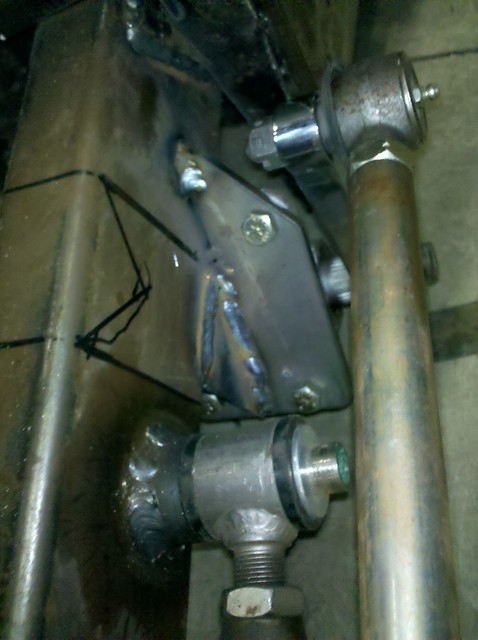

    Ok...so the rear radius rods are a set of split wishbones off of what i don't know...all he said was that there were "gonna cost me big time". We wanted to use the jaguruar bushings out of the cage so dad made some sleves on lathe to fit and weld into the bones we needed to cut a radius into the fat end with the mill seen here
    The front were done with tie rod ends and bung welded in. You can see here how they attached to the frame on the forward end
    and tacked to the lower control arms on the jag

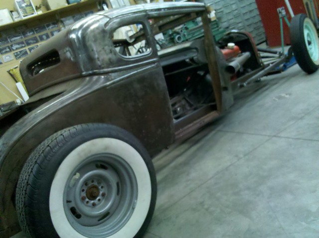

    So dad got the car off the frame jig and back down on the ground while i was out goofing off on thursday.
    The big question now is how well the front shock setup is going to serve us. The first thing i did was jump up and down on the front end. Seems like it will work. The front end is giving me about 5 or six inches of travel and the shocks had a couple inches of travel.
    The rear wheels are just for mockup. I'm going to need to run a wide tire in the back with a deep backspace to help cover the jag hubs. It was either that or shorten the axles and control arms. I'm opting for the wider tires. So cheater slicks and radirs all around i think.
    I had hoped against all logic that I'd be able to use the olds steering wheel but as i suspected it's much too deep. We have a white grant that will suffice.
    Next up is getting the master cylinder mounted...i think

    The reason behind the shock design concern is because a shock needs to be at less then a 30 degree angle. The more vertical, the more dampening effect it has. Only way that I know of around that is to install then on a bell crank which honestly I only see on radical race and show vehicles. The way you have them mounted it seems they would pivot on the bushings before they actually do what they are designed to do. I'd be finding a set of short shocks designed for a short suspension travel car (such as a hot rod) and getting them as close to vertical as you could

    Would some sort of collar around the shock body that limits the shocks abillity to swivel do anything to help? I understand that a more vertical shock works better, just trying to find a way to salvage the current setup.
    I can't remember where but I know at some point in my life I've seen some airbag setups that used cantilevered arms to transfer the movement to a bag that was mounted inboard. I don't remember if the bags were still vertical or if they were arranged on their side. I do understand that the bags were used to suspend the trucks not to dampen them so maybe it wouldn't work, just throwing ideas out.

    I understand the Cantilever thoughts, same thought process for a bell crank design...Since the mount would have to be redone anyways, its my opinion to just keep it simple and build a "traditional" more vertical shock mount. I try to use the "KISS" mentality. Just my 2 cents, sometimes it isnt even worth that much haha

    I'm not married to the current configuration. I'm leaning more and more towards a more traditional setup the more we hash it out. This setup may prove even more problematic when we try to get our headlights set where we want. Sometime it pays to wonder the beaten path and sometimes you have to back track. Working through problems like this is all part of the fun.
