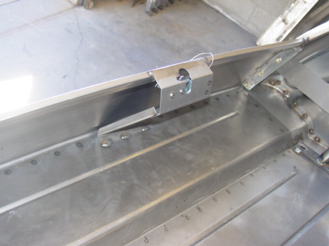

    I am just getting around to working on a Rod Bods 32 roadster body that I started putting together 20 years ago. Can someone that has one of these bodies tell me how the trunk latch and striker install? The disc I had with all the photos I took at their shop years ago is bad so I don't have much to go by anymore.

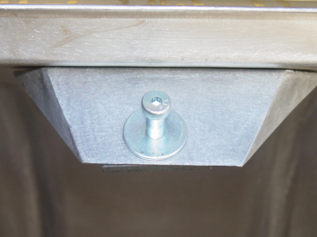

    Yes I get that the pin goes on the trunk lid. The mounting plate with the pin fits the inside of the lid, that part is pretty straight forward. The latch location I haven't got figured out. The bracket attached to the latch doesn't really seem to fit the rear panel anywhere.

    The Repo latch in lower panel do not fit correct neither
    With out cutting reshaping weld then bolt in .
    If no one can post information
    I wonder if mock up in hand & use dial
    Caliper , tape & cardboard to sort out location .

    Yes I could fabricate something, If I had a photo of the way Rod Bods installed the latch it would probably be eaiser, I am probably missing something obvious. Sometimes I fabricate something and it comes out great, sometimes its not great and I do it over.

    I was able to repair the file structure on the computer disk and recovered the photos. Anyway this is how Rod Bods mounted the latch. I just needed to add another piece of sheetmetal to the latch bracket. DSC00696.JPG
