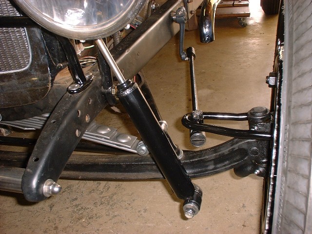

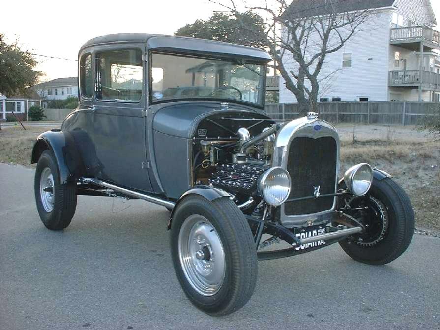

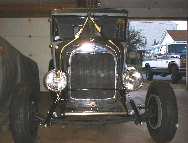

    Exactly what I did along with a reverse eye spring in the rear. With 550's up fron and 750's in the rear, she sits right at 2 degree rake.
