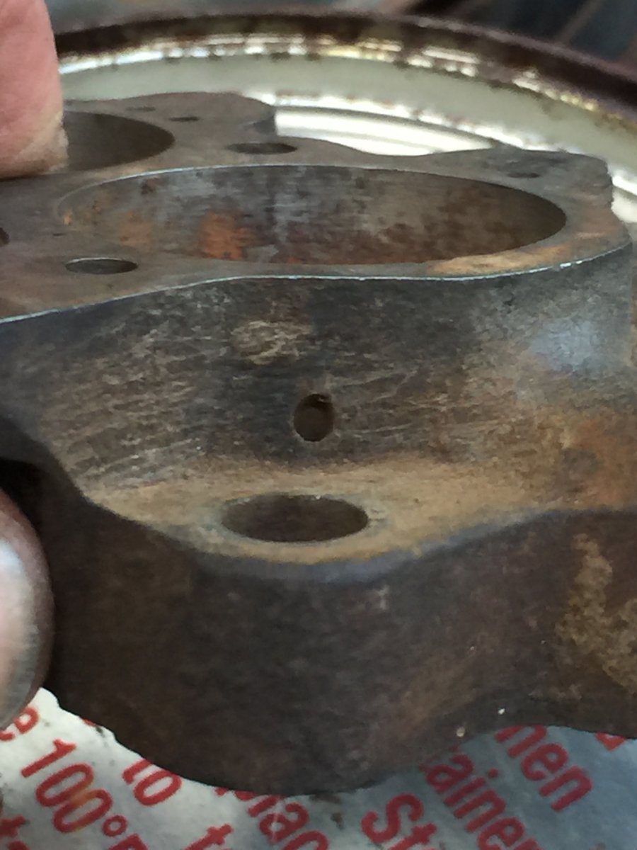

    Anybody know what these holes are for?? I’ve never seen before. Came off of 61 Impala 283.

    Don't know their exact 1960 purpose, but have seen it on many Rochester (No "D" needed) carburetors.
    Like a purpose built vacuum leak, but NOT until the throttle is opened.
    They make the carburetor flow a TINY bit more air is about all they do.
    Not to worry, clean them, reassemble them and use them.
    Mike

    They Help The Idle Circuit...And Work...

    ^^^^^^^^^^^^^^^^^^^ Vapor vent holes.

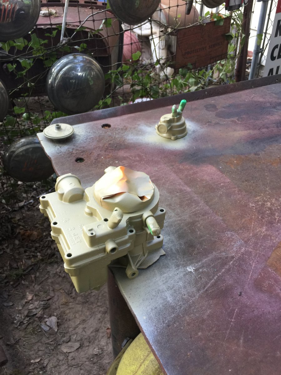

    85D31405-5E36-4B62-B362-56EE244285FC.jpeg 9D71996D-8154-4CAC-9A17-419DC40AC462.jpeg F6286B31-4457-4867-9426-EA41FEC299FB.jpeg Soaked all day yesterday, all day today, came home and sprayed with Eastwood carb paint.

  7. They allow non filtered air and dirt to enter the interior of the carburetor. Idling around town the carb gets hot and the extra air is supposed to smooth out the idle. The plus is it adds extra air at higher rpms to cause detonation and suck in dirt. (poor man's hot idle compensator valve)
    They are similar to the idle control valves in the base of the Holley 2100 carbs.
    However Holley uses a vacuum valve to open and mix the ported and manifold vacuum
    to raise the idle so the engine does not stall.

    Unfiltered air is all that I can think about at night. That’s the reason I posted this.

    Can I sillycone them???

    JB weld them suckers up. I don't remeber any of my 2Gs having those..?!

    ^^^^^ Put (fat) tooth picks in first and see how it idle's and or run's. If it don't then all that has to be done is pull them out.

    Those are factory I have several with the holes.

  14. Sounds like solution in search of an actual problem.
