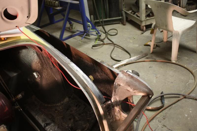

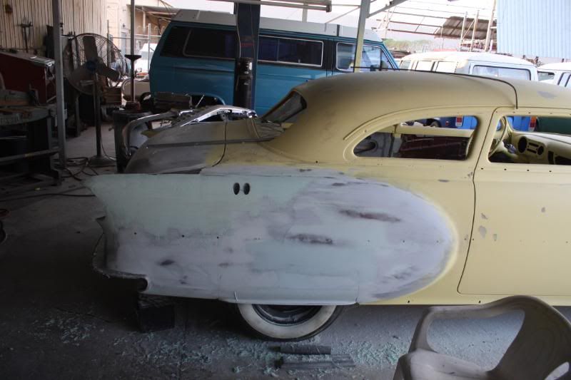

    So the last update with pics was a little deceptive. It seems like everything on this car has been done twice. When we originally did the tailights, they looked out of proportion to the car, being that it was a subtle chop, they looked really low and stubby. Although they where the same height as Moonglow, but that car was chopped alot more, plus the bumper on that car was lowered like 3 inches which gives it the appearance of height in the rear. Anyhow, After I finished the right side, I was pretty devastated that it looked like ****. Roger was on tour, so without telling him I cut out the left side and changed it. It was kind of funny when he surprisingly stopped by the shop ( I wasn't expecting for another week) and caught me cutting his car apart even more. In the primer pic I posted, that was a rough first prime on the drivers quarter, the p***enger side hadn't been changed since round 1. I ended up raising the taillights 7/8ths and extending them 5/8ths. Also moved the rear bumper down 3/4s and moved it back an inch. So here is the right quarter getting caught up to the left one.
    When we did the frenched antennas, that was lined up for the stock roof, with the chop the rear window was moved forward quite a bit, The catwalk panel and decklid arched, plus with the quarters being raised from the stock dropping slope, the antennas needed cut out and relocated. Heres where they are now.
    One night I was on the phone with eric, and was telling him how I thought something was wrong with the drivers side quarter, like it had a flat spot or something. I was right. There was like a 3/16th flat spot above the wheel well, so I bent a long piece of sheet metal and with a shrinker/ stretcher made a profile gauge for the tops of the quarters, and fabbed the p***enger side to the right profile, but I had to cut back into the driver side and fix it. Also both sides needed some shrink spots right behind the wheel wells to take some crown out of the panels to keep the sides semi slab sided for the new height and length of the quarters.
    You can see the shrink spots on the driver's side in the above photos.
    I made top. side, and rear profile templates out of sheet metal, and now everything matches. I tried to go above and beyond the typical 53-54 chop, but these quarters are one of a kind and I didn't want any waves or any ******** with them, they have to be perfect. I also wanted to sharpen the top peak just a tiny bit, so they were more in line with the fender creases, and the hood.
