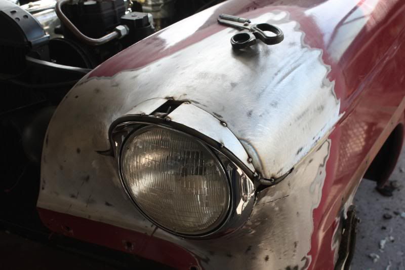

    So heres a step by step on the headlights.
    First thing was to make little cuts so I could put the J clips on the headlamp housing instead of the fender, and get that **** reversed. It's funny how by screwing it in backwards makes for perfect spacing for 55 bezels.
    The 54 bezel is oblong, so next is to make the opening round to match the 55 bezel.
    It took some pie cuts to smooth it out.
    Then get the wire shaped...
    then make the upper mounting bracket...
    Then a couple of strips of sheetmetal to hold the wire in place...
    Then fab the new sheetmetal cap to make it flow into the fender...
    Then weld...
    Tomorrow I'll put up picks of it metal finished and ready for filler, and pics of Roger's Floor patches all welded uP!

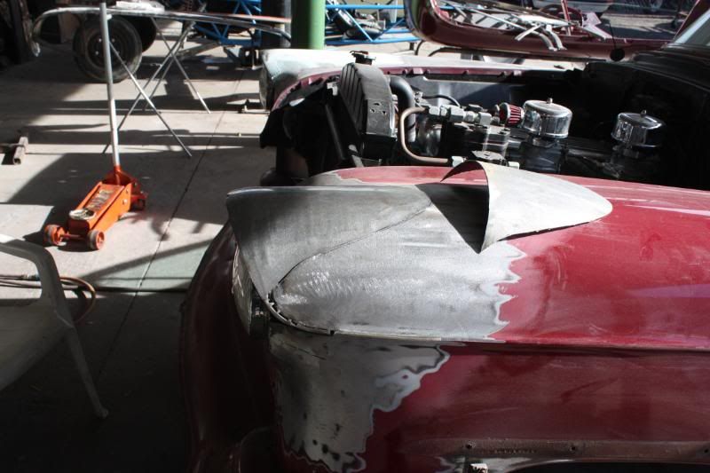

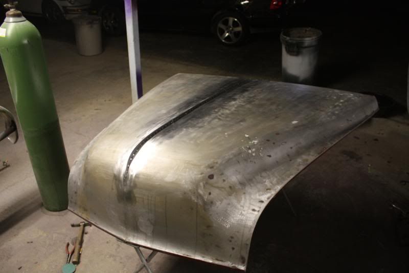

    There is alot to update, just waiting for picture of some stuff completed to post them. The hood is about licked. We bull nosed the front of it. I gas welded the whole thing because I had alot of shrinking to do to get the peak out of the front of it. Then cut some 12 gauge to make a little rib that I tacked onto the top of it, then leaded that in for a tight little peak.
    Here it is all metal finished.
    Here is the peak prepped for lead.
    Here it is covered in lead, I ran out last night (It was an all nighter) So here it is about 3/4's done
