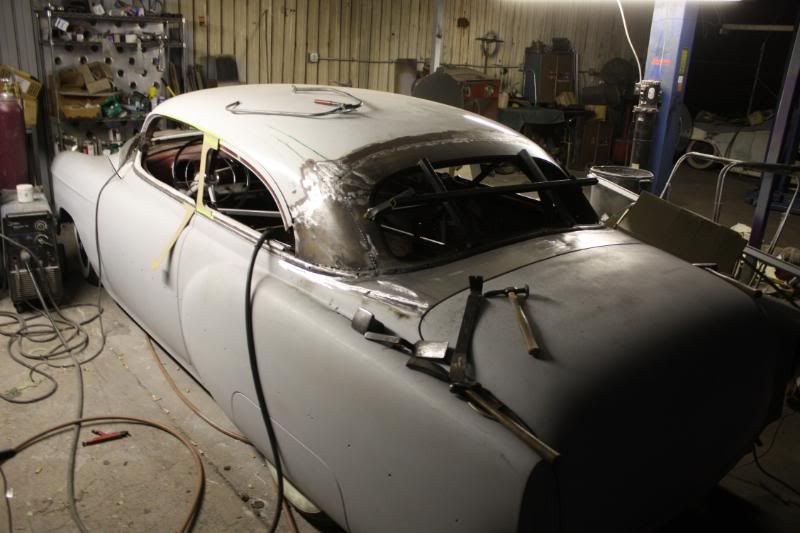

    2 inches in the front, and no clue in the back. Just brought it down until it looked right. Just wanted to improve the flow, not squish it. I'll post up more pics soon, but yea I made a new package tray (catwalk?) panel and arched the decklid so that there was no transition between the gl*** and flow of the chop.

    Heres a pic where you can see where the stock tray was, the new arch of the decklid, and half of the new package tray being mocked up.

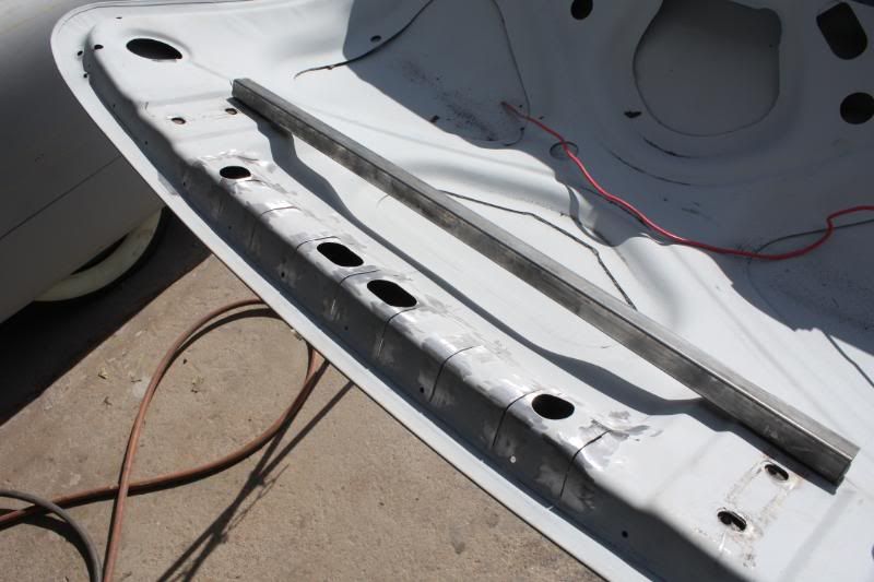

    Here"s a pic of the pie cuts in the deck lid. I could have made less but you live and you learn. It worked out well though. Used a friction jack to pull the deck lid in. Lost like a 16th on gap on each side, on the top, but I got a trick for making those gaps perfect.

    Heres a pic of the new package tray panel tacked to the 49 gl***. welded this into an ***ebly before tacking it to the car, that way I could metal finish that weld super easy.

    Here"s a pic of most of the package tray all cut out. After everything was welded and fitted I cut out that center sheet metal section to weld the new one in.

    **** all welded... (tig)

    every thing cut out...

    Tomorrow it should all be welded and ready for B pillars!
