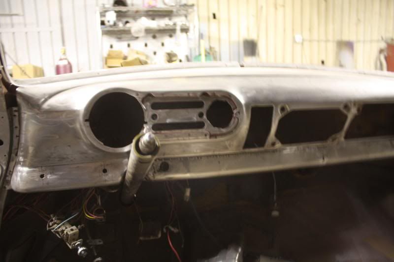

    Working my *** off and nothing I wanna take pics of! That'll change soon. For Roger to have a phobia of sand, he's a get down mother ****er when it comes to stripping paint! ;) He got the dash ready for primer, but wanted to just clean it up a little, without getting too street roddy with it where the dash has more work than the rest of the car.
    Before...
    template...
    Blank...
    Tacked in, get it welded menyana...
    Thinking of making our own dash knobs, I've got some diamond dust, stoked to see how they come out.

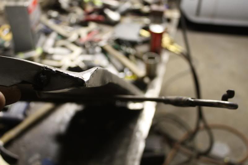

    So for the last couple of days Ive been jumping around doing other stuff, cause who wants to see pictures of modified regulators? Technicalness = GAY.
    Extended the skirts by 1 an a half inches...
