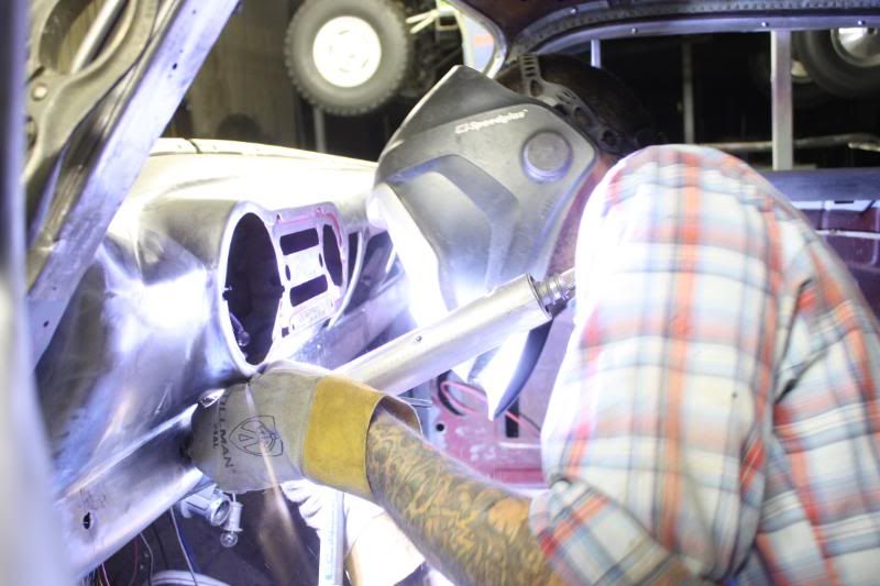

    Skirts are done.
    Also got the dash welded.

    The smoothed dash is a really nice touch.

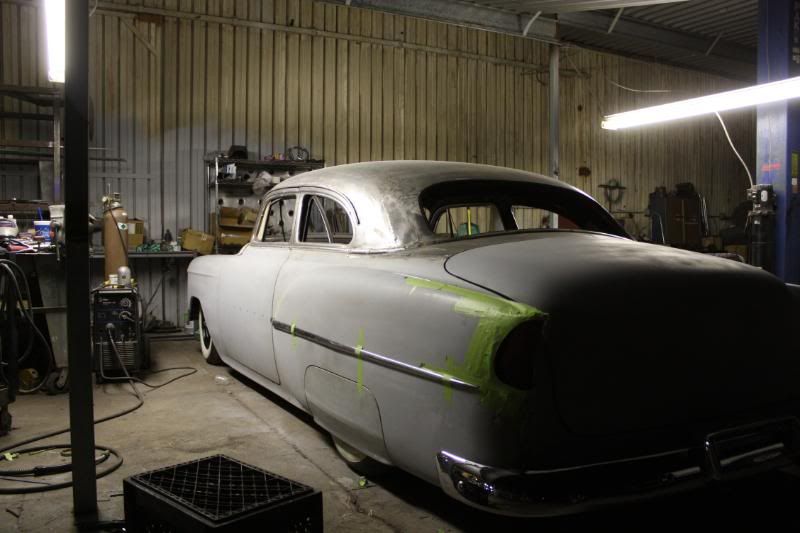

    I think this is my favorite taillight treatment on 53/54 Chevys. Great work all around!

    Not to mention, the way that backlite sits on that beltline is ***! Hey Roger, Am I striping this one too? LOL

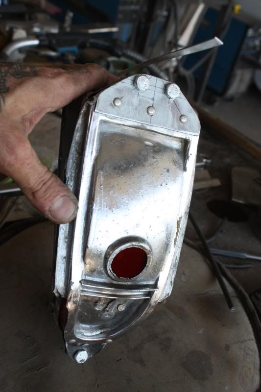

    Got the tail lamp housing roughed in...

    did you heat and bend the round rod or brut force? ****ing tail of that car is going to be stellar.

    I just bend it through a little hole in the welding table, then smooth it out with a hammer over a dolly.
    Keep in mind this is just a super rough mock up, none of this is set in stone...
    These panels will be tacked and removed about 50 more times...
