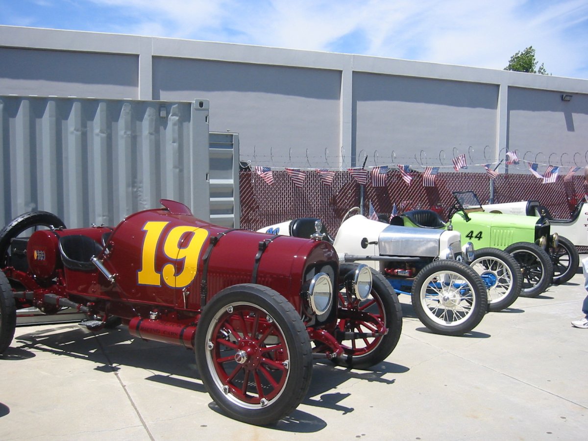

  24. You missed my point I don't think a race car with histroy should be cut up, but the T.R.O.G. is competive racing full speed racing not just "at speed parade laps"
    The cars need to be period correct and safe.
    As much as I like old 20's-30's open wheel cars and think they need track time, they are not safe to do any real racing.
    I am currentley building a vintage car to race a local vintage club. all parts period correct and a era correct roll cage however with more door bars. The cage will be very much like the 10-Pins super mod build in 1960.[​IMG]
    I will be building a floor so my feet are not exposed.
    My families histroy with oval track racing goes well back into the early days.
    [​IMG][​IMG][​IMG]

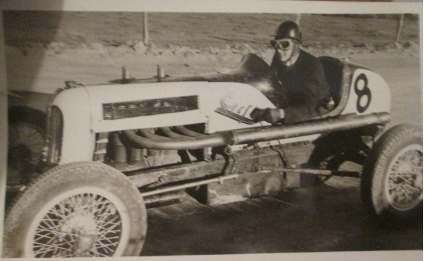

    I love this topic.
    One side for safety, the other for period correct and or the cool factor.
    Mr. Palmer likes the safety side, although posting a photo of a roll barless family racer.
    I get the safety factor, but it if everything was geared toward safety, we would leave our cars unchopped, leave on the fenders, keep them bumpers, mufflers, mirrors, door handles, lowering them could be unsafe too! Blah Blah Blah You get the point.
    As far as TROG, First it was the dot helmets, now a roll bar, whats next, disc brakes? Fenders?
    Like everything else, we can't just "play", things always become compe***ive, things get faster and then someone gets hurt. Then it gets ruined. :(
    Anyways, look at that photo!!!
    It doesn't get much more cool looking than that, even if he had a roll bar, he still would look bad***!
    Neat photo Mr. P.

  30. I think the cars need to be safe but also need to be period correct
    Roll bars and seat belts have been around since auto racing started again after the end of the war.
    I don't think T.R.O.G. cars need funny car cages or full containment seats, but I have no issue with head high rolls bars. World War II aircraft used shoulder harness.
    I have been at races where people were hurt and killed, a family friend was killed at the 1990 A.R.C.A. race at Daytona.
    My talk of safety is not just that of a casual observer but someone who has seen the ugly side of things.
    This is my Great Uncle Don Weyl he was a crew men.
