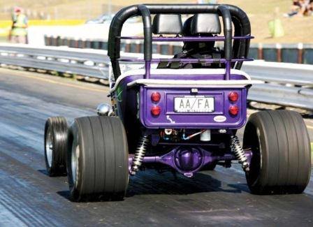

    So once this got quicker than 10.99 it needed a 6 point cage. Eventually it ran a 9. Its street legal here in New Zealand and has been on the road since it was built in the mid 70s.
    The cage is well padded, tho if I did the padding again, I would go straight to the SFI catalogue and buy their best stuff. The cage is way high, but both me and the prior owner are over 6ft with long backs.
    The original plan was to run the car with the cage when racing and to cruise around without it when on the street. Strangely, the cage never came out of the car, as I felt very safe in it with the cage and couldnt see any good reason to reduce safety. Similar views to may folk - there are too many numb nuts out there - So why not leave the cage in there and use the 5 point harness every time I drive the car.
    As for asthetics, well thats an individuals call. I figure if my car has a bit of a race vibe, then the cage and harness look like they should be there.
    Im now onto a 27 T roadster and thats getting a 4 point cage, and another harness as those numb nuts are still out there.

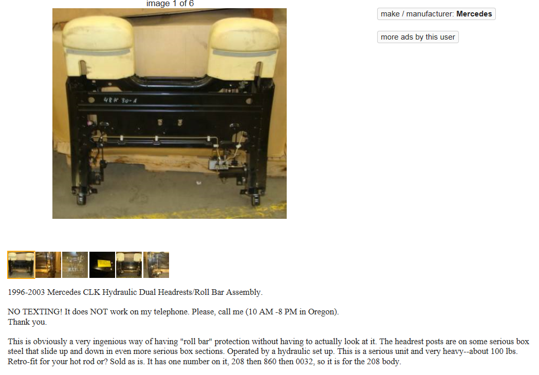

    So, this is an idea I was messing around with recently. Can you have a roll bar that looks cool (not taller than the driver) , still operate a soft top and have it as a safety issue (taller than the driver as previously posted)? Sounds impossible but having owned a Mercedes rag top before I know all Mercedes convertibles since 2000 have fierce roll over protection (as do the Beemers). I saw this on the local craigslist for $95.00 today.
    At the rollover, sensors automatically extend what appears to be headrests above to full height in a split second to support the car body and protect the occupants. So instead of the headrests, you re-engineer a chrome roll bar that does the same thing. Looks cool when down, pops up when needed. "hide your technology"

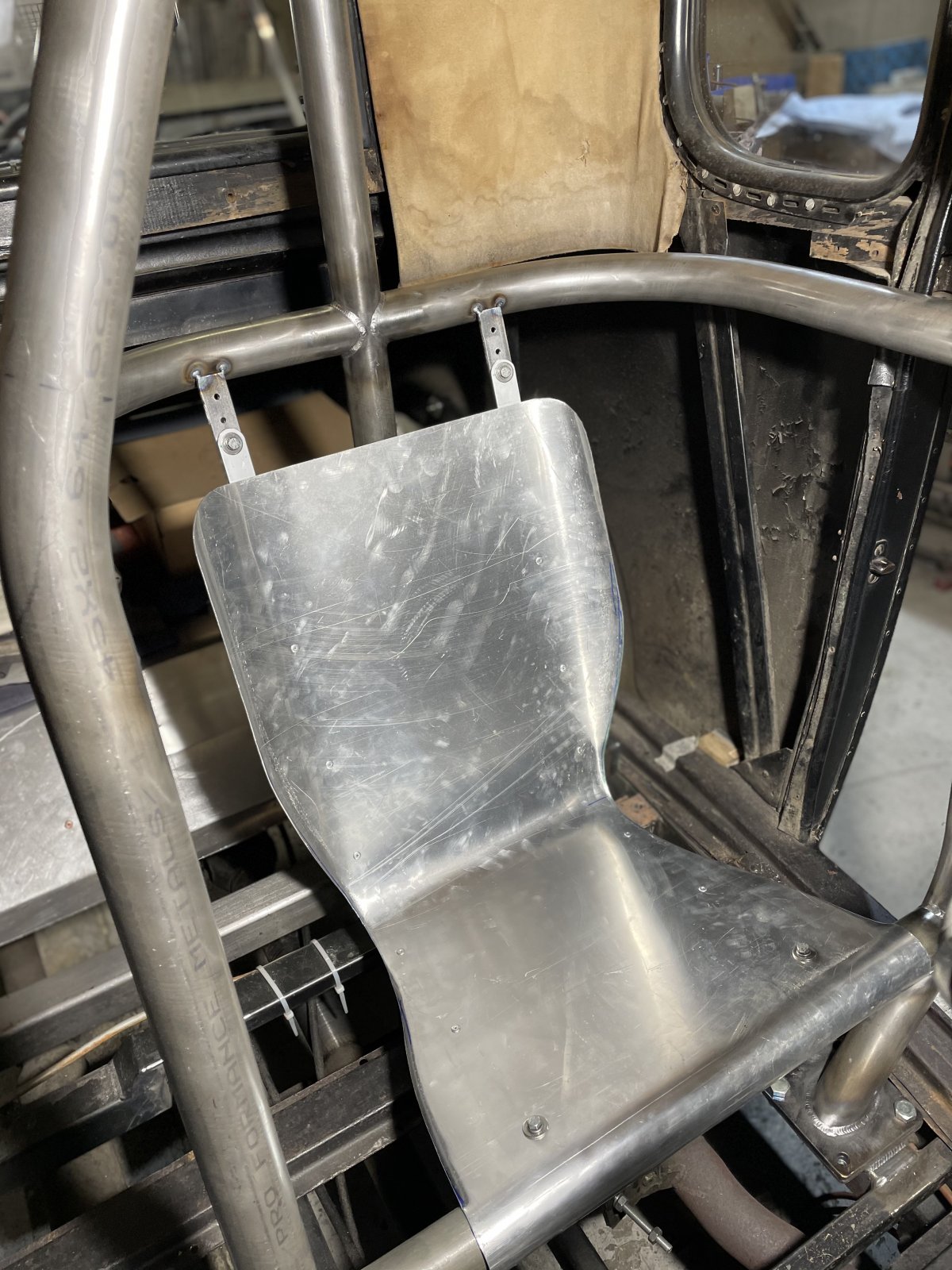

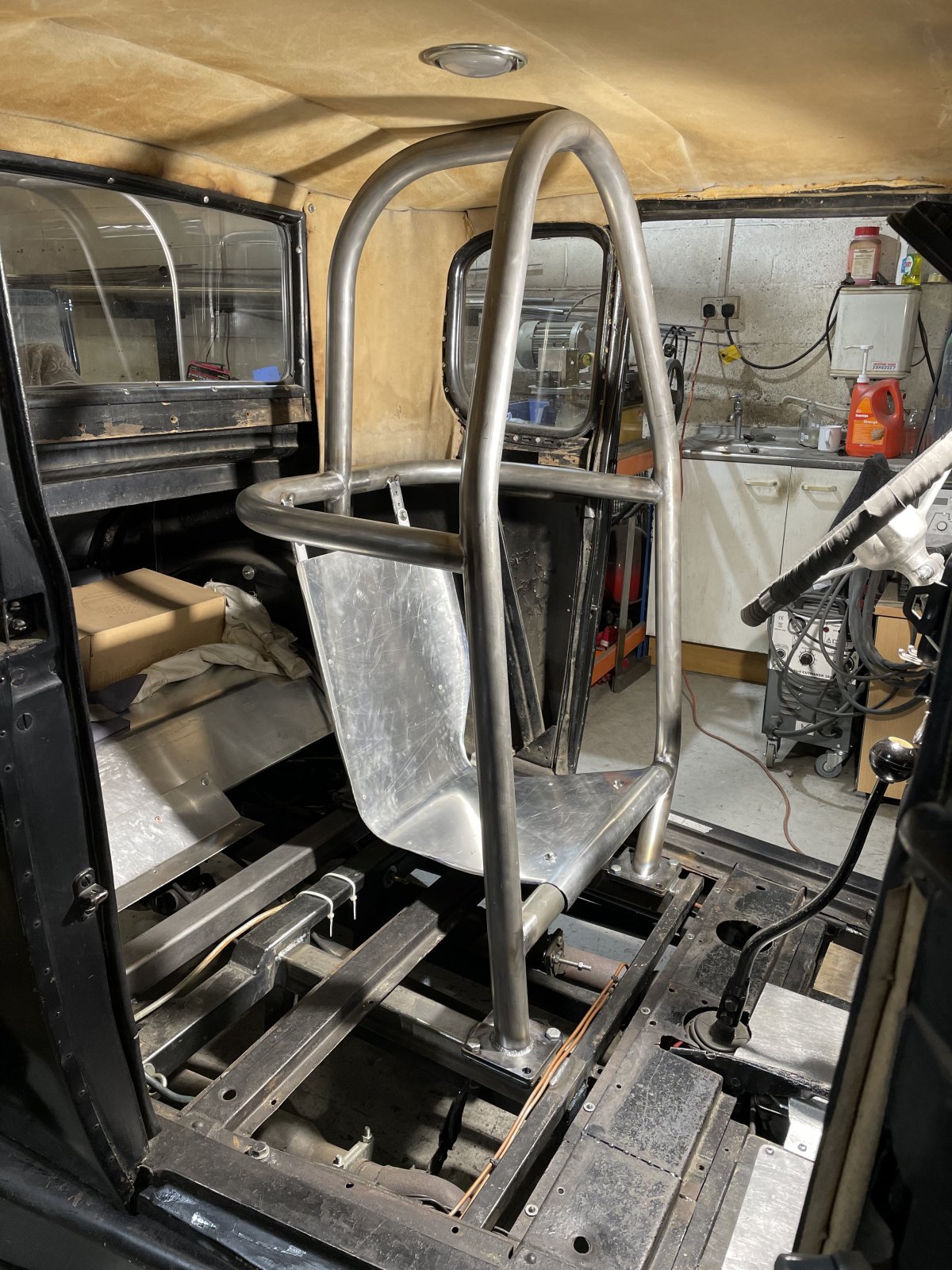

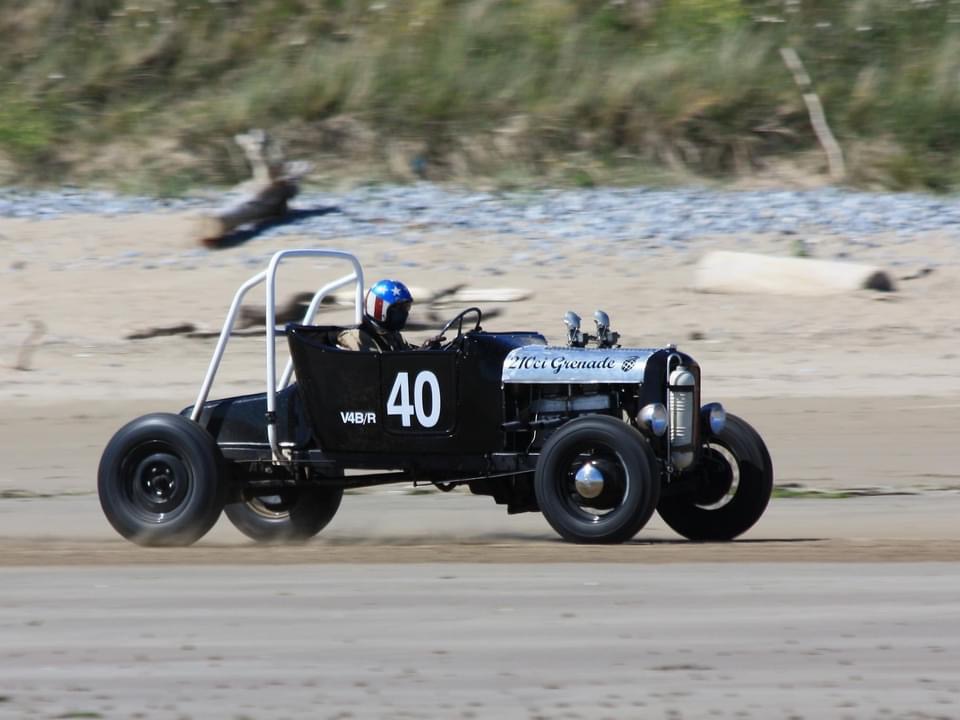

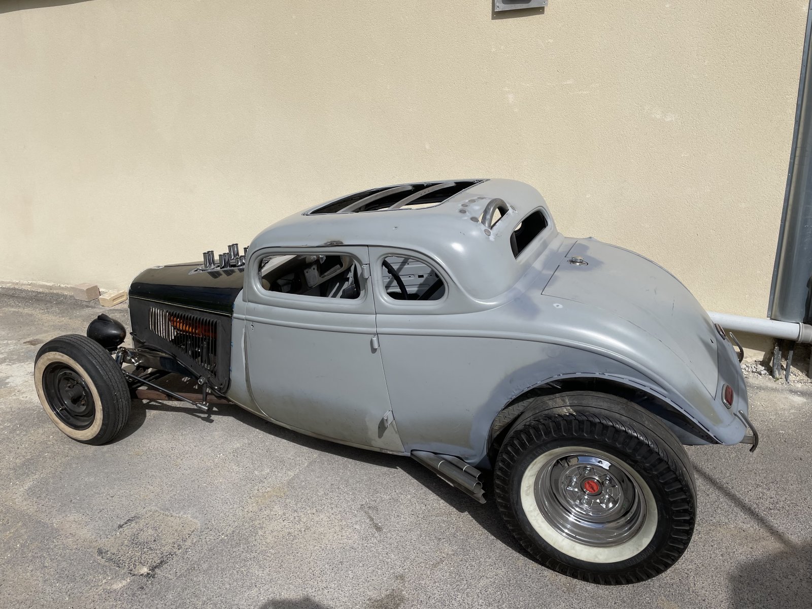

    Roll bars can be cool, but really difficult to get form and function.
    VHRA Pendine Sands requires roll bar for over 100mph and a cage for over 110mph.
    Although my example isn’t the best looking thing, I feel it has a vintage vibe about it.
    Engine build thread
    https://www.jalopyjournal.com/forum/threads/blown-4-banger-210-inch-grenade.1220215/

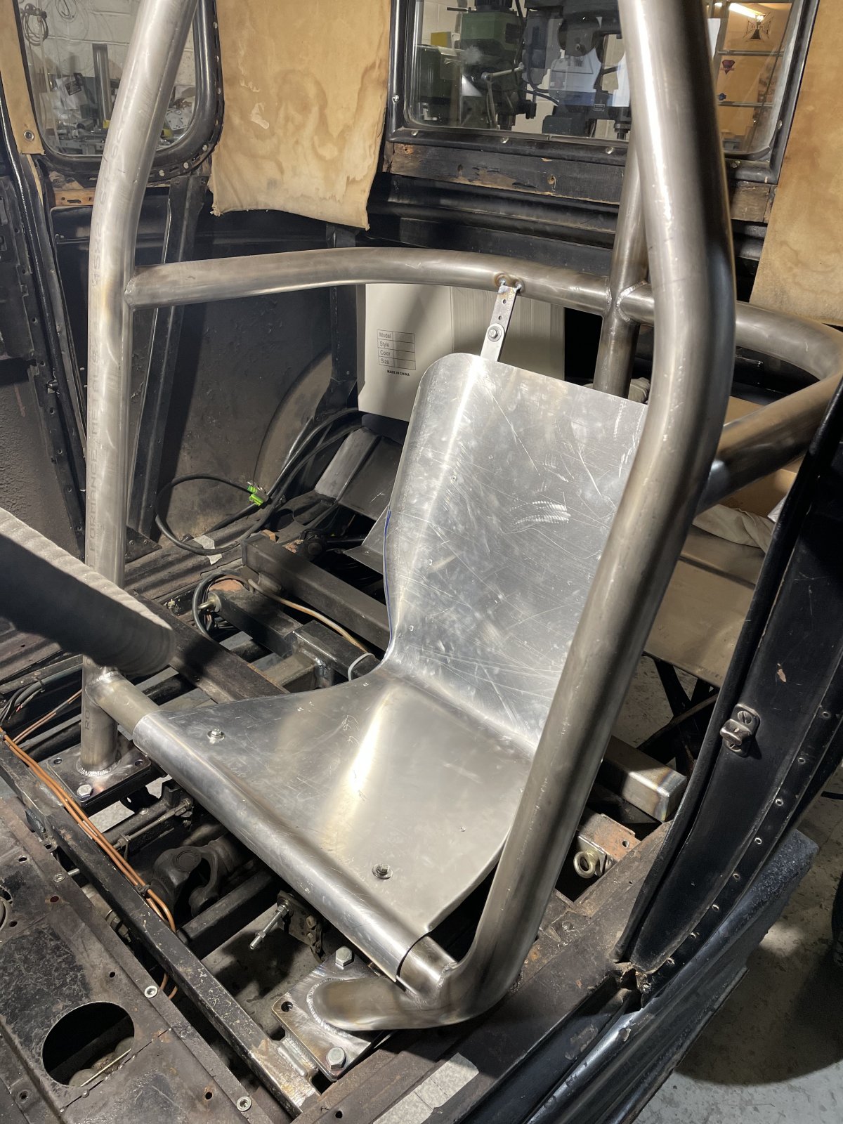

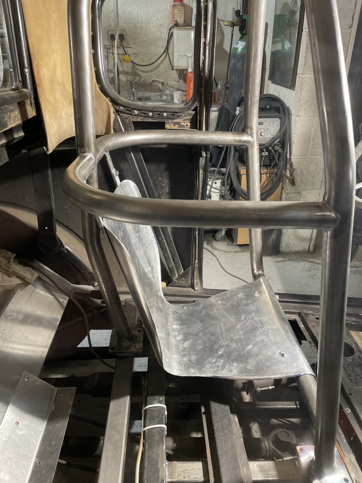

    This is a roll bar I made for a heavily chopped and channeled ‘34 coupe. It meets the VHRA requirements.
    BD88B9B5-2B66-47A0-ADD7-3F75DD030C2E.jpeg 829B756A-E66A-4109-9ADA-E27AE8DAD6C2.jpeg E7E07FB8-998B-411B-8699-0FFCFA902D9C.jpeg 56B05300-5CC1-4270-AE5C-13A4051DCA70.jpeg 0FCB93C9-876A-4D55-8CCB-A1C95AA447A9.jpeg
    Build thread.
    https://www.jalopyjournal.com/forum/threads/34-coupe-survivor-ish.1219403/

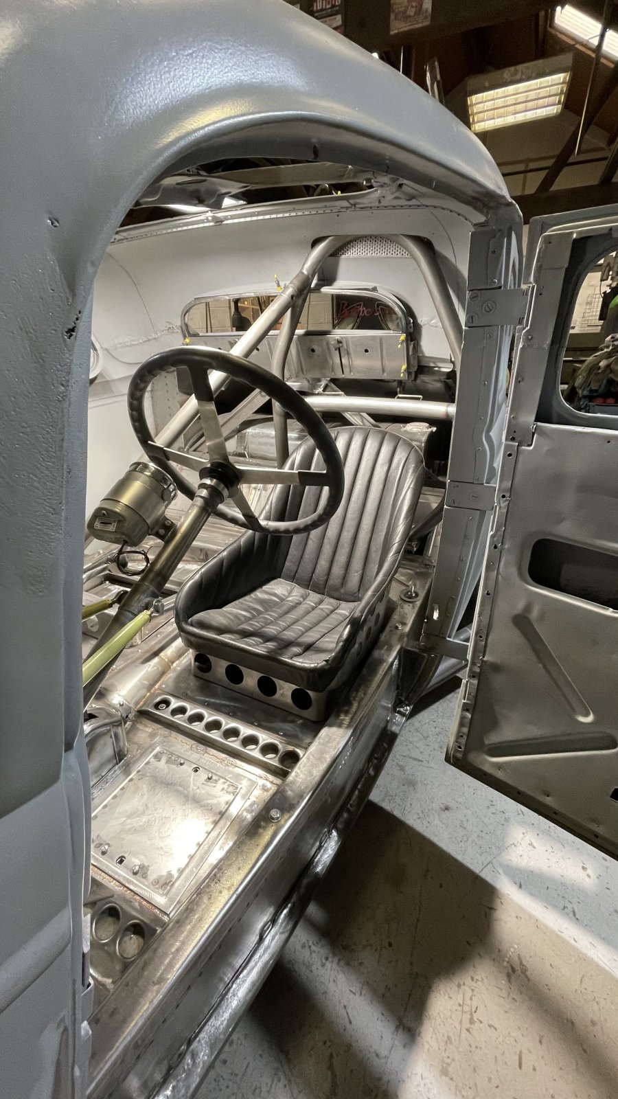

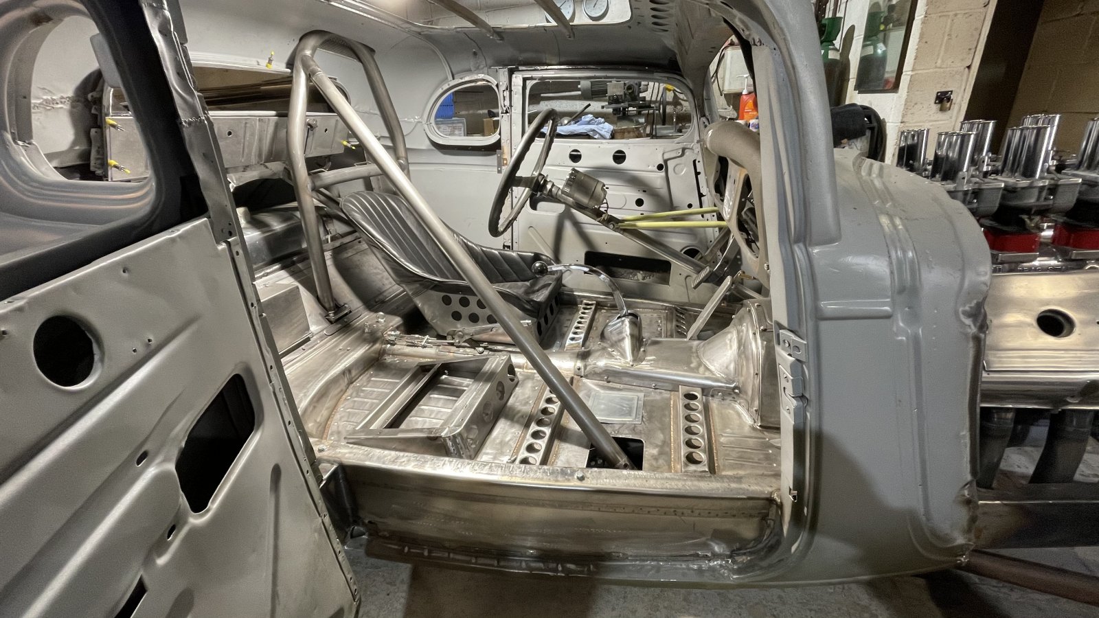

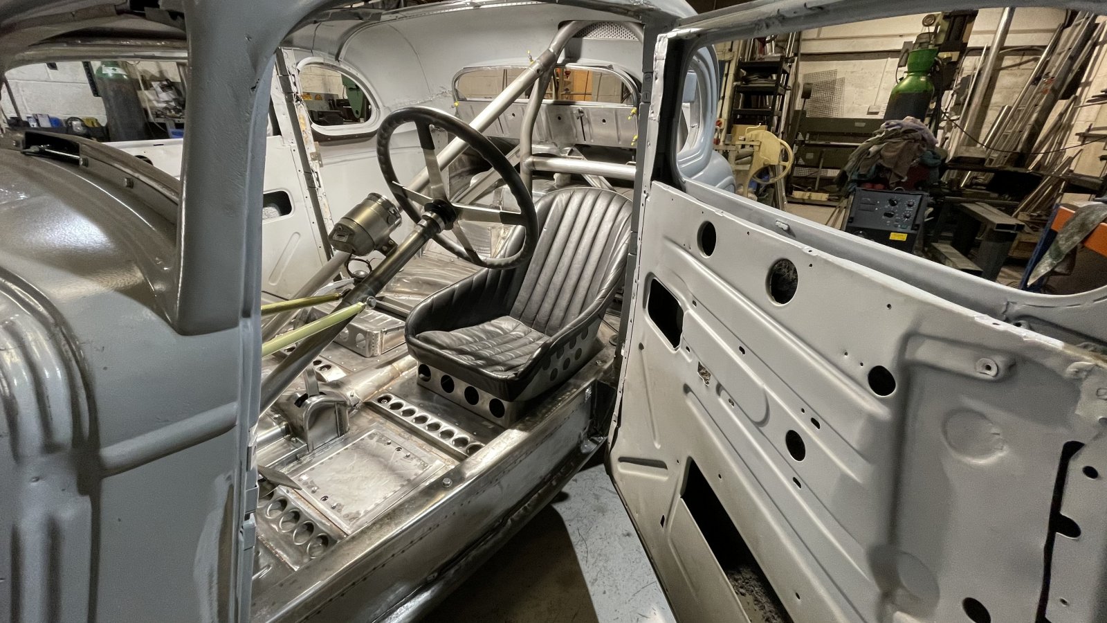

    This one is a cage. Fitted to a slightly channeled but unchopped A coupe. Again, it meets VHRA requirements to run at Pendine Sands.
    A838A89E-DD93-414A-A508-349645734E79.jpeg F890F3A6-3282-4E81-B104-9953ADCB3547.jpeg 0E54BD0C-DD51-45A7-83F0-35AD352E3E83.jpeg B224B2BD-D330-43EF-B9F9-DE9B43DE77B0.jpeg

    ^Nice work!
    Great example of a cage that dictates a helmet. That rear bar is right behind the noggin. Real deal protection that looks good, too.
    In the '70's ''show bars'' were all the rage with 4x4 pickups. They were awful!

    worked on volvos with this ropes system (role over protection system) along with the headrests yu also needed thhe boron steel A pillars to hold up the front of the car

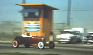

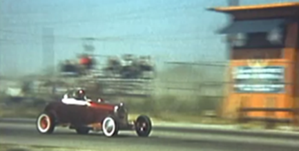

    In our old days, there were cool roadsters at the drags. A lot of them went on to fame and fortune in the later years with different builds, teams and race cars. The early inspection teams at every dragstrip had their way of safety rules. When the 1320 ***ociation set the standards, it was to get the head of the racer/driver under the curve of the roll bar.
    Brissette, Quincy, Eichenhofer Tahitian Red Roadster or as some people see the color, Candy Apple Red.
    1959 Lions Brissette, Eichenhofer, Quincy Automotive Candy Apple Red 29 Roadster.
    The Brissette, Eichenhofer, Quincy Automotive Roadster was a great sample of what a roadster could be for compe***ion and street usage, if it were a street roadster. For the untrained eye, and no knowledge of the modified roadster, it could have been mistaken for a street roadster going down the dragstrip… Candy Apple Red/Tahitian Red paint, custom chrome accessories, whitewall tires, Moon Discs, along with matching Candy Apple Red/Tahitian Red steel rims, and a great looking rake to finish a street roadster look. But this Candy Apple Red/Tahitian Red Roadster was a pure drag racing roadster that set records in the Modified Roadster Cl*** as the local So Cal dragstrips. (7 So Cal dragstrips at the time period.)
    The old style curved roll bar fit the open roadsters quite nicely and made a good addition to the style and function. Some were above the driver’s head and others were questionable. It was early drag racing and some basic rule structure had to be made. It was the time period and no comparisons can be made for the then/now compe***ion race cars for safety. Style wise, the old days had it in droves.
    Jnaki
    upload_2021-10-25_5-9-30.png Harrell Engines Red 1929 Ford Roadster
    Another great example of the same style curved chrome roll bar was used on the Harrell Engines Red Roadster during the same time period of 1956-60.
    upload_2021-10-25_5-10-29.png Lion’s Dragstrip
    Harrell Engines Roadster

    Been following your build, love the motor!
    My first thoughts were roll bar looks purposeful and not out of place, second thought was paint it mat black, to make it look a lot smaller.
    Great motor
