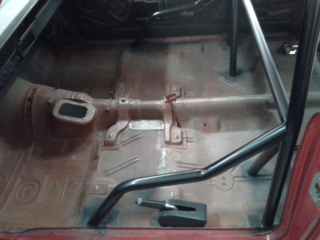

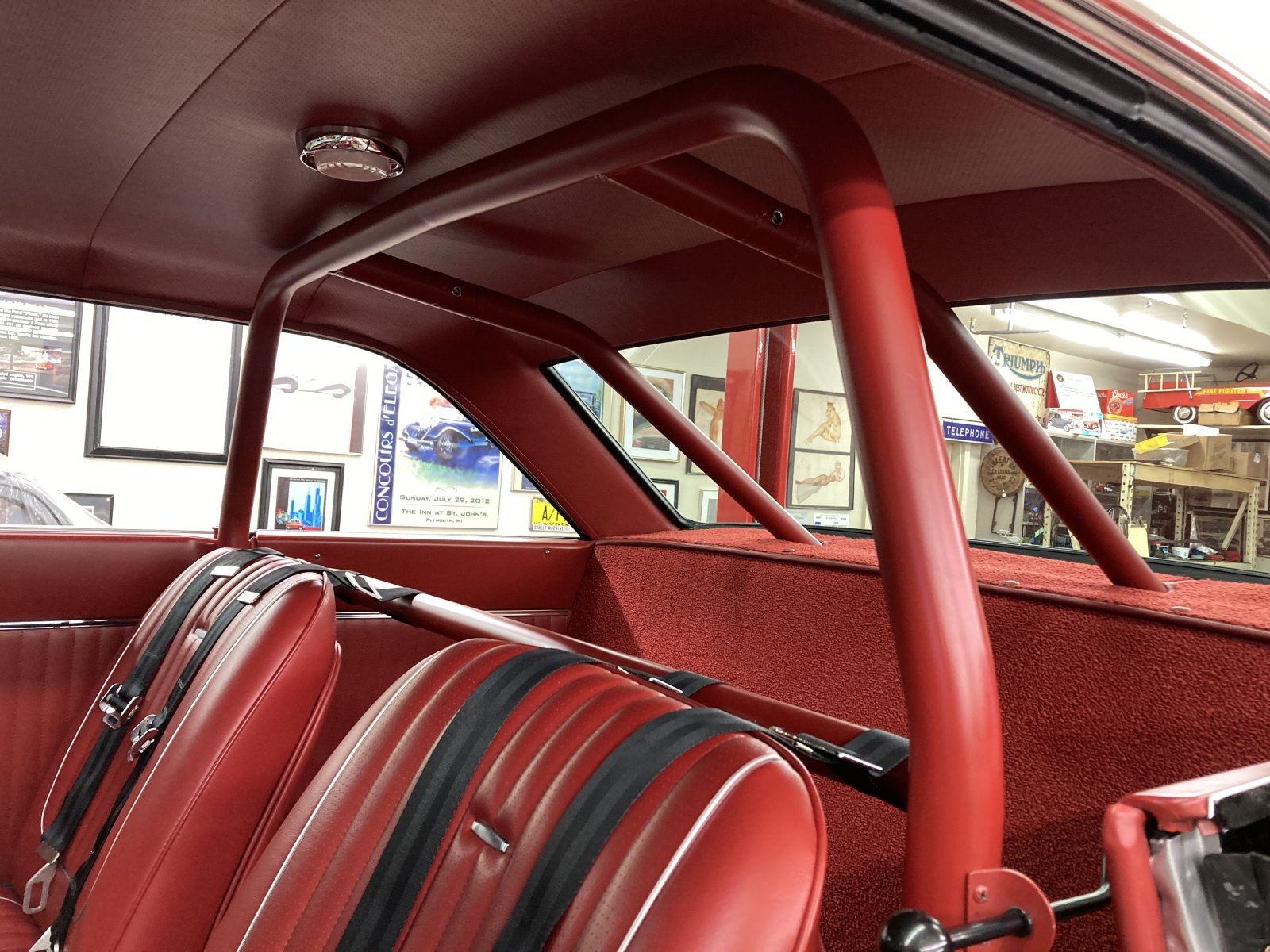

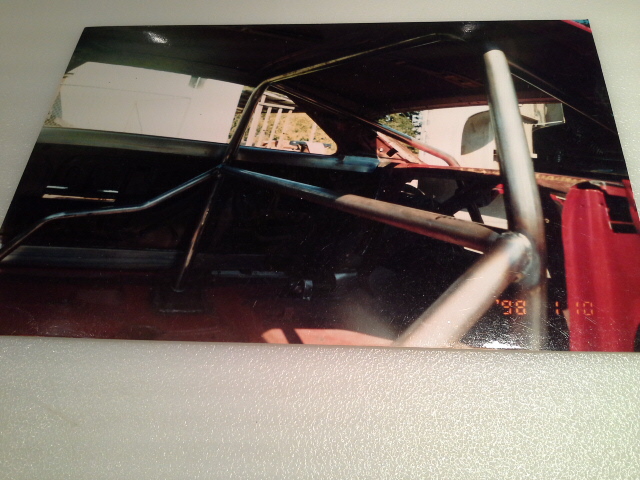

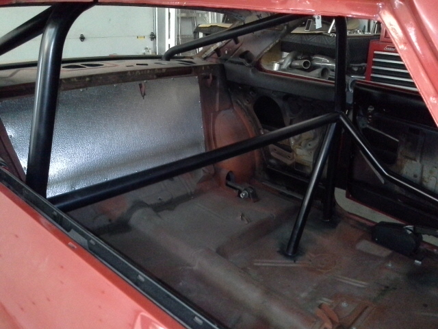

    To my mind, anyone building a car with plans of driving in a "spirited" manner should consider a rollbar, especially a car with unibody construction.
    I did.

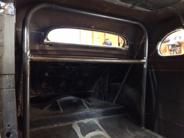

    kabinenroller

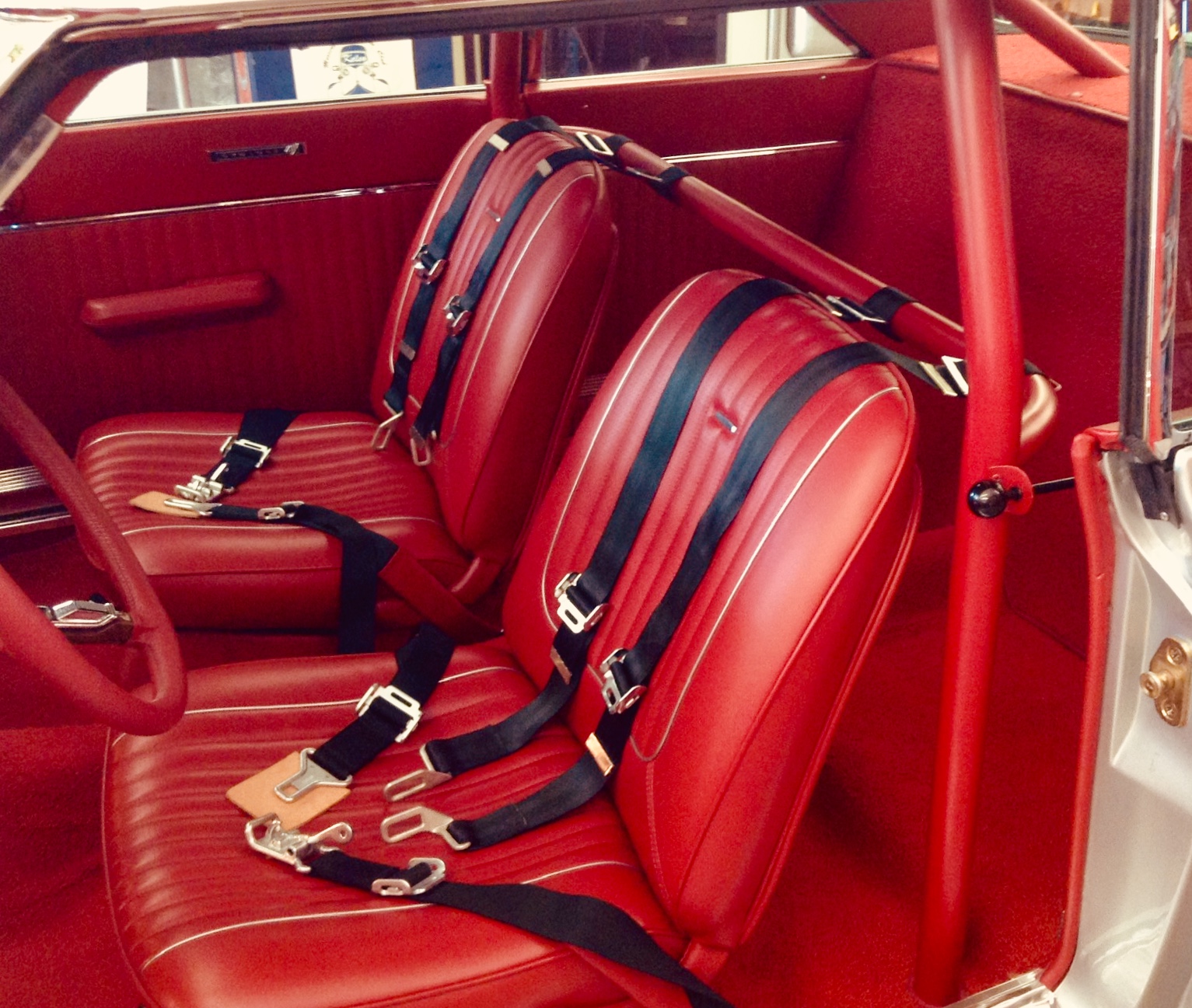

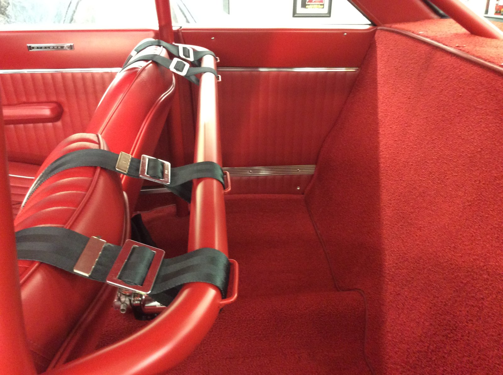

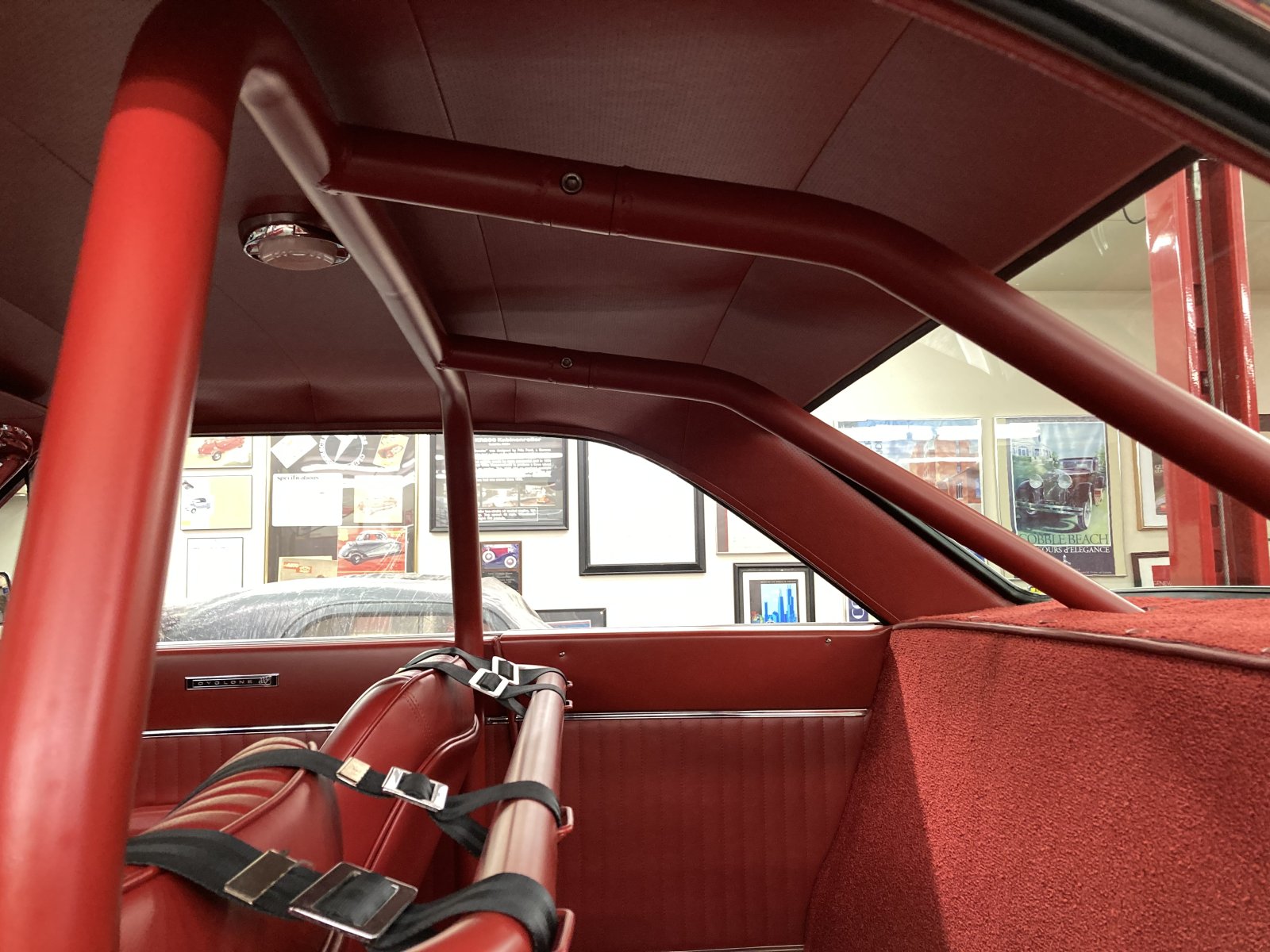

    My idea was to reinforce the sub frame connectors that I added to the undercarriage. Being a street car not a race car I wanted to make sure the bar was not a bodily hazard during impact if that should happen. I also wanted an esthetic factor, the bar needed to look the part of the theme I was building. I made up a template bar using PVC tubing, after it was fit to the car I had a local ch***is shop duplicate the template in DOM tubing. I fit the bar, fabricated the mounts and tig welded it together. The bar is removable if needed, it bolts to the sub frame and the rear crossmember, it has added rigidity to the car for sure.
    3C6E830B-D1A1-40AC-9CEB-1D055C5C86C9.jpeg 06447744-DCC9-4A90-9BFF-C4E2315803C6.jpeg 1ACE62EC-EE7F-466C-8A0D-CF4EBBA7E4D8.jpeg 6CDC61CF-D588-4773-80BB-B7E44E5BC45F.jpeg
