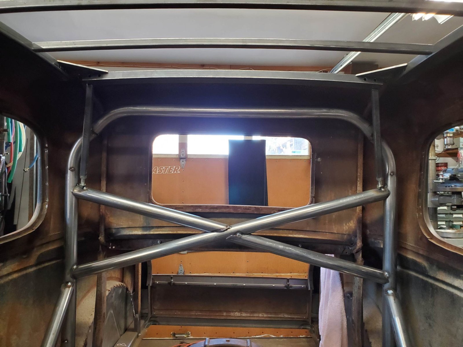

    Nice job!

    One thing to remember is that if you put a rollbar in and it is not up to NHRA specs they may not let you run even if your car is too slow to even need one in the first place. Incorrect installation is more dangerous that no rollbar according to them. Their playground, their rules. That is why drivers walk away from crashes

    In the big scheme of things, I'd say that someone with a roll bar/roll cage set up will be safer a larger percentage of the time if an accident occurs. We can say that some people would not have died if they had not hit their head on a roll bar.....but we have no idea how many people did not die or become seriously injured because they did have a roll bar. I think the percentages for survival/lesser injury are definitely on the side of a roll bar equipped vehicle.
    I'm not trying to discount the danger presented by a head to roll bar contact, but we don't know how many other deaths or injuries would have occurred in the absence of a roll bar............and for some reason, I always thought a roll bar just made a cruzer look more like a bruiser. :)

    The contact area of a 1-5/8" or 1-3/4" tube is far smaller than that of most b-pillars, which in many cases, even as far back as the 1950's, were designed knowing that someone might bounce off of one.
