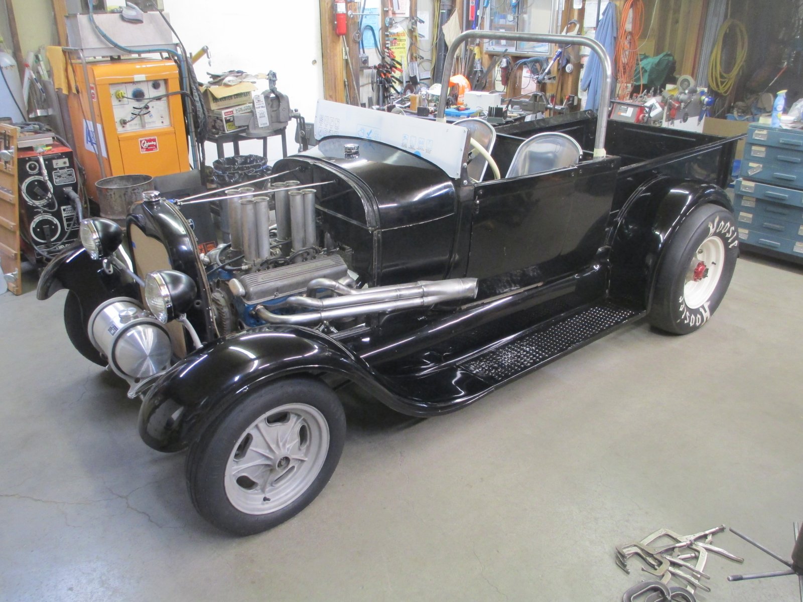

    Not picking on you or your build, but that bar will do nothing in a rollover, except fold like a wet noodle. Maybe you're not finished adding the other bars? It needs rear bracing, and lower bracing of the main bar, hence the "6 points". And to be "legal", being an open car, it needs to have a full cage anyway. Yeah, that really ruins the look, but that's the rules....unless of course it's an unsanctioned event, but even then it will come down to track owner or officials, and they have their own insurance and liability to consider. Not something they usually take lightly unless they want to risk everything.
    As far as padding, same thing. Padding will keep you from saying "Ow" when you boink your head getting in and out, but do nothing in an accident.
    This is not something to take lightly, guys. IF you're going to race your car, and it's fast enough to meet the rule requirements, then you need to take this seriously. I've watched quite a few guys walk away from bad accidents because they took it serious. If they didn't, they would be dead. If you don't, well, make sure your next of kin is taken care of.
    The dangers of a race car on the street are very real, as far as head damage with contact to a bar. And while wearing each point of a 4+ restraint system is a must, you won't be wearing a helmet on the street. What a person can do is add some padded rests on contact points, or use one of the seats shown above, that goes above the shoulder and protects the head. That has it's own drawbacks with visibility, so good mirrors are a must in that situation....and just hope you don't have to reverse.
    Lots of guys saying they've gotten away with this and that for years, and they will....until they don't. It only takes one failed part out of a hundred to send you into a guardrail, or barrel rolling across a field. Then again, if we were smart, we wouldn't spend tens of thousands of dollars just to risk everything. :confused:
    HOTRODPRIMER and gimpyshotrods like this.

    Though I suggested it might qualify for the Street Brawler thread, I've never even considered taking my little fwd hatchback to a track. It just doesn't speak the same EFI, computer-controlled language that is spoken in the local circles. If the A project ever manifests in objective reality, that would be even further from the local norms. So what I've got to say applies purely to a street situation.
    A three-point seat belt with sound mountings to the car's structure saved my *** more than once during my wayward youth. My view is that that is the overwhelming bulk of what you need, and anything you add above and beyond that delivers more or less diminishing returns. I've never owned a car equipped with airbags, and I probably never will. There was a nasty collision in our street last week, where a seat-side airbag deployment probably spared a young woman some serious injuries, so the value is real. But I still believe the "we die like men" trope is stupid and unfair. The absence of airbags doesn't make a car a deathtrap.
    It is possible to calculate the rigidity of a sanctioned roll cage in three axes. It is harder to calculate the rigidity of an original body, but it is likely to be so flimsy that it makes sense to ignore it. It is possible, if you're clever, to add rigidity to an original body so that it is structurally equivalent to a sanctioned roll cage.
    I've heard about factory racing teams submitting FEA on unibodies to argue why their cages are missing members required by rules, in order to save weight. That isn't an option for you and me. I suspect that a lot in rollbar rules is written as it is to make scrutineering possible. A cage hidden between inner and outer body panels can't be inspected — though it might hypothetically be safer.
    Likewise, I suspect that roll bars and cages are required to be made out of round tubing not because it's stronger — square tubing of the same linear weight is either equivalent or stronger in every plane, and a bit weaker only in torsion — but because there is basically one proper way to join round tubes, and that not only limits stress risers to only two very small zones, you can identify it as the proper way just by looking at it. All the wrong ways are immediately visible too. A safety inspector can tell the difference at a glance.
    (Edit: there is of course the issue of bends. Unless you're into the Tesla truck aesthetic you're probably going to want bends in your rollbar or cage. Bending square or rectangular tubing, especially to tighter radii, can result in far greater losses of section modulus in the bent part than with round tubing, unless relatively involved bending methods are used. Good bends can certainly be done, though.)
    But it is certainly possible to design out the much larger zones subject to stress risers with square or rectangular tubing. It requires a bit of cleverness in the detailing. So if having to p*** scrutineering by a race sanctioning body isn't an issue, and you know what you're doing (it isn't magic) engineering the body is certainly an option.
    The advantage of there being rollbar/cage rules is that, if sanctioned rollbars and cages are deemed to be safe, you have figures to work to. It's called heuristics. There is no need to calculate deformation rates under impact or inertia, or any of that seriously tricky stuff. In the same way seat belt tensile ratings are known. If you keep in mind that seat belts can sometimes hold several times their rating in real life, you can at least get an idea of the point where it makes no sense to make things stronger.

    How fast you're going when something bad happens, is why adding above and beyond is important. At lower speeds, it's diminishing returns. At higher speeds, it's necessary.
