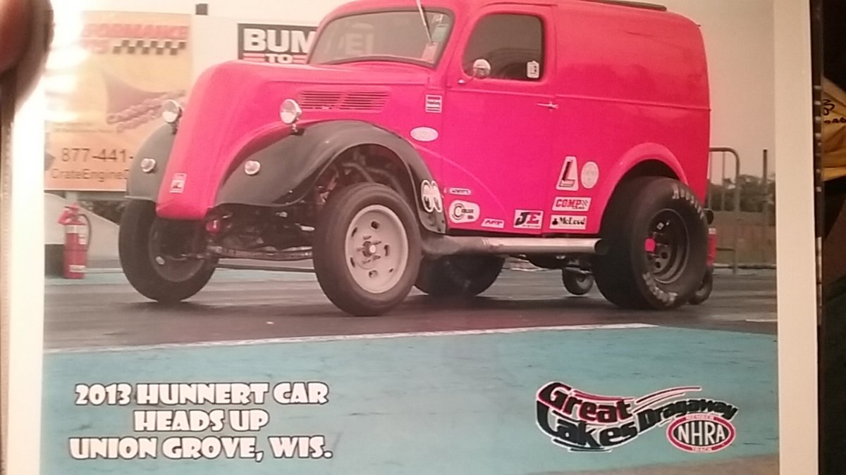

    20221126_151837.jpg When my Dad and I took the Thames to DMV to get a VIN, street legal ***le in a very small town. After all safety checks, DMV Inspector said (75+yr old) ..Y'all built a real nice car. (What ever this is) And I am not going to ride in it for road worthyness portion of test. I will just take your word for it. VIN and ***led.

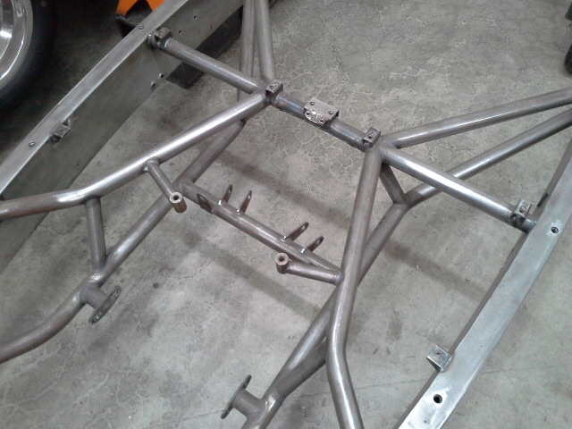

    My best effort.
