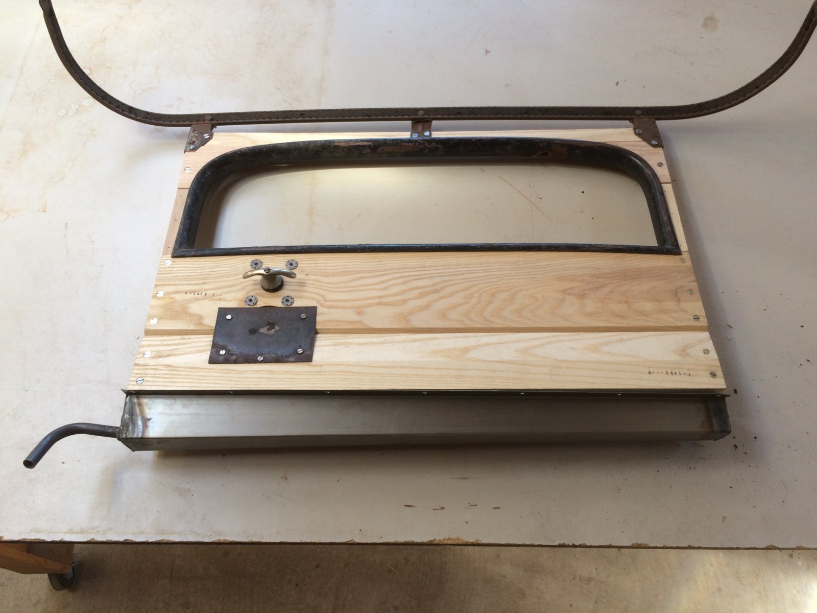

    Here is a picture of the 3 window arrangement with the water catch tray

    Don't be too deterred! If you can catch the water it can be drained off.
    Picture this. Large sheetmetal panel, say 18 gauge, wider than the window and going deep behind the seat, like that pictured, only in steel. Formed into u sections at the sides that also extend up the sides of the window apperture. Theses take the window channel that the glass slides in. Drain collection pan formed at the bottom. A handy sheetie could do this all in one piece, but welded or riveted joins would work. A separate metal sheet or strips then fastened accross to provide mountings for window mechanism. Appropriate tabs to mount to bodywork. Drain outlet from pan to hose through hole in floor.
    Chris
