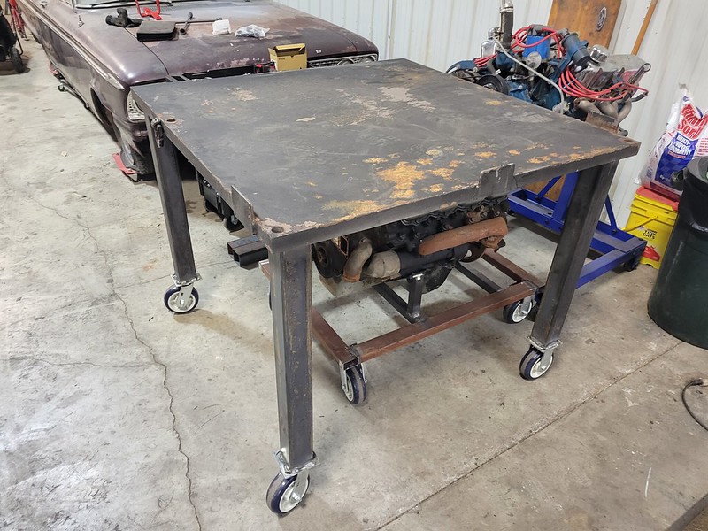

    The bigger the caster wheel, the easier it will roll. That cheap junk from Harbor Fright with tiny 2 inch wheels will get jambed on every little pebble or crack in your floor.
    I build my own. My local Wheeler Metals sells these large urethane casters for $15 ea. They are the same as what is used on Sam's Club's flat bed carts. Couple chunks of square or rectangular tubing, a few minutes in front of the chop saw and welder, and bam! 1 Engine cart. I think I have 5 or 6 of these running around the shop with everything from a 351W to a 1,800 lb IH DT466 sitting on them.

    For bare blocks I use HF 12"x18" furniture dollies. Fits under work table fine. Don't think I could purchase casters alone for cheaper.

    Simple t-shape with a Chevy engine bolt pattern and some inexpensive casters, 2 swivel and 2 fixed. Like others have said, use bigger casters, iron. Roughly 6 to 7 feet of 2x2 tube, 2 pieces of 1/4 inch plate to make the engine block plates

    I have four of those short bolt, tubular on roller stands. One for a 350 Chevy and two for 302 Fords, plus a flathead on them. Mine are from swap meet vendors and were $20-25 at the time of purchase. They’re okay, but larger casters would be nice if you move them frequently. I pushed a fully dressed 350 across a 16’ wide concrete floor in my enclosed lean-to /storage area yesterday, and it took a lot of effort from this old guy.
