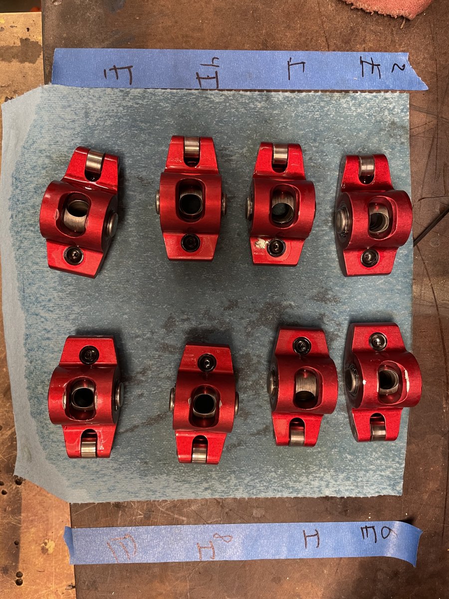

    131628D7-83FB-4250-B28A-57453E4EC7D3.jpeg Pulled the rocker arms off today since there was a little dried RTV hanging out and the bottoms of some of the rockers have some damage. I rebuilt the engine and reused the rockers and I don’t remember this, but that doesn’t mean it wasn’t there before. Any danger in reusing these? If it was a clearance issue I would ***ume I would see it on all the arm. Any ideas?

    I see one rocker with damage by a pushrod that jumped out of place. Should be ok

    It would appear that the rockers are too low and make contact with the mounting stud base.
    Im not sure if a longer pushrod would raise the rocker enough or just move the rubbing to a new location.

    I looked at the picture close, and other than what appears to be some interference scruffs on the inside of the bottom row rockers (and of course the obvious one), I can't see anything that jumps out. Personally I would inspect how far down on the rocker stud the rocker body is going to see if during motion they are touching the stud, and if so, gently clearance the rockers.
    Otherwise, if the trunions are smooth and you cannot feel or hear any grinding when rotated between your fingers, oil them up and reinstall.

    Longer push rods for the bottom damage. Damage on the roller side is from too big of a diameter spring. Need to check at 50% lift for good geometry.

    I agree about the need for longer push rods. Any chance the engine has aftermarket aluminum heads, with a lot of them .100 longer p/r’s are called for. You should check the rocker arm sweep on the valve tips.

    Looks like some of them were hitting the top of the stud towers.

    Adding guide plates will cause that problem if the stud bosses are not milled down a bit.....

    Engine is a SBC with double hump heads. I do have guide plates, and I did check the pushrod length and order custom length pushrods, but I could have messed up, since it was my first time doing it.
    So, since it’s likely the guide plates are pushing up the base of the stud too far, what’s my best (cheapest) solution? It’s not a high RPM engine (144 blower) so I don’t really need the roller rockers, it’s just what was on the engine when I inherited the car.

    If your heads had guide plates from the factory then the base of the studs would not be too high. That could only be a possibility if screw-in studs and guide plates were added to the heads and the stud bosses were not milled enough. Can you give us the casting number on the heads and also the length of the push rods you ordered? Stock SBC p/r’s are 7.800 for a flat tappet cam.

    I used the above method to check for pushrod length and it came out to .200 longer. I did the typical sharpie on the valve stem to check, does this look ok?

    The amount off center could be lived with....its about as far out as I couild let p*** in search of the narrowest sweep pattern....but I don't like how close the top of the keepers and retainer are t the valve tip.
    This set-up really screams for a set of lash caps and the correct keepers to fit them in. Adds a little height to the stem, getting the rocker a little more width on the stem tip to work with and proventing possible contat with ather parts of the retainer/keepers package.

    I noticed that the stud bosses were milled down, but for what "thickness" guide plates?????.......:confused:o_O

    Looks to me that the roller end could be hitting the retainer. Valve stem heights look low to me.
