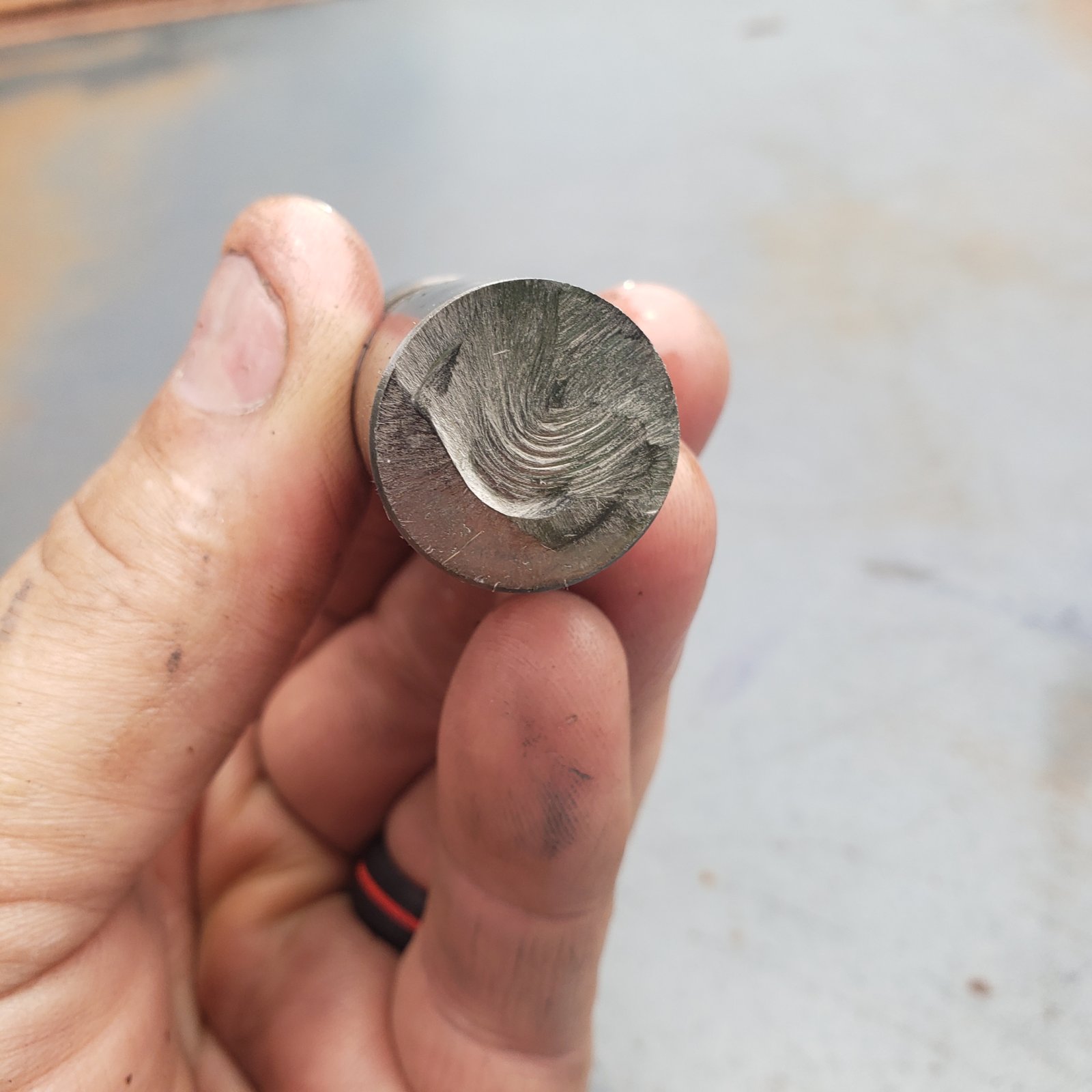

    A couple years ago, during Covid, we had a flat tappet cam failure during break in.
    Chevy BBC, Crane stuff.
    I posted images on here then.
    What we learned was there were 3 manufactures of lifters still made in America.
    Johnson Lifters, High Lift Johnson's and Morel.
    All others are made in Mexico, offshore or with offshore inferior materials.
    One of my customers, Chet Staron, is President and CEO of Top Line Automotive, the owner of High Lift Johnson.
    During the Covid manufacturing shut down in Michigan, High Lift Johnson was backordered over 1 million flat tappet hydraulic units.
    He was able to supply me with 2 sets of Race hydraulic flat tappet lifters.
    The difference between a stock lifter was bleed down rate, higher Rockwell hardness, snap ring retainer instead of wire ring a**** other stuff.
    I have since then used both sets, without issue.
    Not 100% sure, but the way I understood it was Top Line moved a bunch of manufacturing equipment to a new facility in Florida from Michigan. During the move over 1 Million dollars of equipment never made it to Florida.
    It is rumored/alleged that the people involved had something to do with Johnson Lifters, also from Michigan. One person was convicted and went to prison. He and other employees were former employees of High lift Johnson.
    Those would be the only flat tappet lifter manufactures, I would use.

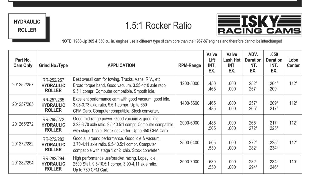

    How about some of the custom cam grinders, do they offer flat tappet cams, what are they offering or suggesting for lifters?
    Deuces and 427 sleeper like this.
  27. Dan Hay
    Joined: Mar 16, 2007
    Posts: 6,473
    Dan Hay
    Isky options. The part that’s cut off at the top says SBC 1955-1987, so retrofit.
