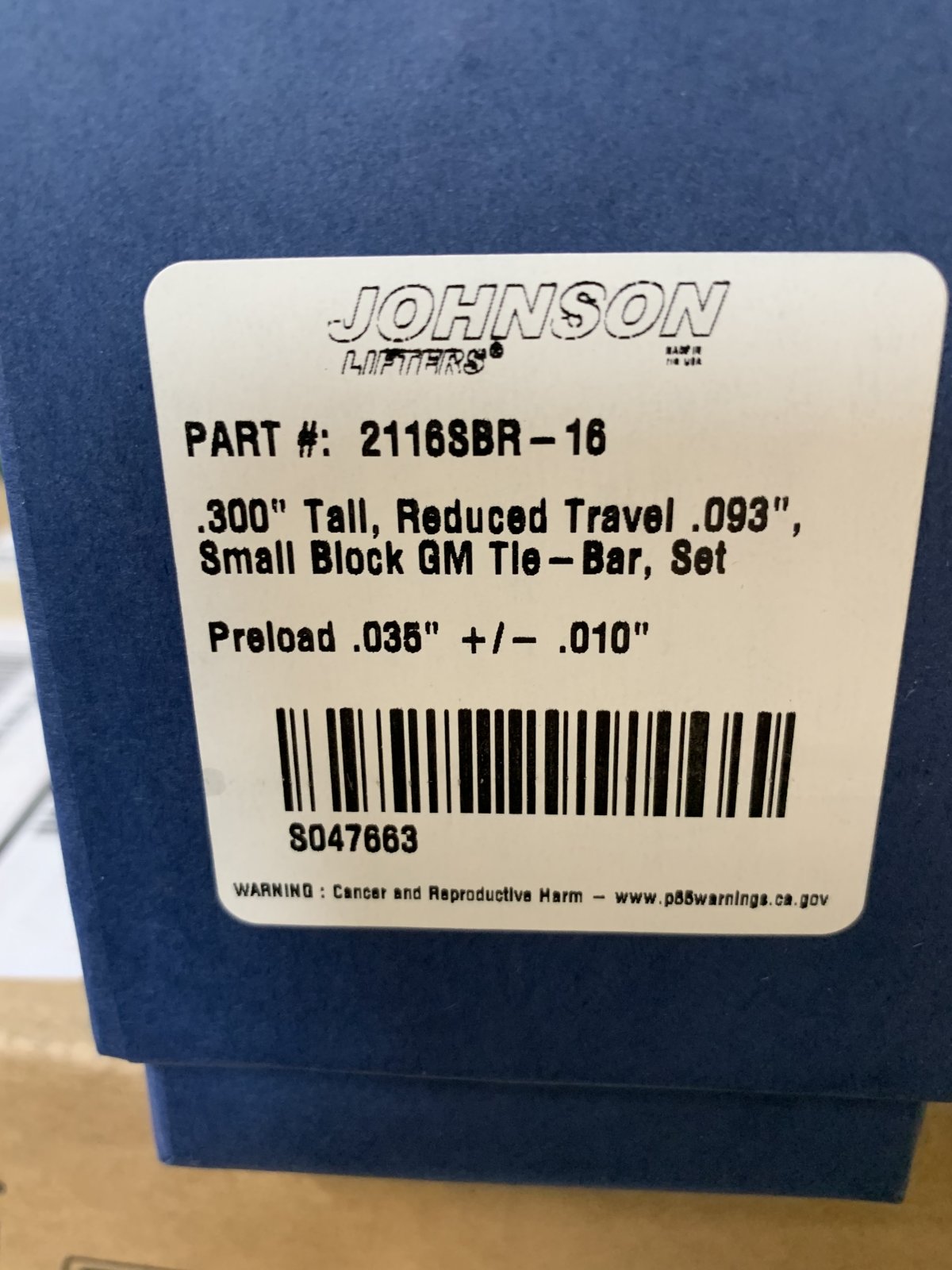

    I wish you the best with this kit. I ordered my Johnson lifters from bullet racing cams. They call them reduced travel lifters, but talked to a tech at Johnson and he said they call it reduced travel because the body is longer than a stock lifter. They were around $725 shipped and are the best I’ve read about. IMG_1289.jpeg

    When I called and talked to the tech I told him the exact same thing. They said to get this one even though it’s good for 7500 rpm. I then spent time trying to get a laymen’s term of what .035 is in turns of the nut after zero lash. Only the guy at Johnson answered me with 3 1/4 turns. Other said to use a feeler gauge or a dial indicator. I asked how would I do this with the engine running. Been a long journey for sure. I have read a lot of bad things about comp lifters made by morel. They either collapse or are noisy. Also read some post of the comp cam breaking in two. Hope it works out for you.
