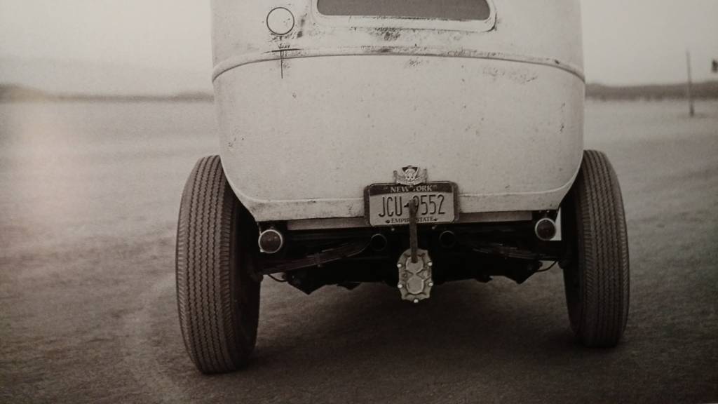

    Been reading their books....QC Ford V8 rear end is what it says....what you will see if you race Judy IMG_20200330_163344277.jpeg

    So-o-o.....how did the rearend in the sedan become so narrow? Has it been genetically modified? Depending on wheel backspace the rearend under the sedan isn't anything more than 54" to 56" at the wheel mount surface, is it? The narrowest stock banjo I know of is a Model A at about 58" or 58 1/2".

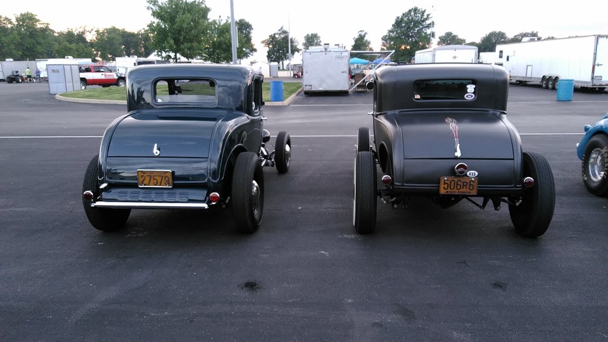

    Yeah Like @A ***** said 1932 1933 1934 bells with stock 16 inch rims most likely 16x4.5 and a few examples of beautiful cars with a similar look BF481DF9-25C6-4C82-ADAC-85B2D26D0BB5.jpeg 6336F0F9-9947-45E9-BEBC-9445B8EF8E5A.jpeg

    Interesting comparison of the two cars viewed from the rear. Seems quite a difference of tire to wheel well clearance on the two. Do you know specifics on the rearends and/or wheels used? I'm not as well versed as others, but the car on the left is a '32, correct? Are they a bit wider than the Model A on the right? I'm going to do some searching now to try to answer my own question.:confused:

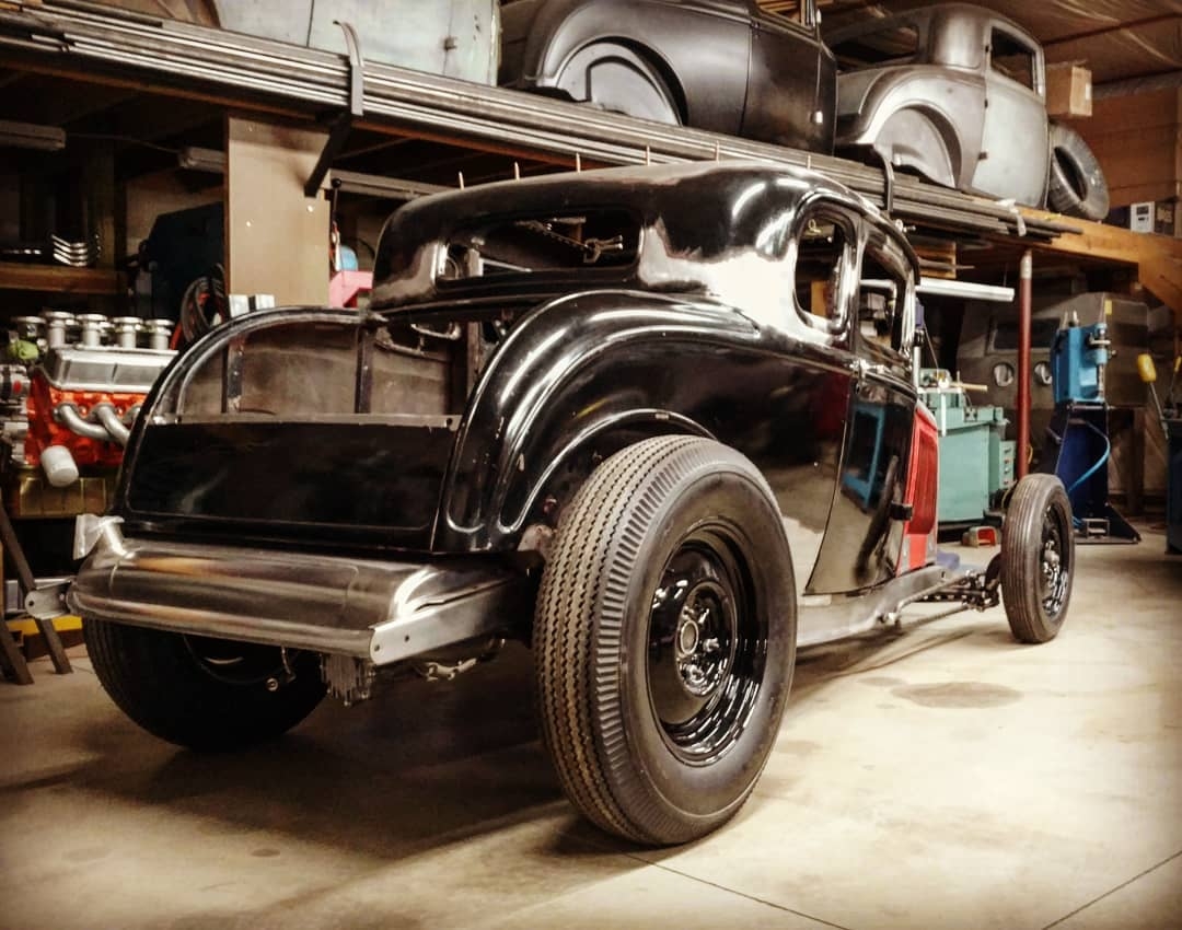

    Lynn, in the under-construction black coupe there is a new Winters V8 style rearend. Those can be ordered brand new ***embled in any width you want. It's being built by Steadfast and he really likes to tuck the wheels in tight. A very clean look I think.
    The two coupes facing away show a 32 on the left and 31 on the right. If the 32 has an old Ford banjo rear it's probably an early one, at least 36 or before. Usually a 37-40 or 41-48 rear sticks the wheels out more than that.
    continentaljohn and lake_harley like this.

    I have a 57 inch width Winters rear under my 32 pu with 16X6 inch wheels with the center at neutral and 750/16 tires and have 1 inch of clearance between the side walls and the box on each side. I have a 56 inch Winters rear in my deuce roadster with So-Cal 6 inch knockoff wheels and 750/16 tires and have an inch of clearance there also.
