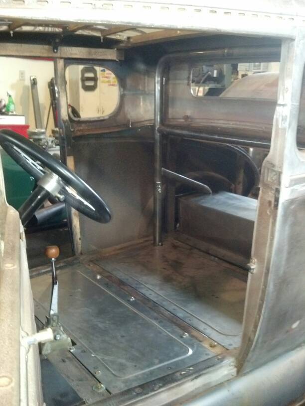

    I've put cages in many of my street-driven cars. Here's a shot of one in my truck during fabrication. The A-pillar bars haven't been shaped yet in this shot. I do my best to keep the cage tight to the inside surfaces of the cabin to gain maximum clearance, and I foam-pad the cage in appropriate places. No issues. Never had an issue with insurance either. A cage doesnt magically turn a street car into a race car. It doesn't make it faster, but it makes it safer.

    VoodooTwin: I'm curious about your theory behind the S-shaped tube across the door. A straight pipe is quite stiff and for example pushing the centre in towards the seat would require the front and rear tube to be pulled toward each other. A S-shaped one has little stability left and the centre could easily be pushed in while the S straightens out w/o the front and rear tube trying to resist it.

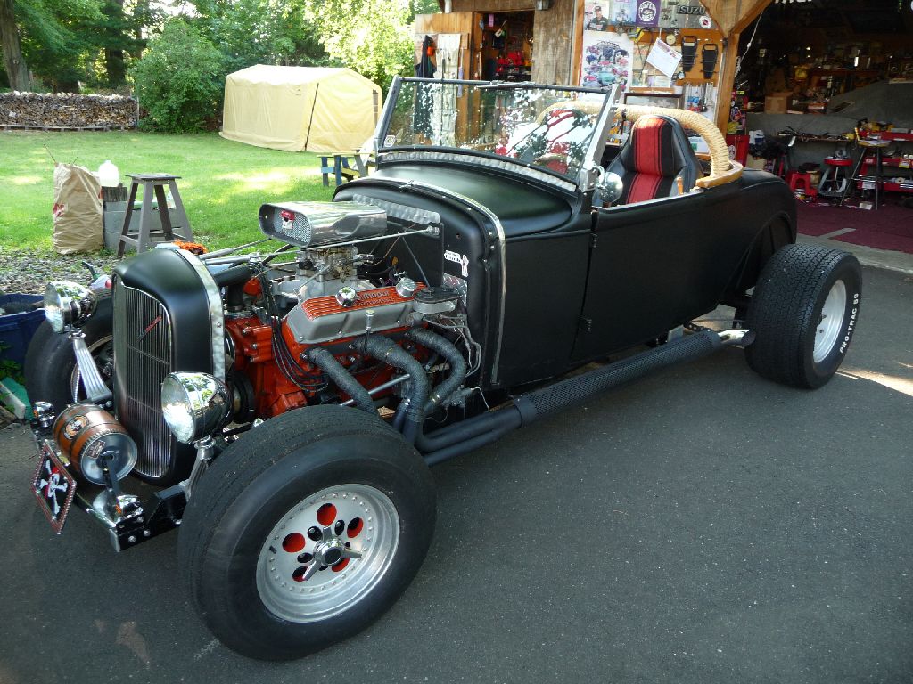

    I will be putting a single hoop with braces "Roll bar" behind the body of my T roadster. I like the look if done right...BUT my biggest reason for doing it isn't for rollover safety.
    I consider it more to prevent getting driven over by a higher vehicle in a minor rearend collision.
    Yes, there comes a point where it won't help in that type accident, but at least it gives you a chance, rather than simply having your face smashed into the steering wheel by a soccermom's SUV! :eek:

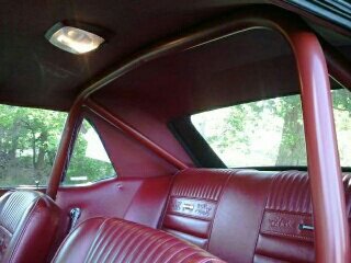

  29. scootrz1
    Joined: Apr 16, 2011
    Posts: 269
    scootrz1
    from usa
    Same bar different seats now
